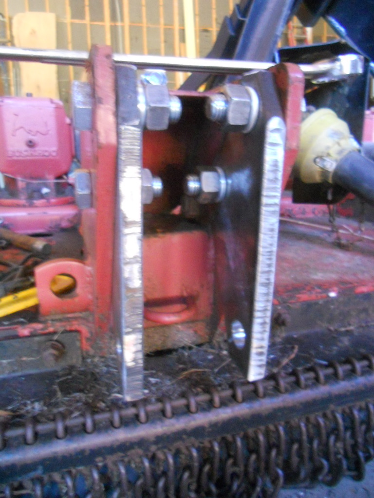

I use a Mag Drill for most large holes.
Bingo! Their available down around $600 now, well worth it even only for a couple of projects a year. Properly used the cutters last a long time. I drilled 8-1" holes and 4-1 1/8" holes all in 3/4" plate in about 20 minutes for this mower mod.
