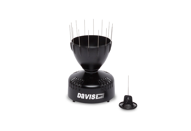

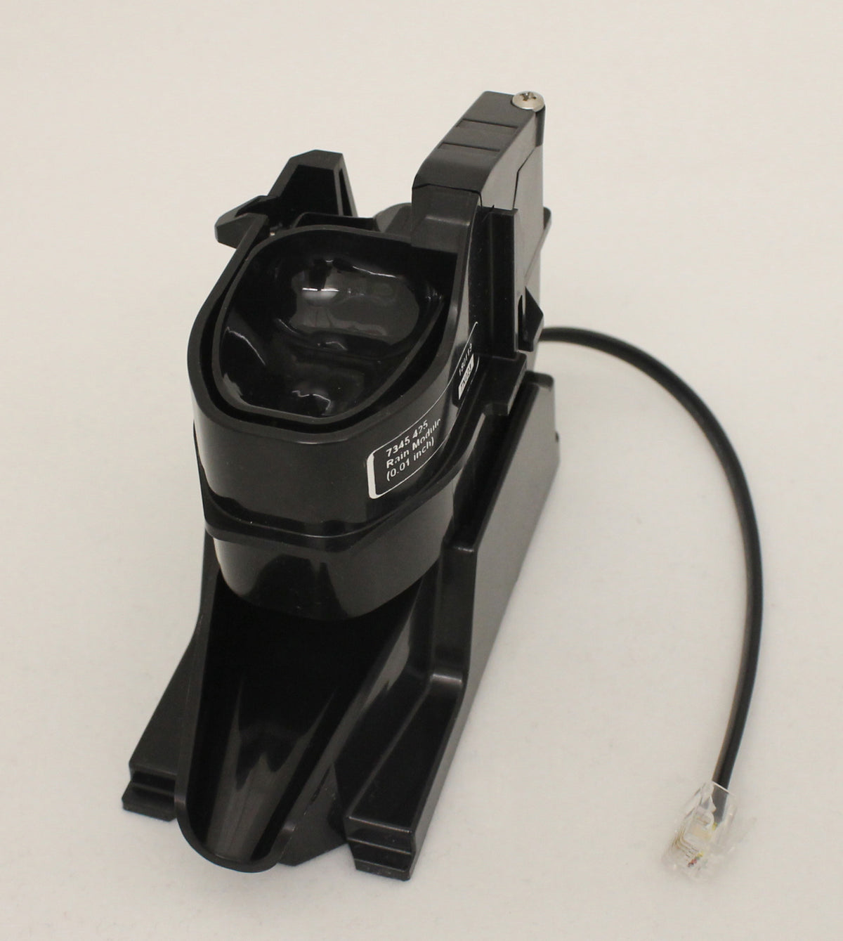

If you haven't already done so, there are two upgrades that improve the accuracy of the Davis rain gauge:
and
I use both and it did indeed improve the accuracy, compared to an analog gauge. Still not exact, but very close.
