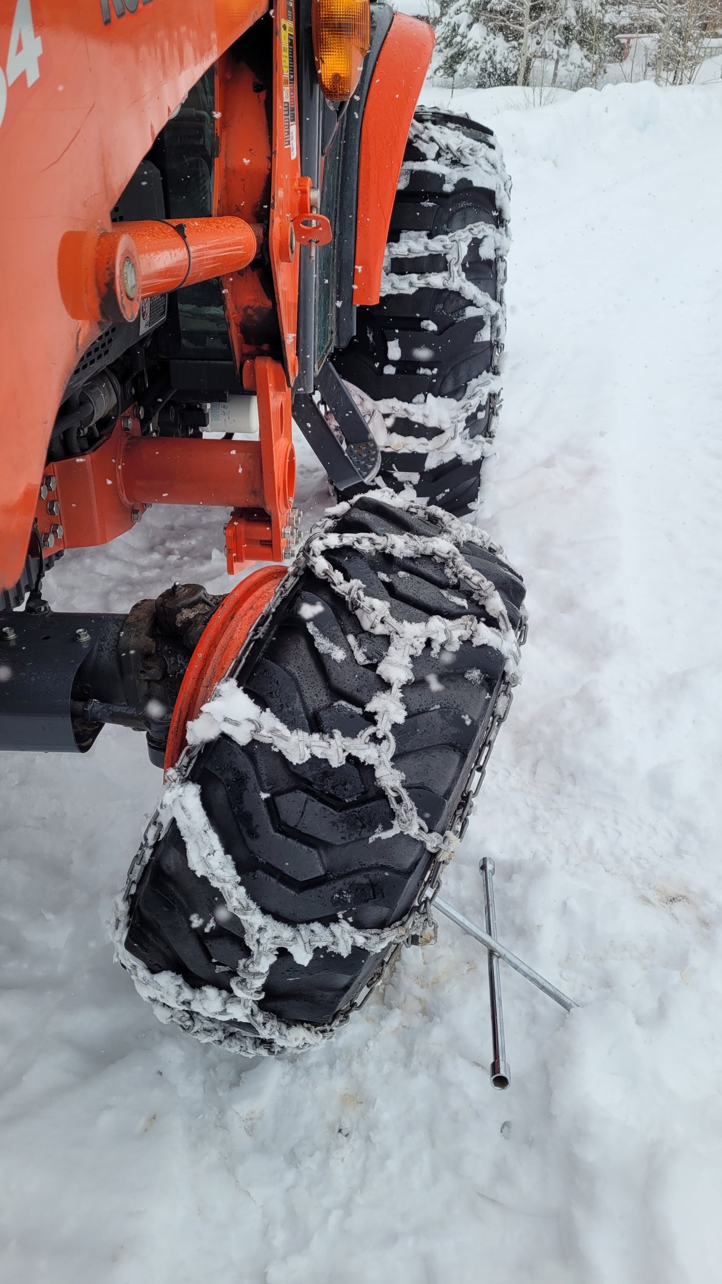

I have a 12 year old L5740 running the original R4's. I just got a flat on a front tire while plowing snow, and the tire came off the rim while I was moving up to a spot where I could park without blocking my own access. This tire has 2 patches already and I'm guessing one failed. I am going to replace this tire, and will do the other front now as well so they match. Ever since thie R14's came out I thought they looked like a good option for me. Any reason other than the higher cost not to change over the fronts while leaving the R4's on the rear? The diameter of a new R14 is only about 0.1" larger than a typical R4 in 10x16.5, I think. Is anyone running R14 Front and R4 rear? If so how do you like it?

A few comments: 1) The small diameter difference in tires you mention is negligible. Don't worry about that part. I assume you know it is rolling radius that matters, not apparent radius/diameter. Still probably plenty close enough to be negligible. 2) Your existing tires do not look bad tread-wise. I would pull the tire (better yet take the whole rig -- i.e. 2 wheels and two tires still mounted to your best local tire shop) with the objective of finding out the real condition of the tire(s) first and second why not put tubes in them?? 3) I just do not hear anything so far that gives you a reason to go changing tires. Seems like considerable cash to acquire questionable, if any, improvement in operation.

I'd actually like to have R14 tires on my tractor. They're supposed to be the compromise tire that offers better performance and traction and ride. I wouldn't hesitate to install them on the front only.
However, I'd only do that if I had to replace my front tires and I could buy them for a comparable price. Your tires look good. If here, I'd take the wheel off and take it to the local Ag COOP where they have a tire shop that does all kinds of tractor, implement, and truck tires. If those guys can patch it or put a tube in it it's a cheap fix. If they can't, they'll tell you right up front. Just guessing, but I'd say front R14 tires would probably cost $600 or so. (Is that close?) Lots of tread left. If it will hold a tube, you could fix it for $50.

I see no issue with putting R14's on the fronts with R4's still on the rear. The tractor doesn't care what the tread pattern is as long as the loaded radius is correct.

A guy at the tire shop determined that the reason that tire loses air is that there is a rough area (likely damage from one of the earlier flat episodes) on the tire bead. He put 80 psi in it and there was no leak when submerged. But these tires are 6 ply and only rated at 45 psi so we dropped it to 45. Although the L5740 manual specifies only 20 psi for R4 on the front, I've been running at close to 30. One day after getting home that tire was at 38psi. My shop floor is probably colder than the tire shop right now, so that may be some of the loss. I inflated back to 45 just to see what happens. Will check it in a couple of days. Meanwhile, just to clarify, my R4 fronts don't look great close up. There are chunks missing due to running tire chains or from sharp rocks, and the edges are so round that they're even worse on slick surfaces than ever. That's why I can see spending money. No intention of replacing the rears until they need it. The difference of R4 and R14 for the front is about $50 per tire. Not that big of a deal.

Go for it. I wouldn't be concerned about changing the tread pattern if you're going to replace the tires anyway. And I'd pay the difference for R14 too.
Seems like running your tires at 45 PSI when max inflation is supposed to be 20 PSI would cause it to really ride hard and bounce. Also seems like that additional inflation would help your chains chew the tires up since they're much less flexible when over-inflated to that extent. Mine rides hard enough as it is. Just saying . . .

Yep. I don't know how long I'll last, but if the bead isn't compressed well and it leaks at 40 psi this will be a short experiment .
   / L5740 Changing R4 to R14 on front only? #16
Or break the bead lose again and coat it with bead sealer and reseat, could go for a few more years then.

The tire guy determined that the wheel has a rough spot -- right? That's pretty common.
They usually use an air powered brush to buff those areas smooth when mounting or repairing tires. Did he smooth it out? Or was his solution to just put 80 PSI in the tire?
Like Lou said, bead sealer or smoothing up the rough spot are both options . . .
