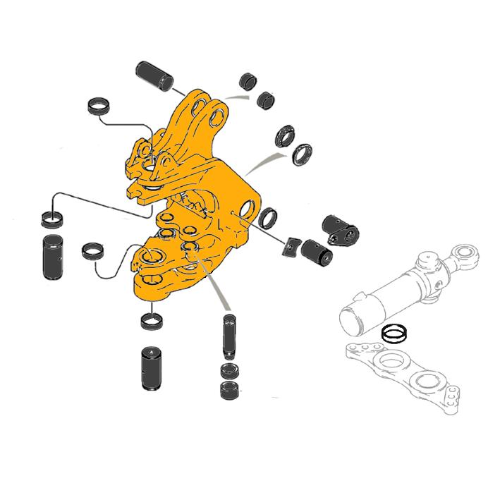

After 15 years of having a little Kubota BX, I recently got a second backhoe, a Case 580 Super L. My assumption or hope is that there exists a pin of some sorts that can be dropped into the backhoe in its parked position to lock it in place, preventing any sideways drift. On my little Kubota, it's just a brass pin with a handle that you manually pull out and park in a little slot on the frame. If a similar item exists for this Case backhoe, the previous owner did not have it. What's a good go-to place to seek out such a part? I'm not sure what it'd be called.

I guess the first thing is to find out whether the slop is in the hydraulics or in the swing frame pins and bushings. My bet is bushings. The 580 is even more user friendly than the 310, and all of its pins in the swing mechanism have bushings - even the main pivot. Bushing slop? Or hydraulics?
Here's a picture of that 580 swing assembly from a parts place online.

Turns out there is a boom swing lock pin that I found inside the cab after removing the crap the previous owner had. Some good info in this thread though that I can use to understand things beyond just using a pin to mask the fundamental problem.
