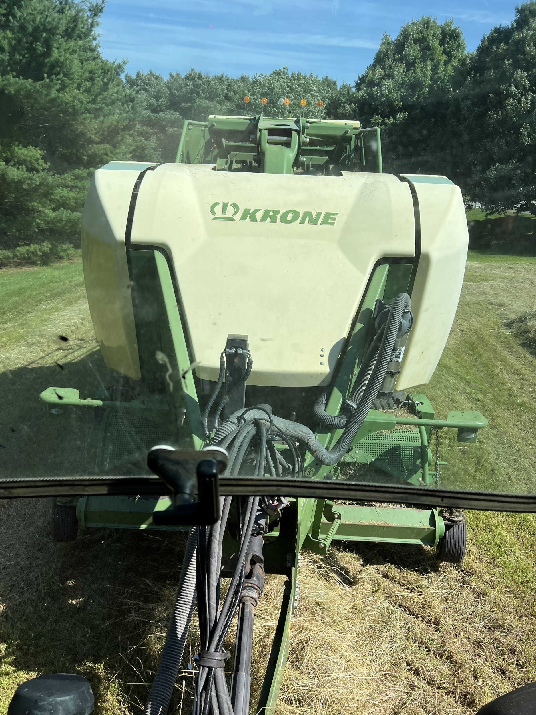

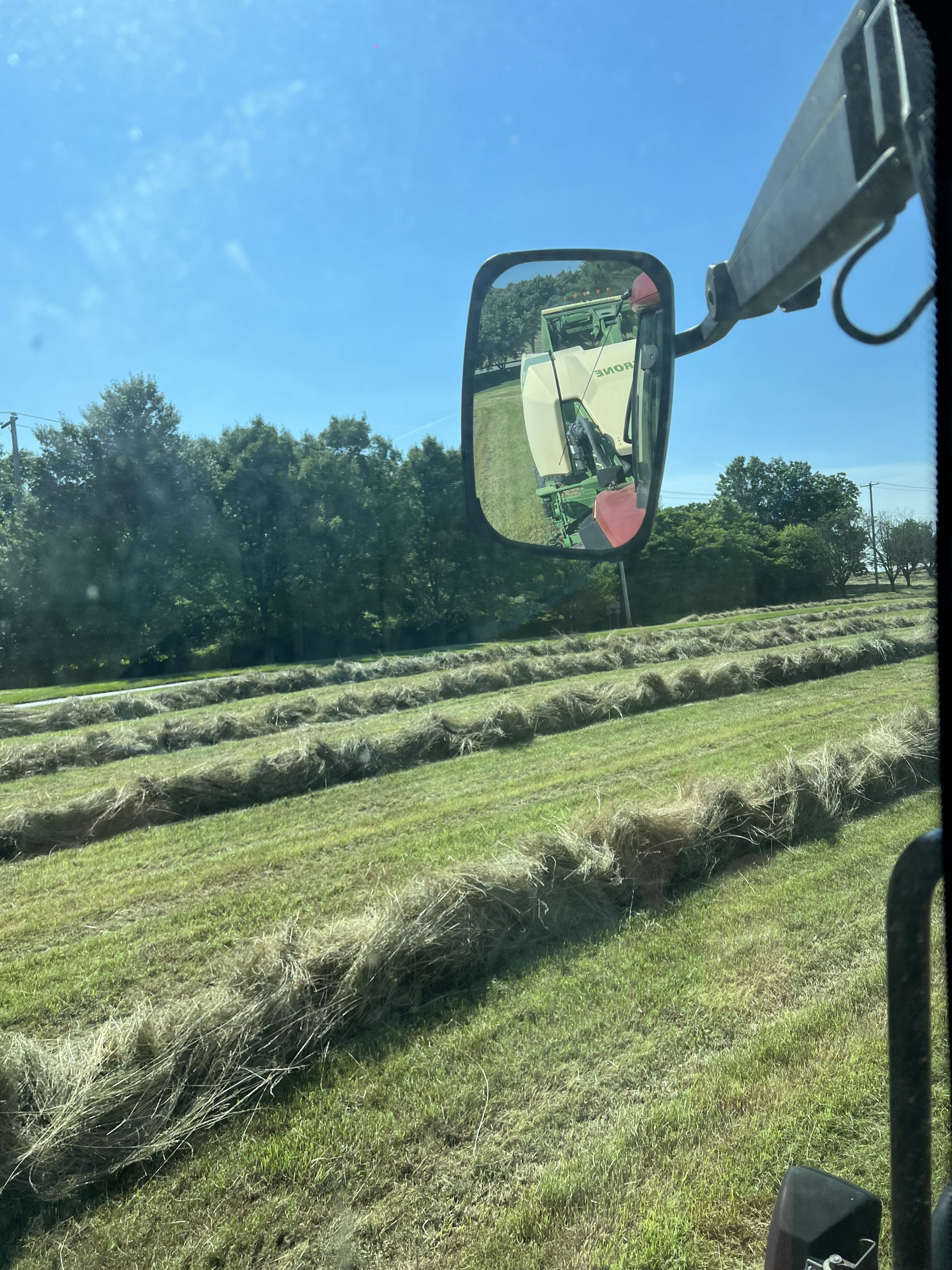

Its a little past it’s prime, but I was able to crank out about 30 pretty little bales today. I used the Krone Big Pack and set the monitor to make 60” x4’ x4’ bales. Turned out great. I haven’t had the chance to use this feature yet and it works amazingly well.
These bales will be perfect for my locals raising beef.
Monitor set at 60”. The blue number can be touched and a menu pops up to change bale length. It’ll make up to a 120” long bale.
