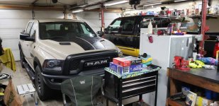

I currently have the one that you tap one seal at a time in with. 20181231_130806.jpeg20181231_130841.jpeg
