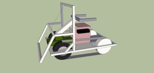

I have this idea to make an 'attachment' to turn my two wheeled tractor into a mini tracked front end loader. Using 12v winches to operate the front end loader, and gas struts to hold the bucket down when picking up dirt etc (when the winch lifts it overrides the gas struts). And making the tracks out of strips of conveyor belt bolt to chain like thishttps://www.google.com.au/imgres?imgurl=http://www.rubbertirechains.com/images/astapics%252520003.png&imgrefurl=http://www.rubbertirechains.com/what_are_rubber_tire_chains.html&h=200&w=200&tbnid=4htQywhRyiVxpM:&docid=mlqjnUXxfuoD3M&ei=OUFxVtL-Dcma0gTRhr-YBw&tbm=isch&ved=0ahUKEwiS_-2LmuDJAhVJjZQKHVHDD3MQMwgeKAIwAg
So it would look something like this (btw it's only a very quick drawing)
What do you think? ideas? suggestions? reasons why it's a totally stupid idea?

Sounds like fun. Not sure how useful it can be. One thing I'd consider is cutting segments from old tires rather than conveyor belt. They would already have the curve and I'd bet they would be more durable. I used pieces of tire for things and used a composite metal-cutting blade in a circular saw.
/ Walking Dozer? #3
Sounds fun but my worries would focus on-
1. Hope will you turn/steer the rig?
2. Will the tractor hold up to the abuse?

I have tried cutting tire before with not much success, is the blade your talking about like a carbide tipped blade? I think 3/4in conveyor would last a decent while.
1. Steering brakes.
2. Abuse in what way?

If your 2 wheeled tractor has a solid axle steering brakes would not work.
/ Walking Dozer?
It has a diff.
I just looked at the tractor and I am going to have to make axle extensions so the tracks will clear the engine.

My second tractor was a two wheeler, my first had pedals. On the two wheeler, I used to remove all but two shanks from the cultivator and replace the sweeps with a short section of grader blade. As I remember, it moved precious little dirt because the blade was behind the wheels and pressing down on the handles to make it penetrate, tended to lift the wheels. They used to make dozer attachments for two wheelers and I've often wondered how well they worked. If I were you, I'd probably trade the two wheeler for a rider so your weight will be above the wheels and give better traction. Sorry to be discouraging but even my MF 261 won't dig very well with the bucket. One day, I might add a weight box and tooth bar and hope for the best. Good luck.:)

I have a homemade blade for the tractor already. What I was going to do is add a second set of wheels and run tracks between them. The purpose is not so much as a dozer just a 'ride on' machine with a front end loader (for lifting things and loading loose material) and maybe build a dozer blade for it eventually.

When I read the original post, I thought, if you weight about 6,000 pounds and you are going to mount an engine that can move you and the dirt in front of the plow, it might be worth it, otherwise, use a shovel and a rake.
