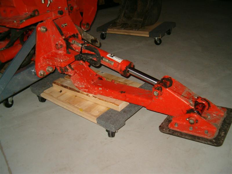

The standard pad on these Kioti hoes is never bigf enough. Michigan Iron is very handy with iron and makes all kinds of stuff. I had him make me up a set of plain flat stabilizer feet as opposed to something like a bear claw. Tkhe reason is I seem to do quite a bit of digging from black top or cement drives including nice lawns. The flat ones like mine on my CK2510 and 2465 backhoe combo don't seem to do the damage but are still very effective. They are also very reasonable in price.

Define reasonable price.
How 'bout some pics of your pads?

This is the best thiat I can do for now. It's been a few years but it seems like I paid around $75-80 bucks for these custom made flat iron pads
