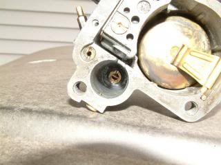

:D:dance1::cool2:WOO-HOO!! I finally got this stubborn BOS (dyslexia) out!! I tried PB Blkaster for 2 days, diesel fuel before that. I tried Nitrolube. I still think they're all snake oils, but who knows. Tried heating it up with propane (didn't want to try oxy/acetelyne). NOPE.. none of them did the trick. I knew I couldn't drill from bottom and push it out because there is a check valve in bottom.

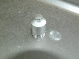

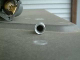

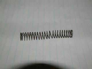

so I used a lefthand easy out, the one that looks like a drill bit. First I drilled the recommneded hole size (7/64th for a #2 LH easyout). I drilled through the top of the piston. It i s soft aluminum and drills easy. Then I put in the LH easyout, used a cresent wrench to turn it and it spun, then pulled out. I used wire wheel on my bench grinder to clean up piston and a deep socket with emery cloth to try and clean cylinder area on the float bowl. I also cleaned the spring on the wire wheel.
I used a 2 part gas tank repair compound to patch the hole I drilled in the piston. First I cleaned it good with brake cleaner, as brake cleaner leaves no residue. You rub it together until it turns grey, then put it on top. I would have used JB weld if I had any, but this is what I had handy.
here is the spring cleaned up:
here is the cylinder cleaned up. I tried to remove check valve at bottom but it felt like it'd strip so I stopped. I blew air through it and used carb cleaner:
here are 2 pics of the piston cleaned up:
