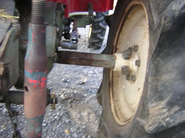

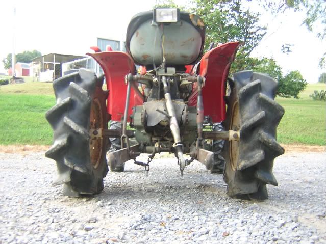

I've got a 1401D that I use to bush hog the back 40 with. The terrain is really steep and scary. I haven't turned it over yet (knock on wood), but I'm constantly thinking of ways to make it safer. While doing some brake repair, I thought of this...turning the hubs in and mounting the wheels on the inside of the hubs. I got about 6" wider track width this way, but am concerned that when I load it up with the bush hog that I might break the rear end.
Anybody else ever try this? :

I switched them from side to side, but also turned the hubs around on the shafts so the wheel bolts to the inside of the flange. The offset in the pin hole in the hub allows an even wider track than just switching the wheels from side to side.

I have my YM186D set up that way, and for the same reason: maximum width for side slopes.
I asked a dealer who used to import Yanmars and he said he had never heard of a problem doing this.

Yes, my rear wheels are set to maximum, with the bolts (pins) through the outermost hole.
I have never turned the fronts out on anything. The principle here is that the front rim is centered between the inner and outer wheel bearing, and turning the front wheels out doubles the stress on the outer wheel bearing which is a safety hazard -especially on side slopes.
I have four 60 lb weights on the front bumper and it's still real light with an implement on the back.

Ok, I put the front wheels back on the normal way and I have the rear hubs turned around, in the second hole in the axle which puts the outside of the hub almost flush with the end of the axle and the rear rims are turned around for maximum width mounted to the inside of the hub flange. I probably moved each rear wheel out about 6" so I've increased the rear width probably 1 ft..
I went out and bush hogged the areas I normally had many close calls on...I did it a lot faster than I could in the past and it was much more comfortable to drive. Turning the front wheels back to original made a HUGE improvement on steering...much less effort than with the wheels turned out and, with the rear wheels spaced out, the fronts didn't seem to matter at all when on a steep hill side.
I cut across slopes I was scared to turn around on before without any drama at all.
The tractor handles hills way better than before and putting the front wheels back, although it looks funny having them so narrow when the rear is so wide, made steering effort low enough that I mowed for about 4 hours tonight and I'm not even tired.
I love my tractor again...Thanks everyone for their input and California for confirming that my hair brained scheme had already been realized.

For the real fanatics: I have thought about taking the hubs to a machine shop to have the other face machined smooth, so the wheels could be mounted outboard of the (reversed) hubs. This would give another couple of inches of rear width.
(You probably have to look at the hub photos in post #1 and 4 above for this to make sense).
This would leave the wheel supported entirely on the lug bolts, instead of having the hole in the center of the wheel fitting snugly on that shoulder machined on the correct side of the hub.
Has anyone ever mounted the rear wheels that way?
/ 1401D hubs turned in...ill advised?
#20
If you're having them turn it anyway, have them leave a .040" shoulder to the diameter of the normal shoulder. Shouldn't weaken the hub enough to matter...after all compare the rim thickness to the hub thickness. The rim should break first. I'd be leary of cutting the weld off the outside of the Hub anyway...might make what's left of the weld crack.
I'm just wondering how much more cantilevering the rear axle can handle especially with a heavy load on the back...
You'd have to flip the picture over for it to apply directly.
