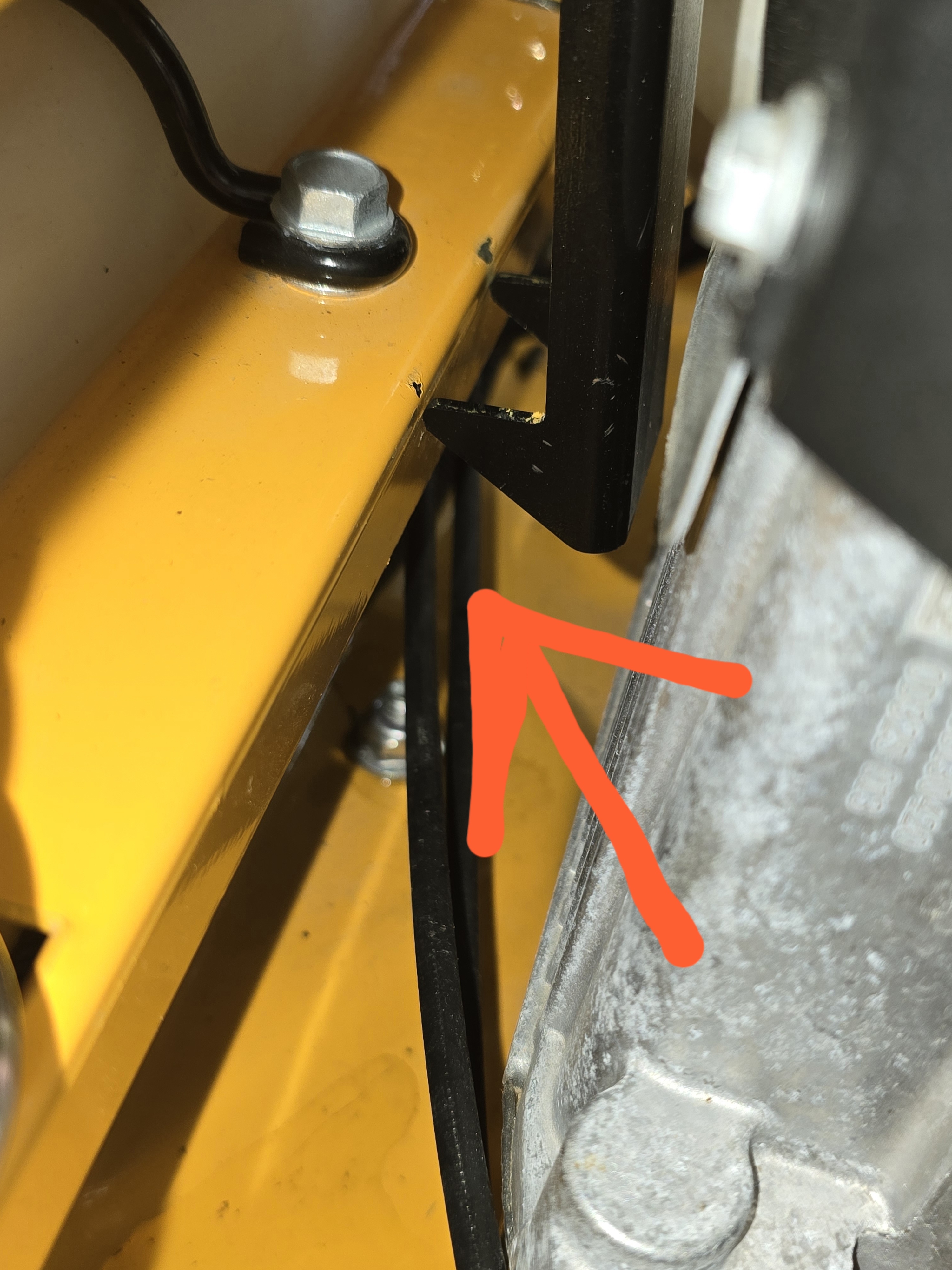

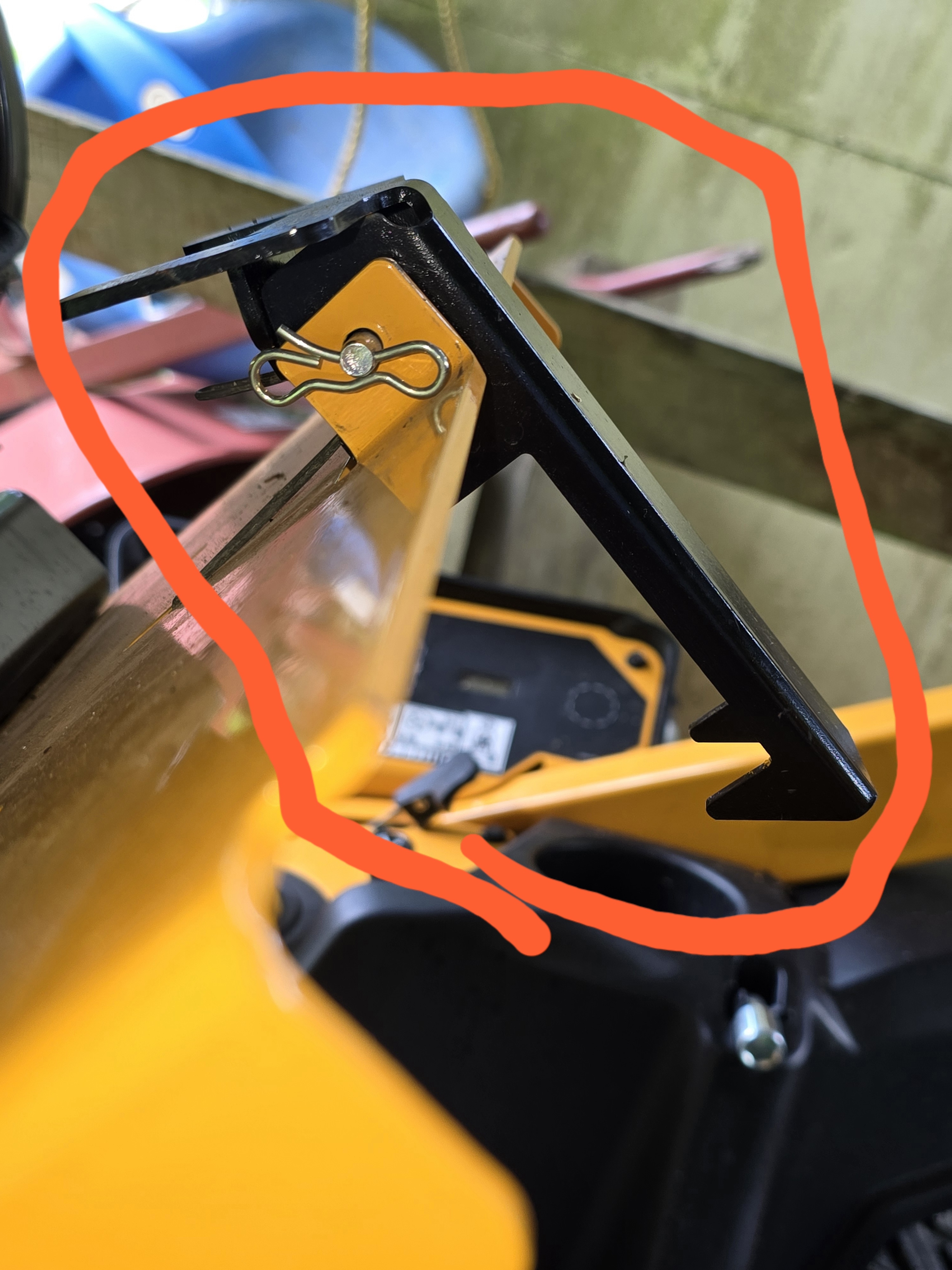

There is a clampy-type thing that latches on the back of the seat, and you normally have to move the lever to release the clamp and allow the seat to lift. I will get a picture later when I get off work.
   / ZTXS4 48 Seat "Springs" Replacement
Here is the picture of the clampy thing and the latch. Sorry for the bad pictures. That latch hits just above the bracket behind the gas tank, shown in the last picture.
Picture two
#9
Picture three
