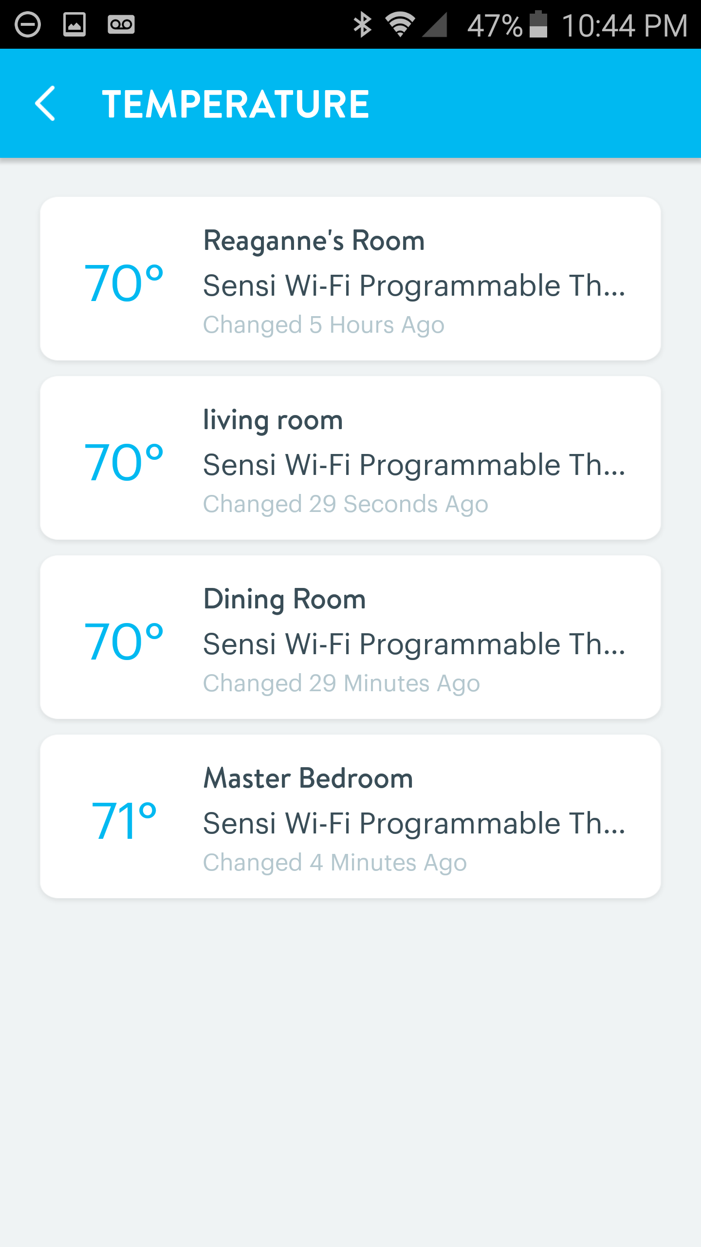

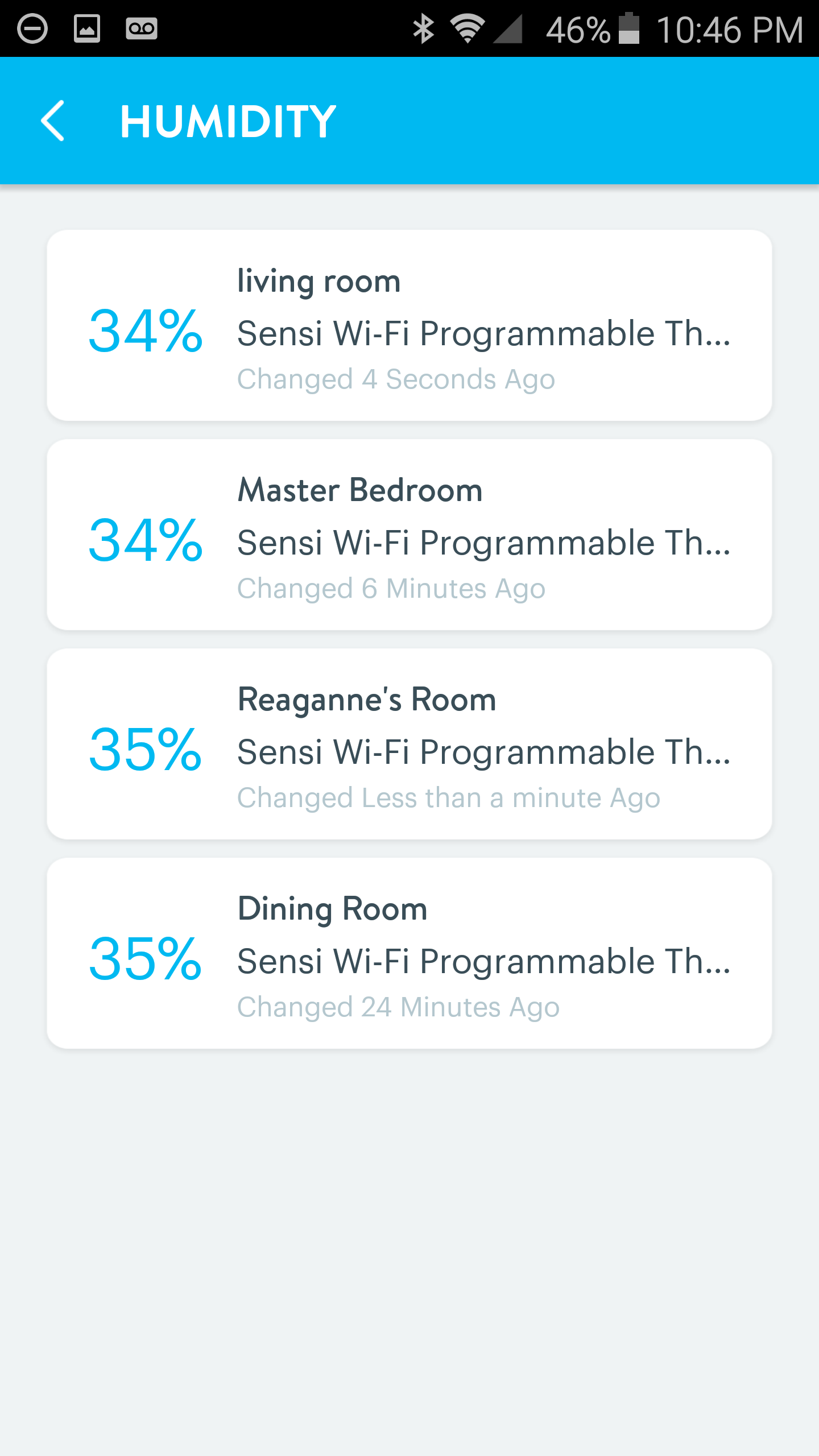

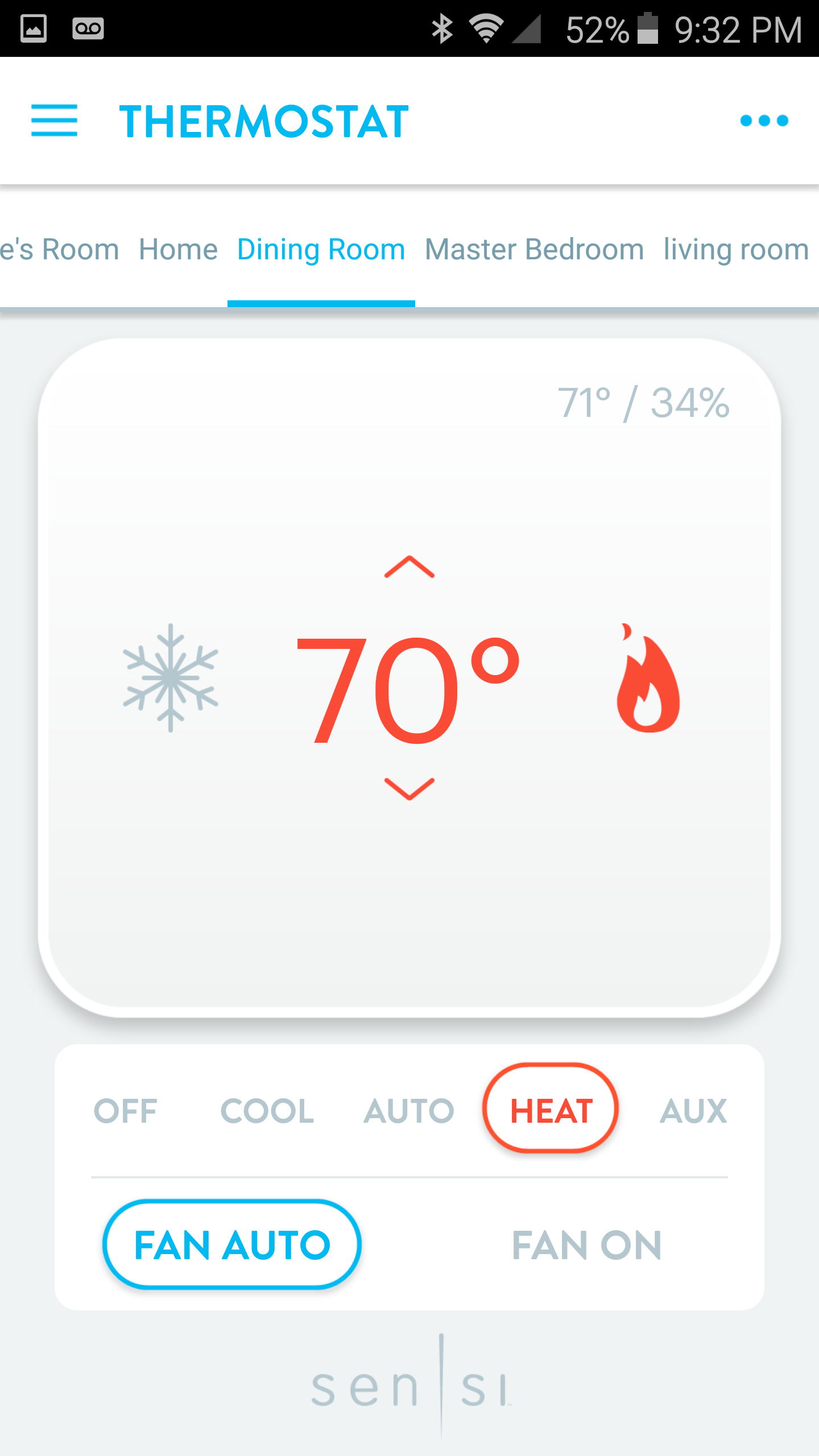

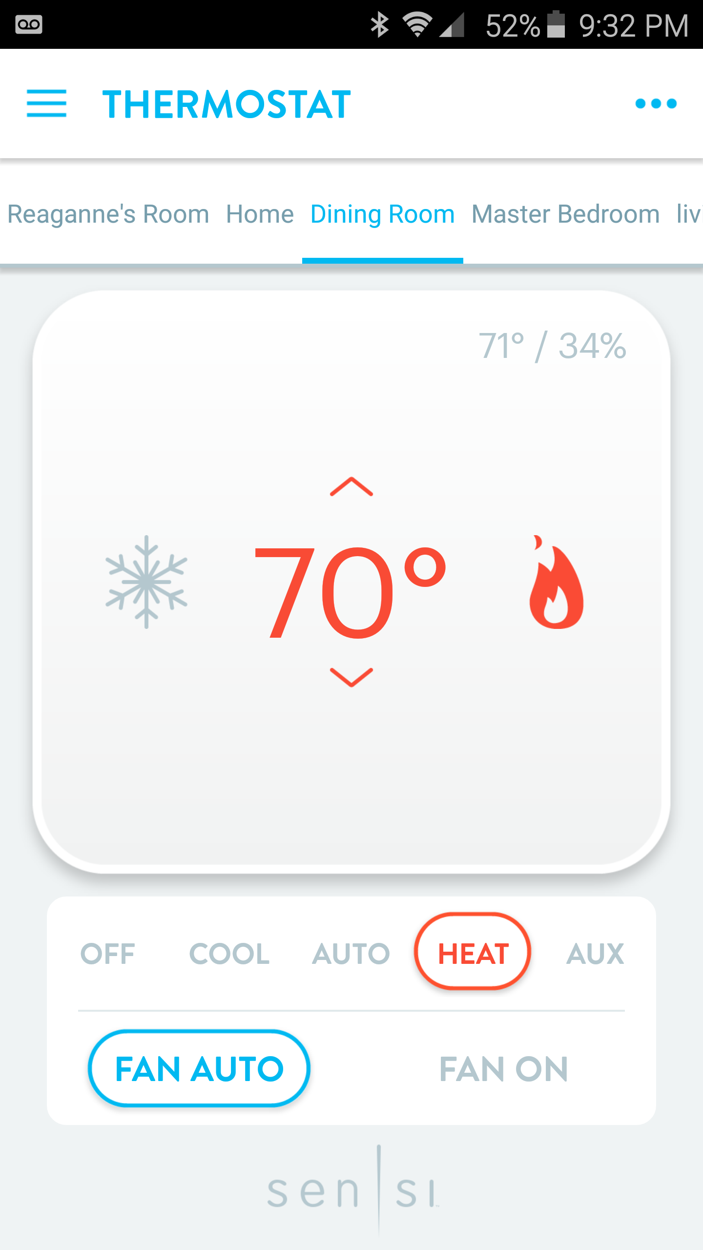

#14
They were not cheap but I finally found what I was after and really like them. Ended up with Sensi Wifi Thermostats. They have a sensi app that is ok but these things really come into their own when paired with the wink phone app. With wink you can control tstats individually or set up any number of grouped tstats to control as one unit. Add in their "robot" builds and you can do some pretty neat stuff.
Using wink I can now turn all tstats on or off with the push of 1 button. I can scroll through individual t-stats and adjust if needed. It really gets nice when building "robots" in the app.
Here's a couple of examples.
Fan Circulation Robot - When we run the fireplace it tends to get much warmer upstairs for obvious reason. I programmed a bot for heat detection. If the upstairs t-stat temperature rises above 73 degrees it turns turns the furnace fans in the whole house on to help circulate the air. When the temp drops below 70 degrees it automatically turns the fans back off.
Today it was sunny and 62 outside. Solar gain increased our master bedroom temp to 75 degrees. I shut the door to the master wing and left some windows cracked this evening. When the app detected the master bedroom tstat was at 68 degrees (our sleeping temp) it sent a notification to my phone. Walked in and shut the windows.
Here's some screenshots
Screenshot_2016-02-26-21-32-38.png Screenshot_2016-02-26-22-44-05.png Screenshot_2016-02-26-22-46-06.png Screenshot_2016-02-28-22-15-27.png
