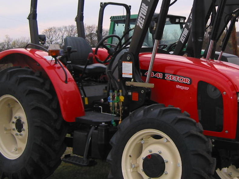

   / ZETOR 4341 comments/opinions re potential purchase #14
Picture of 102 loader on a 4341 Zetor. The joystick is (hopefully) visible on the right fender.
dancce

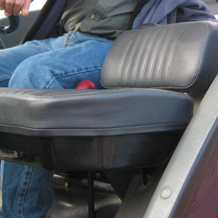

Chipperman,
Is this the type seat you have in the 7341.1SR. I took this shot in Czech a couple of months ago. Are they now available here?
dancce

dancce
Yes, I believe that is the same one. It folds up and over. They should be available any day now. Hope all is well.
Chipperman
