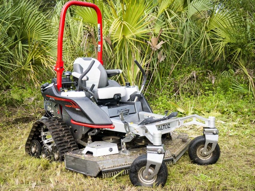

You cant go wrong with any of those brands. I’m a professional mowing contractor and also mow a large steep banks around ponds and zero turns can get into trouble there. Traction is limited when you combine a slope and dampness. Both can be present around ponds. Have you seen the Altoz mowers?
Pretty interesting consideration if traction is needed.
That looks awesome, but I'd never sell her on the tracts and it's $10k more than the CC.
Wow! That's a lot of mower for the money. Anyone priced a new commercial ZTR with same size motor and deck lately?
