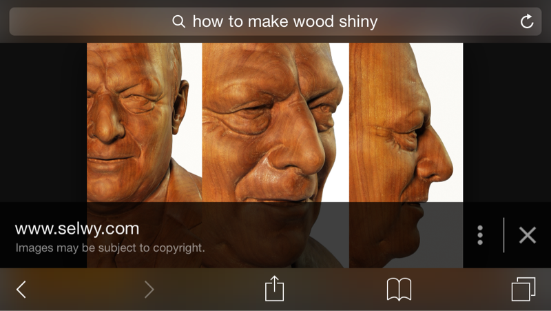

[QUOTE=". What's causing my headache?? Oh, right - been "knocking on wood" :laughing:...Steve[/QUOTE]
Try rubbing instead...

"Try rubbing instead."
No thanks Terry - get enough exercise doin' that to metal - there's an easier way for wood, just dunk it in a vat of urethane and let it drip dry :D (but that was a sneaky way to work in yet another "shiny" joke :laughing:)
