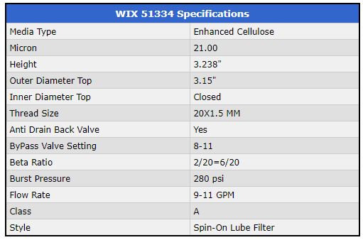

Wix has the cross reference of 51334
Take the 51334 into the Rockauto.com Part Number Search:
RockAuto
You the hit the [INFO] icon for the filter details
Next take that 51334 into the cross reference site.
Now you have several POSSIBLE filters to look up on the Rockauto.com site to verify the fit-up and micron ratings.
I can buy a new case of 12 filters for 1/3rd the cost at Rockauto.com vs. any Walmart or autostore.
With a little work, you can SAVE BIG.

As you have the Yanmar filter on-hand, you could visit a NAPA store, match up the overall height to the WIX 51334. Wix makes the NAPA/Carquest filters.
