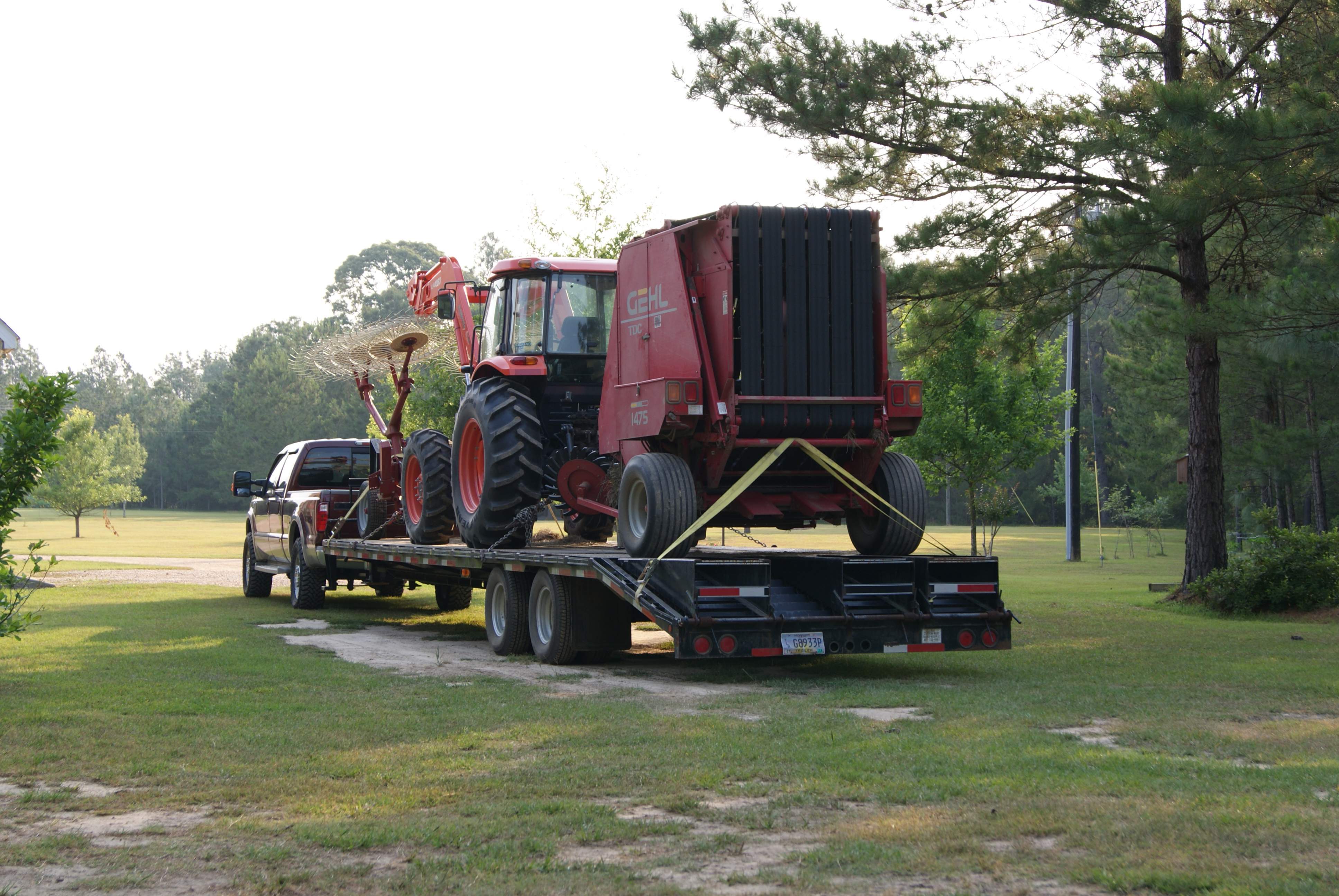

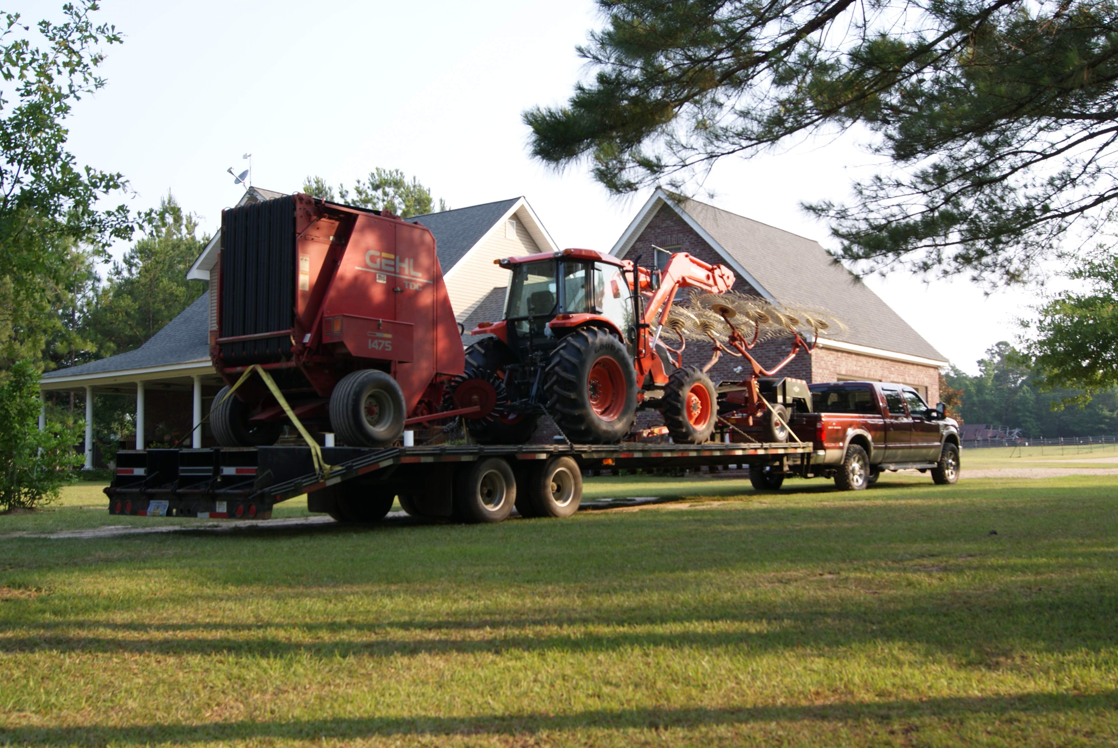

Going to bail hay with the new M9540.
Thats some rig. I was hauling about 14000# with a 20+5 Gatormade gooseneck like that one, and a srw Superduty. I had to buy a DRW truck, to be legal on the roads. I don't know where your from, but I would be in a world of hurt if I got caught with that load in the peoples republic of New York.
How do you like the Giehl baler? My cousin let me borrow his last summer to finish out my fields. My NH baler is old and worn. If I had his from the get go, I would have had the fields down in less than half a day. I went from manual wind and cut to full electric. It was like going from the middle ages to the industrial revolution:laughing:
BTW, nice rig and equipment! How long is your trailer? Mine is a 35' deck with 5' dovetail. Plus, another 8' up on the neck.

   / Your towing rigs and trailers #927
I am in South Ms, the DOT leaves the farmers along. The field that I was going to was only 10 mi away. I don't like going much more than that with the loader up like that. The weight is not a problem, this trailer stops and handles better with 20,000# on it than my 13,000# fith wheel. It is 35' with 12,000# Dexter's under it.

Overloaded must mean something different on Missouri. Clearly your overloaded there. :thumbsup:
Matt
Hmmmmmm,,,, I don't know what my trailer weighs, someone said 9K lbs but I don't think that's right. I'd say closer to 4500. The tractor weighs around 6500. The buggy weighs 3400. The Rhino weighs 1200. So, I'm hauling 11,100 of cargo on a 5000 lb dual wheeled trailer, pulling it with a SD 250 SRW with 350 springs. The trailer has excellent brakes. I sure don't feel overloaded and it stops very well, have to turn the controller down to keep from sliding trailer wheels on gravel. As mentioned I might benefit from shuffling some of the weight off the truck?? But otherwise I don't see the problem. Check out the SD Dually hauling the antigue truck, he's squatted as bad or worse than I am. But hey,,,, I'm new to the big trailer world. :)
