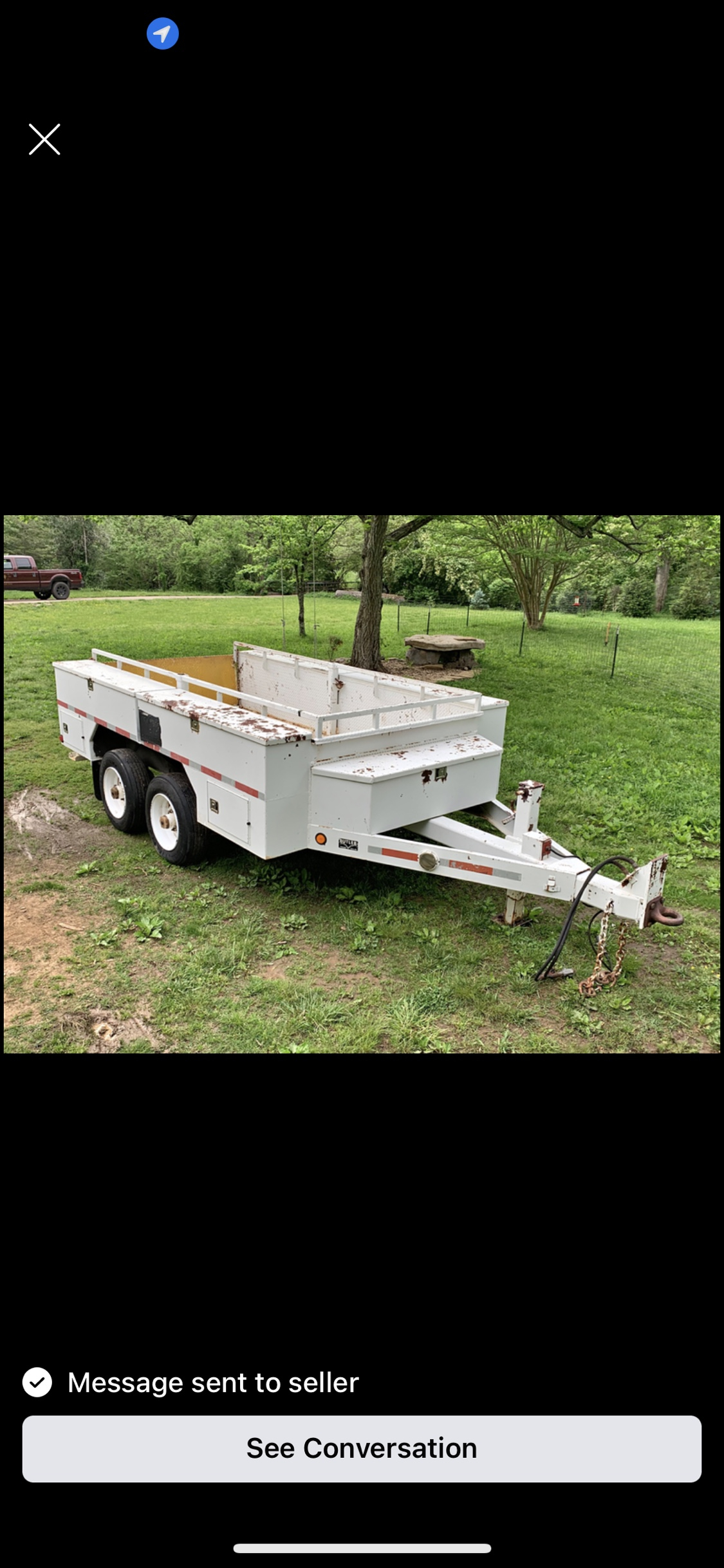

I just bought this little extreme duty service trailer. I bought it with the intention of putting the axels under my equipment trailer. It’s got double 10k axels with super singles and air brakes.
   / Your towing rigs and trailers #4,109
A few years ago when I was doing side jobs I would have like to have had that trailer it looks like it could have been handy, but now a days I leave most of the work to someone else.
