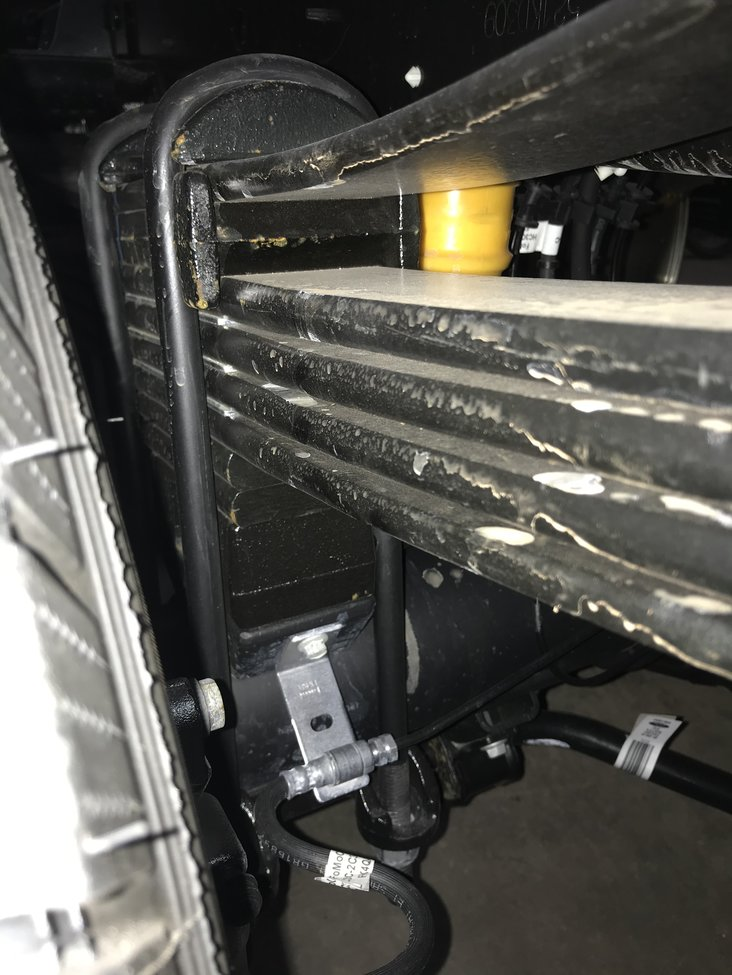

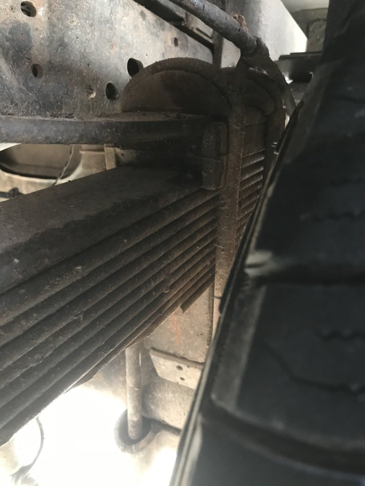

I, too, doubt you’ll need airbags. How many leaf springs do you have, in the rear? On most pickups, they have three or four leaf springs. When you move to the C&C, you get nearly a dozen. It’s one of the biggest differences between a pickup and C&C. There are others, but not relevant to this discussion.
Compare apples to apples though, you can have more thinner leaves, or less thicker leaves.
Here is a 2011 F350 C&C:
Here is a 2020 F350 C&C:
Source: 2020 cab and chassis leaf springs - Ford Truck Enthusiasts Forums
It all depends on the thickness of the leaves, the stiffness, etc.
If it’s anything like my truck, it rides much better, with a trailer on it.
As do most full size pickups.

True. I wonder if those are rated the same.
The springs on the 2020 C&C look thicker than what I’ve seen on pickups, from a couple years prior, but it could be the same. Hard to tell, in a picture with no scale.
   / Your towing rigs and trailers #3,865
They are thicker and a little longer. It's a way to reduce the amount of total steel needed, gives the load capacity and yet rides more like a car.

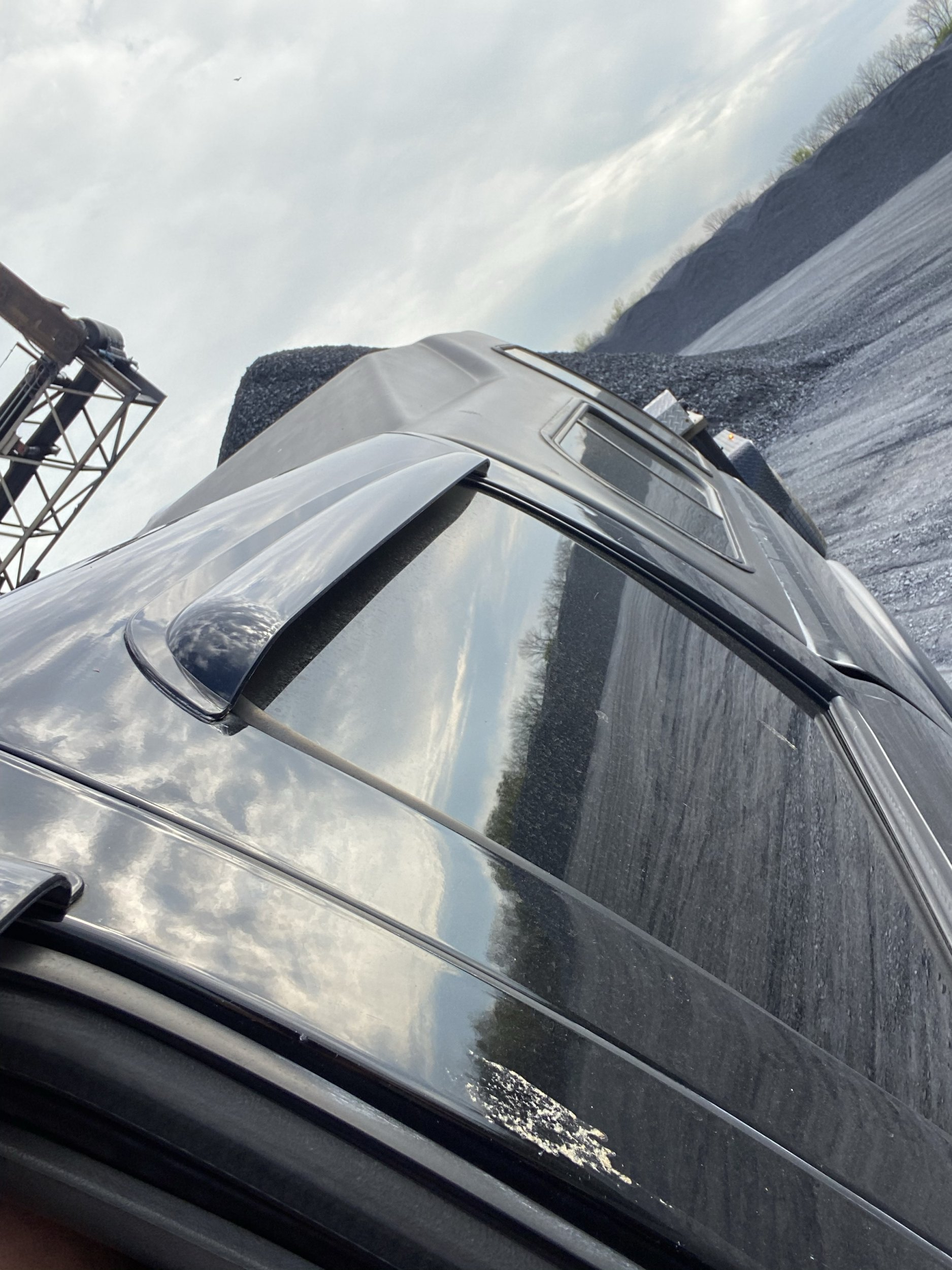

Glamour shot? (Just kidding, it’s old and ugly @231k miles)
The loader is amazing, told him 4 tons, “light” per load). All 4 loads were between 3700# and 3800#.
