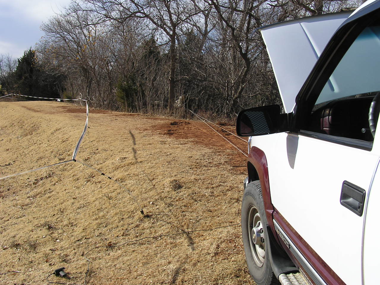

Yep, I installed a receiver hitch on the front:
Put a chain around a long dead tree and hooked up the winch line:

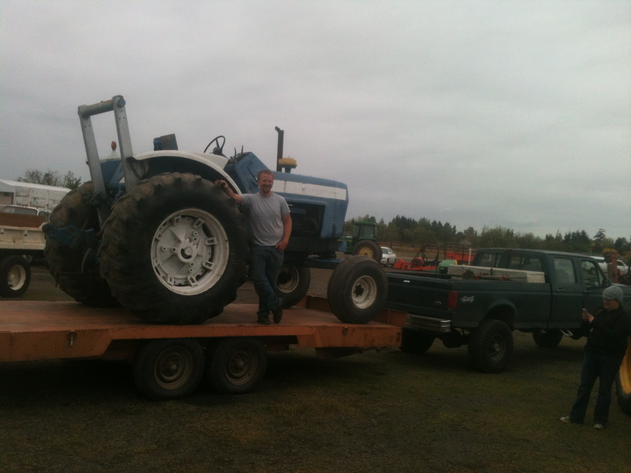

Here's a picture of the towing setup I use for big stuff... that trailer at one point in it's life had 3 axles (that's why the fenders look goofy), now it has two 8000lb axles, about 2500lb of trailer... that Ford 8600 on the back wasn't tied down at that point (my brother for reference... we didn't have that many bananas on hand... :)). That was the biggest load I've ever towed since the tractor was 12k pounds! Was only 30 miles from the destination and didn't go over 50... I think the 10 weights that came on the front of the tractor were in the bed, but it towed great...
Since then the F350 ('97 crew cab long bed F350 with 7.3L PSD and ZF5) has gotten F250 blocks in the rear lowering it 2" and I took the overload spring out of the front leaf pack. One of the many previous owners put a 4" lift on the thing, the 35" tires fit just fine and with a camper I wanted shorter, it tows and drives MUCH better being 2" shorter...

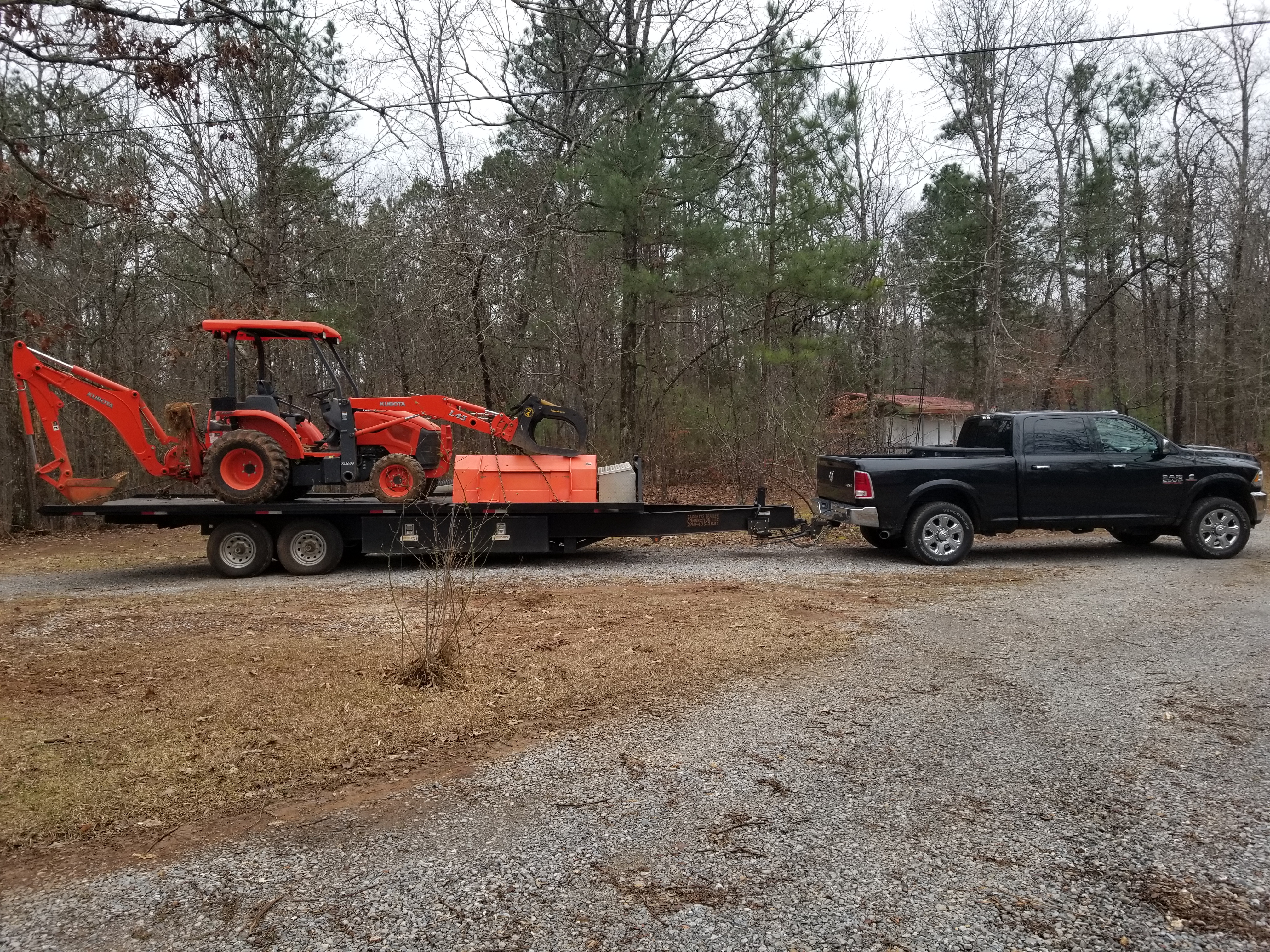

My new truck going to do some work about 20 miles away, this is it's third pull since purchasing it on the 11 of Jan. yesterday we made two trips with my 7 ton dump trailer loaded with firewood gave it to a family about 7 miles away. Truck did fine

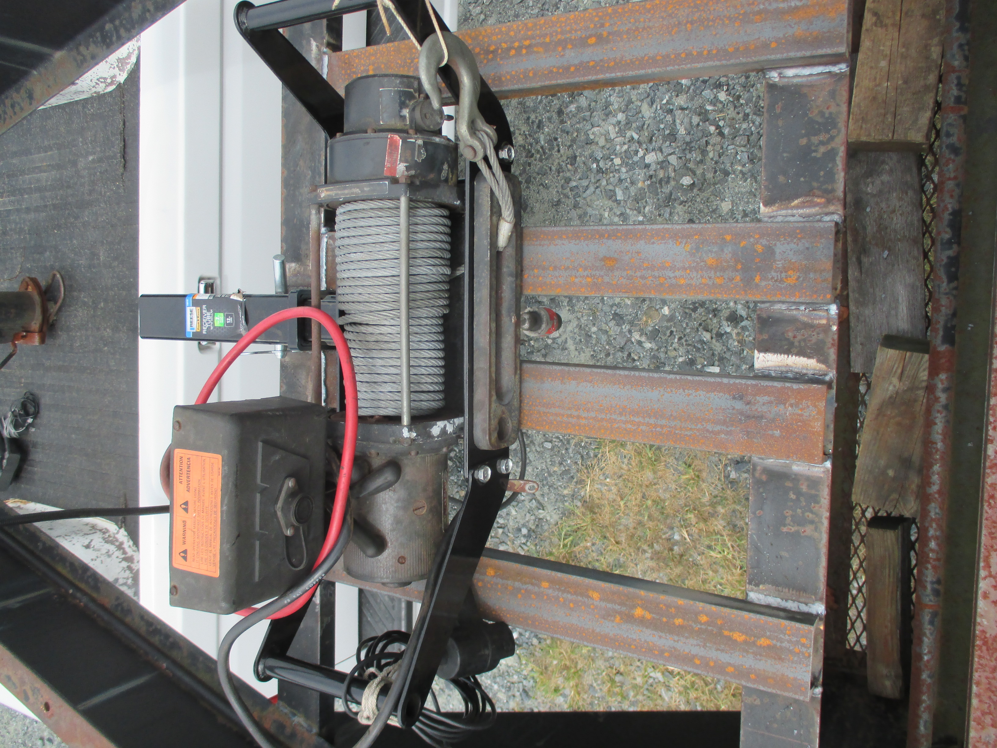

New 16ft PJ I picked up today! I've been waiting a month for it due to manufacturing backlog, and it took a few days for the dealer to order/install the winch I asked them to add. Electric brakes on 5k axles, Heavy Duty ramp option, and SuperWinch 9500lb winch up front.

Can you take a picture of how you hooked up the equalizer hitch to the trailer. Most 14k trailers have too big of frames to mount a typical equalizer hitch chain grab. This may be the first one I've seen with that hitch set up. I like it.
