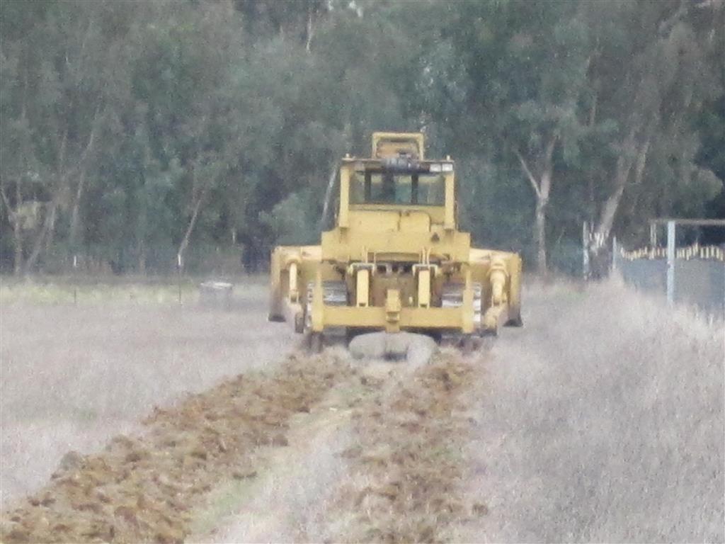

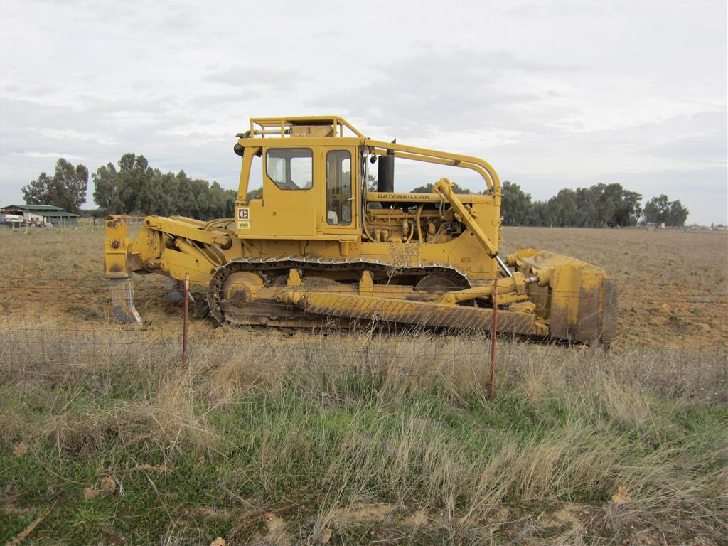

So you want to plant an orchard?
Clay soil usually means hardpan--like we have here in the Central Valley of CA
Many orchards here (almond, walnut, pistachio, olive, plum (prunes), mandarin orange).
Orchard growers don't dig holes to plant the trees.
The first step is to rip the soil with a D8 Cat that has two or three shank rippers (aka subsoilers) that work down to 3-4 feet deep to break up the hardpan.
If you skip this initial step you probably are wasting time and money trying to establish an orchard in your soil.
Here are a couple of photos of my neighbor Juan ripping his 8-acre hayfield to prepare for a walnut orchard a few years ago.
Ripping walnut orchard-1.JPGRipping walnut orchard-2.JPGRipping walnut orchard-3.JPG
Good luck

Wow that is a heavy machine. The ripper attachment must weigh over a ton and the blade is so massive.

Thanks for your input Flusher, and pretty impressive ripper. I need a backhoe to replace the high-alkaline soil - otherwise nothing would grow - salt content is that toxic. Some fruit trees would go in along with shade and windbreak. For the purpose of planting the rest of the property in permanent pasture or forage grass we are bringing in gypsum, and lots of it, to amend the soil.
Yep. It's a beast.
Historically, the Catepiller Corp traces it's origin to two CA companies (Holt and Best) that developed the prototype Catepiller track layer design in the early 1920s specifically to rip the hardpan in the Central Valley between Bakersfield and Fresno. Catepiller relocated to Peoria IL in the late 1920s to tap the huge heavy farm and industrial equipment markets in the Midwest.
