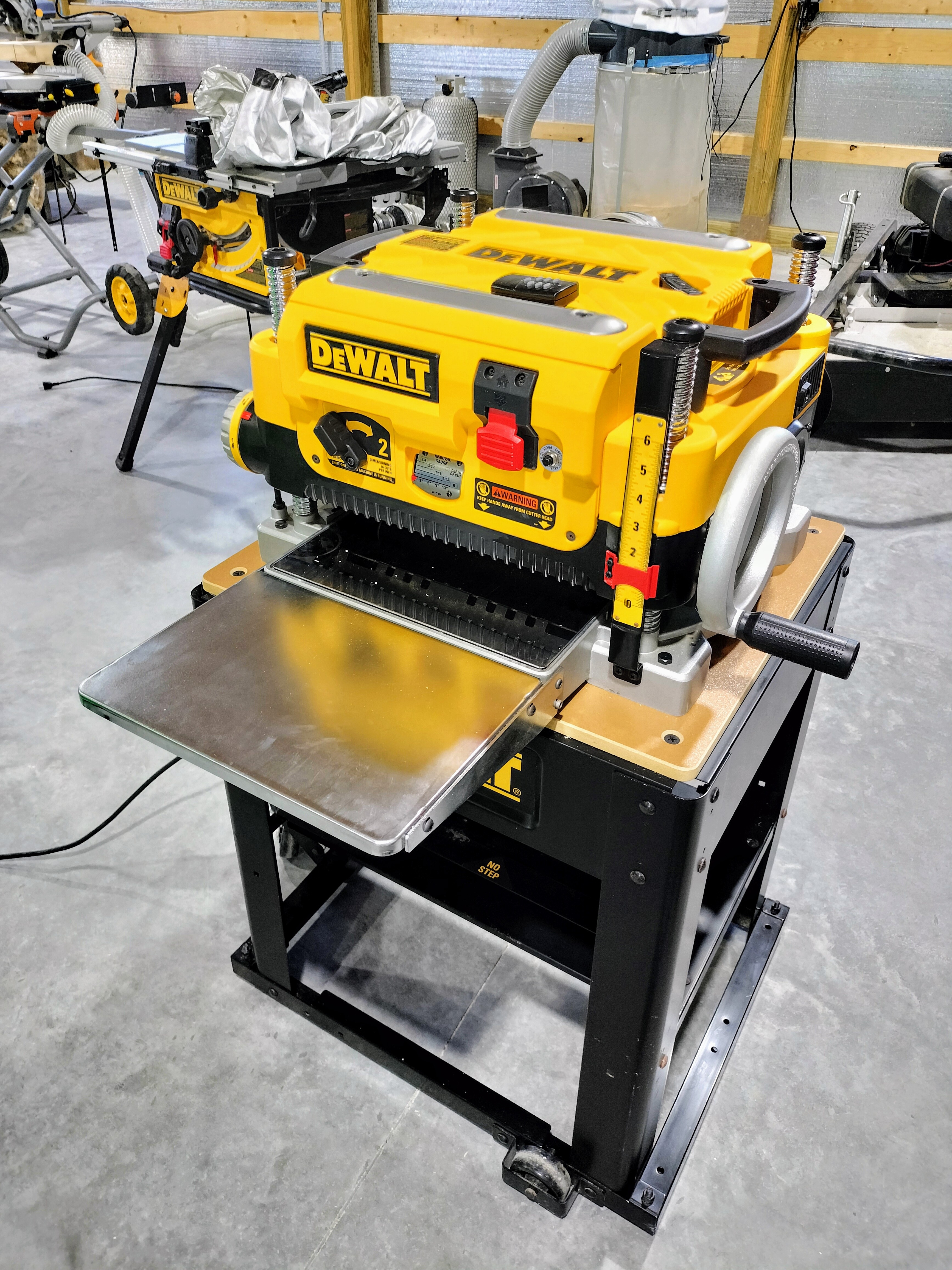

Adjusted. Just picked up this thing for a song! Previous owner didn’t have the tables adjusted correctly. Cleaned and waxed tables and adjusted them. Zero snipe.

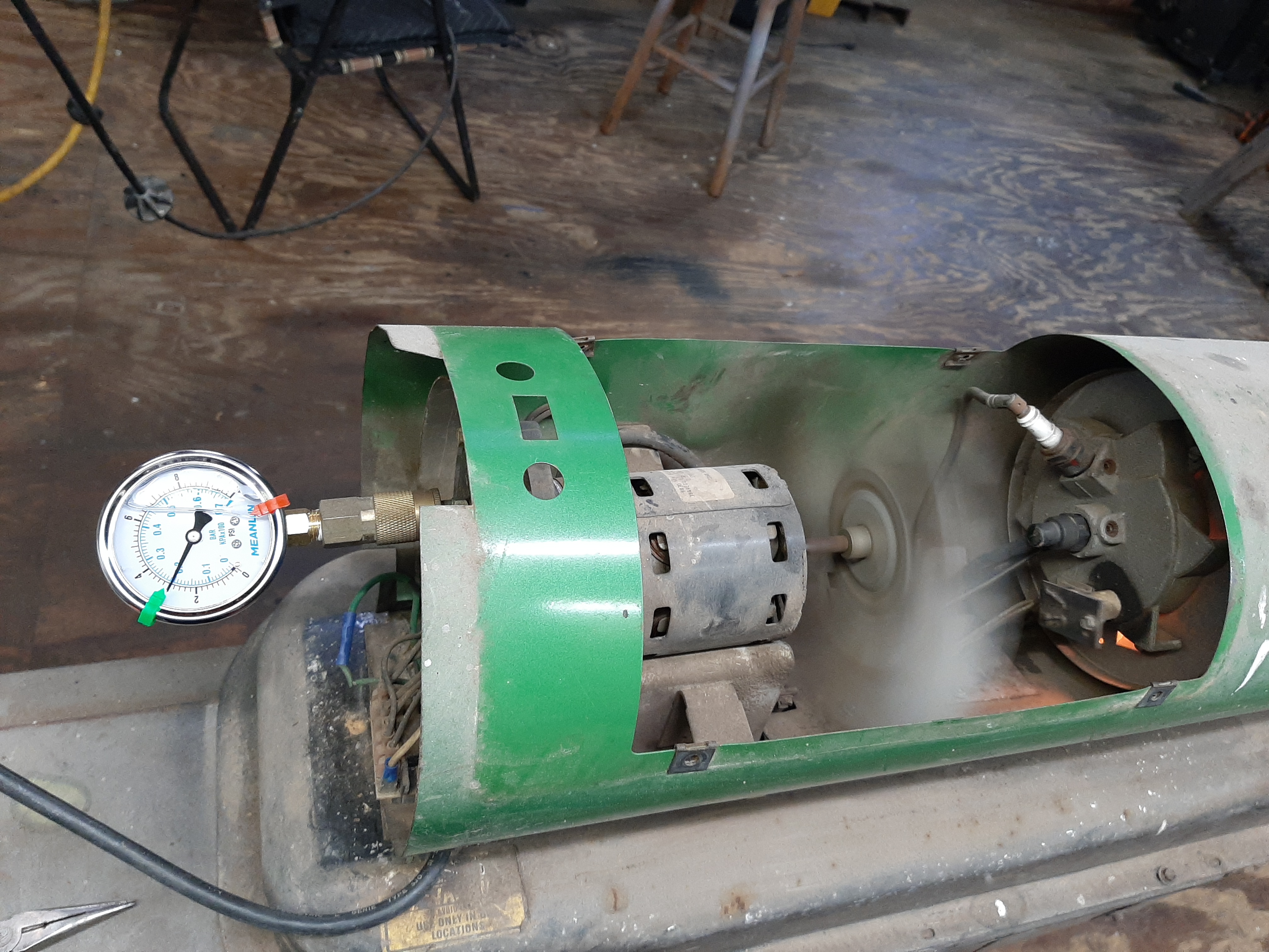

Well I hope it's fixed. One relic sitting on top of another. This CO-OP 55k btu heater is around 40 years old. Needs a tweak each year. Starting fuming after 5 minute run this winter so had to dig a little deeper. Several YouTubes later, fingers crossed.
/ Your latest "fixed" thing. #69
Have one of those as well but I never run it indoors because one, it stinks and two it produces carbon monoxide while it consumes oxygen so it must have lots of ventilation. Mine 'quits' as well sometimes. The electric eye that controls the burner gets carboned up and must be removed and cleaned with mineral spirits on a shop towel.
/ Your latest "fixed" thing. #70
^^^ Possibly fuel rich and can tweak up the atomizing air pressure. This one is supposed to be at 3 psi, falls off to 2.5 after it runs for 10 minutes.
/ Your latest "fixed" thing. #71
They all utilize a carbon vane compressor directly tied to the fan motor and the vanes wear after a while but you can reverse them to restore the air flow.
The one I have, you can throttle up or throttle down the air flow via a red screw knob on the backside of the unit. If I crank it down tight, the heater turns into a blow torch.
