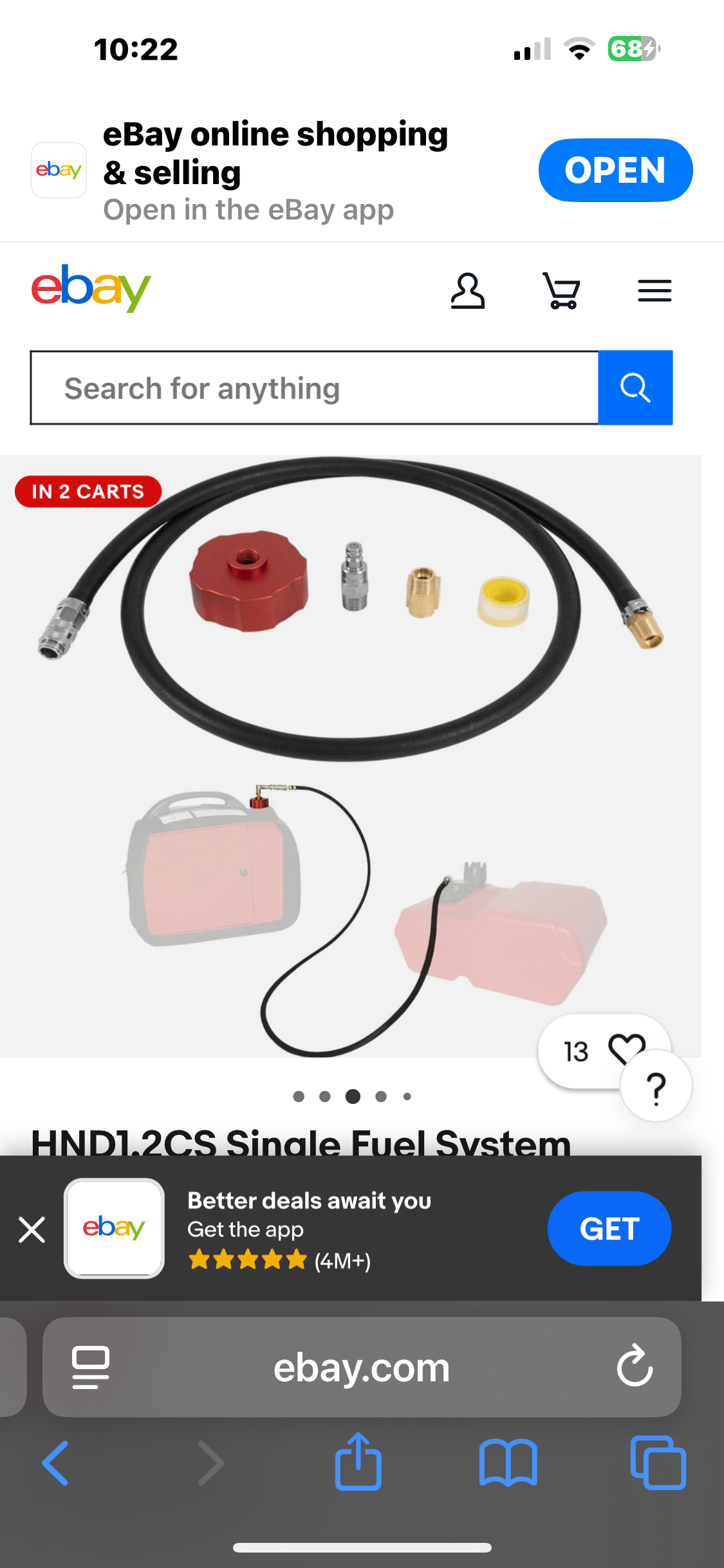

Does this "auxiliary fuel tank" attach directly to your 2000i tank??
It’s connected using a modified eu2000i fuel cap that has a fitting & fuel hose threaded into the top. The auxiliary tank I use is an outboard motor fuel tank with a priming bulb attached.
The EU2000i has a fuel pump and will pull fuel from the auxiliary tank.
