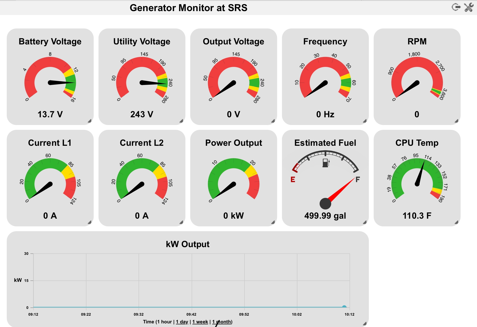

I just added a Genmon to my standby after seeing GRS’s posts, it’s amazingly capable for donorware software running on a Raspberry PI. The downside is that it isn’t plug and play, but it’s not rocket science either.
I would recommend it to anyone that isn’t intimidated by a bit of technology and has some basic computer skills.

I'm often impressed, by how low/no-cost software, coupled with almost no-cost hardware (and, someone willing to spend a bit of time tuning the tech) can outperform many commercial offerings.
Having that telemetry, accurately sitting on your cell-ph, Doesn't Get Much Better, than that.....
I had the guy that builds these things preload mine….so it was plug and play. But i do love it. I ended up changing mine to an ethernet cable due to poor wifi reception out by generator, but that was also plug and play.

I also had the guy at pintsize.me add me to his cloud, so now i can monitor mine from anywheres theres cell reception. Its like $10/year. I figured ill try it out for a year, see if i use it much.

I put up an outdoor access point years ago to provide service for my propane tank monitor and the mobile link connection for the Generac standby. Interestingly the Genmon installation coexists with the Mobile Link connection. I did use a usb external WiFi module and antenna rather than the one on the Raspberry PI board. It connects with plenty of bandwidth.
Less than a $1/mo.... sounds good !
