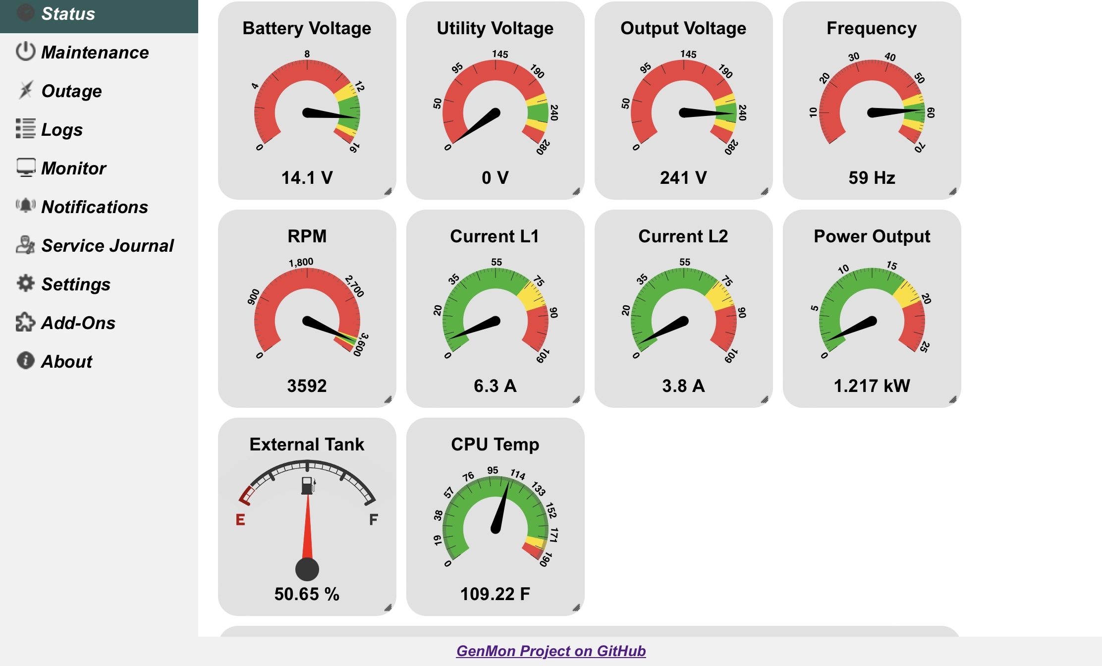

I was just contemplating doing a loaded test run on my generator this week…..i guess mother nature is doing it for me. Not much on right now though.
