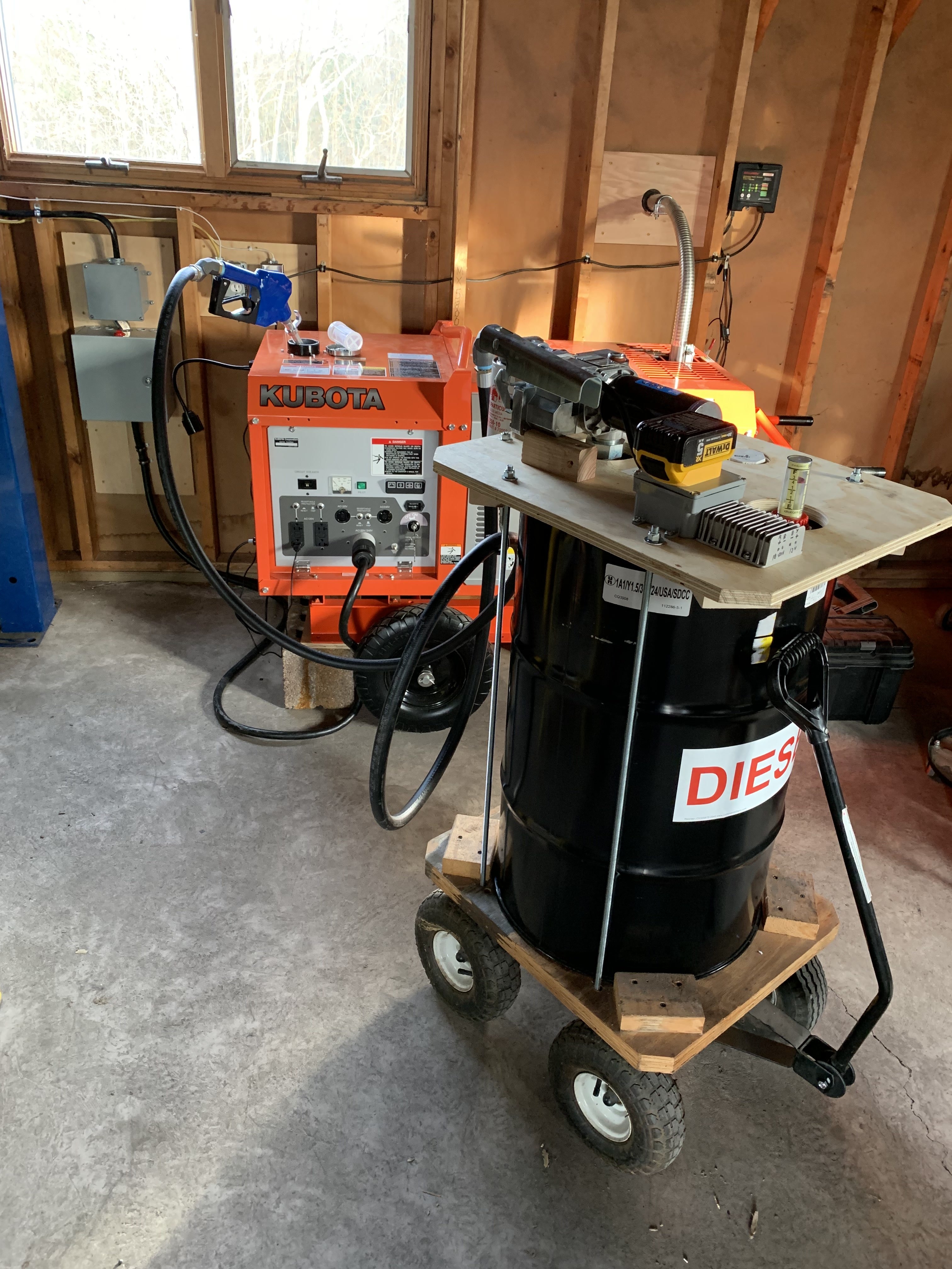

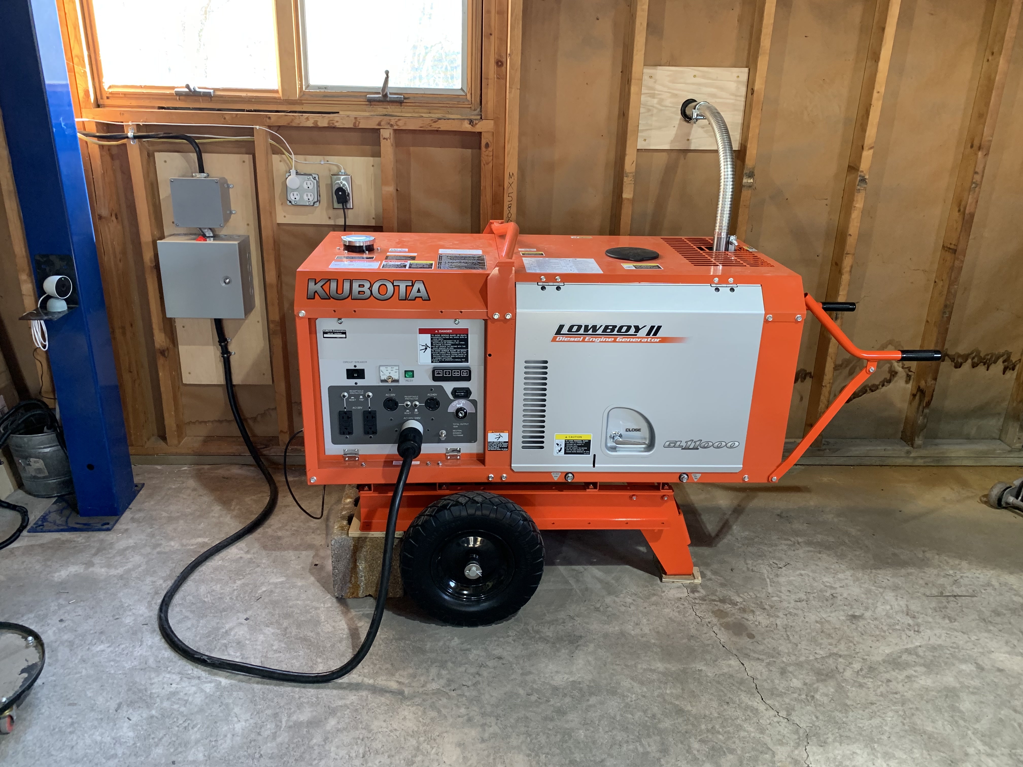

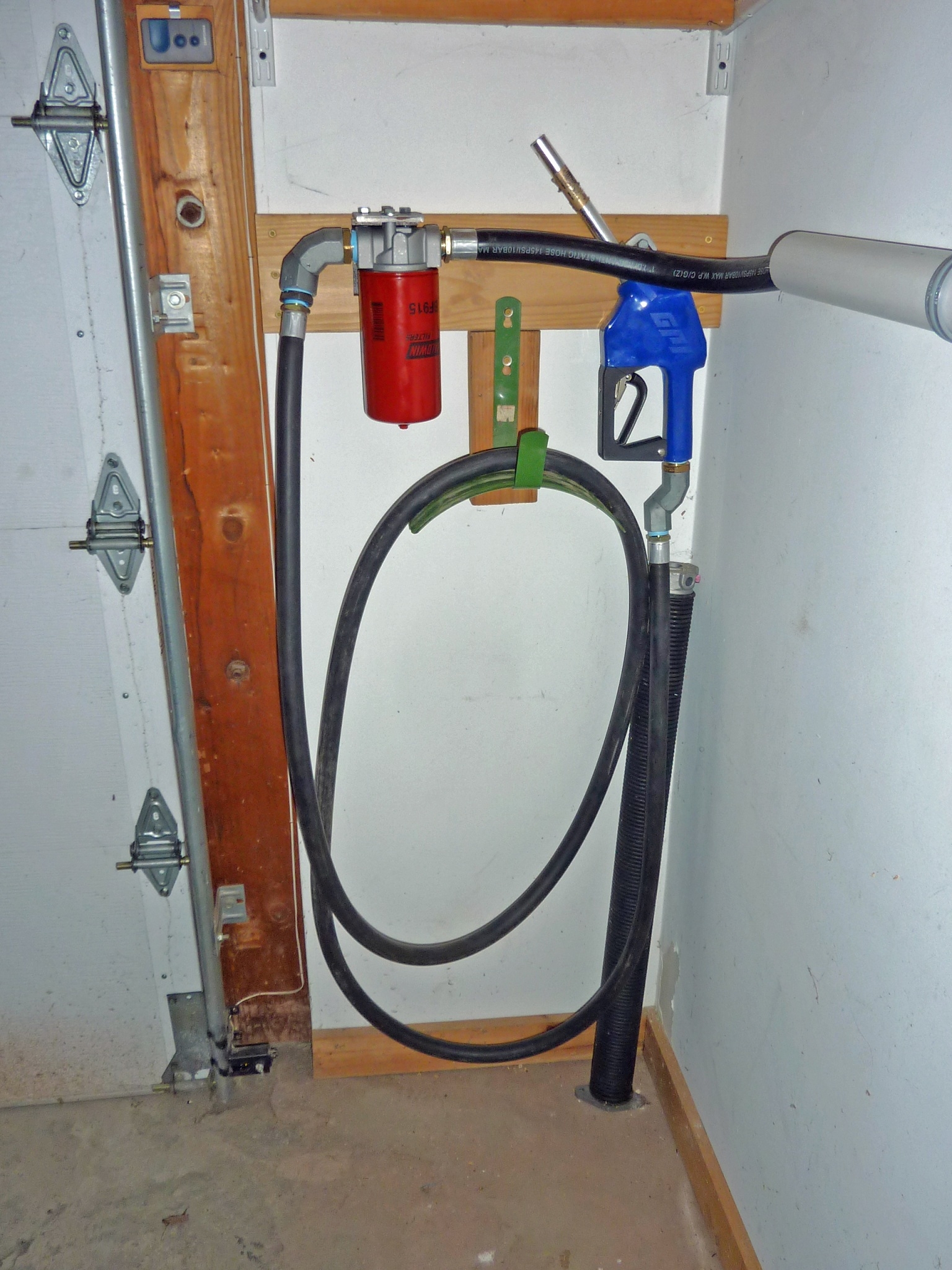

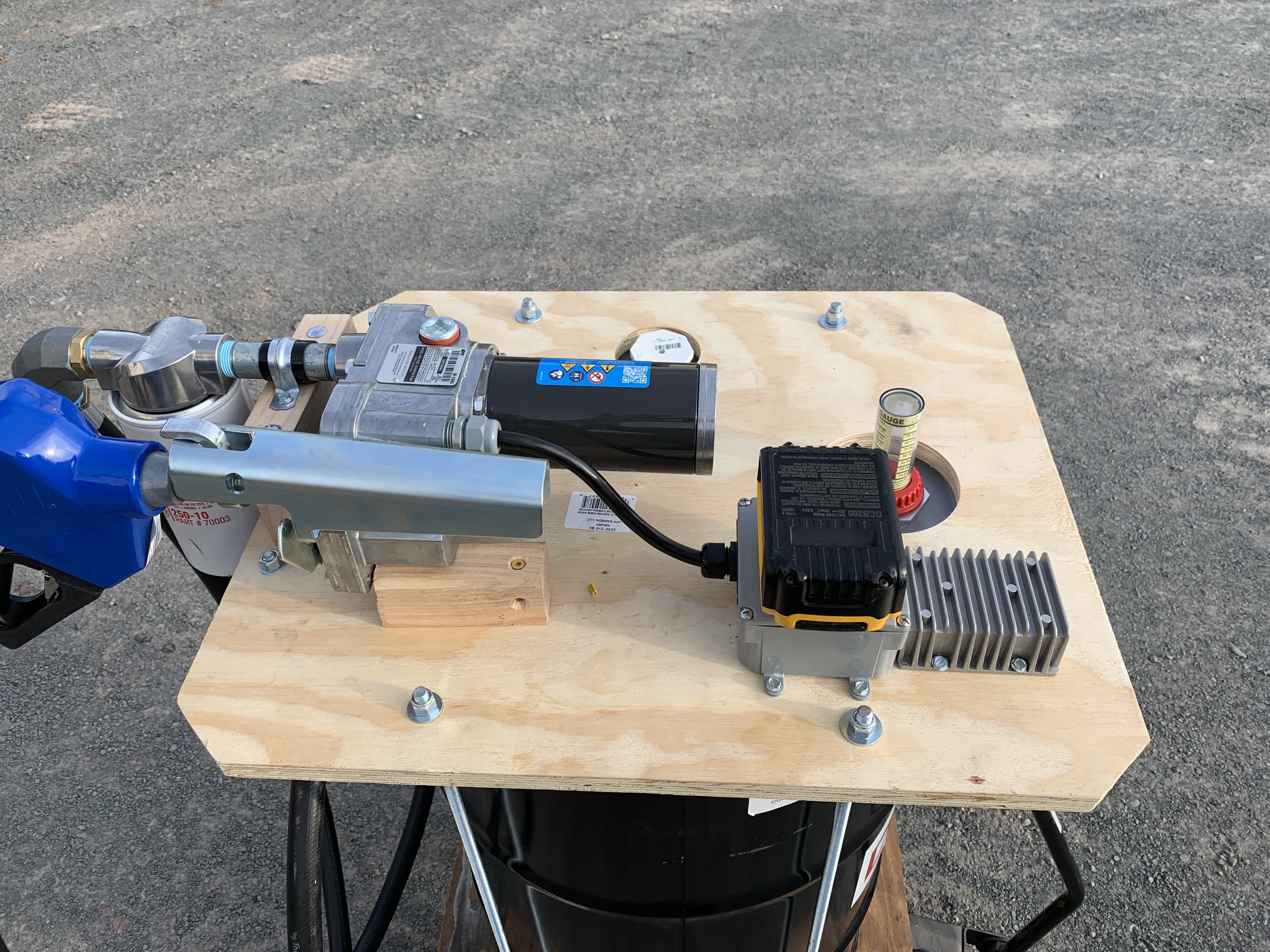

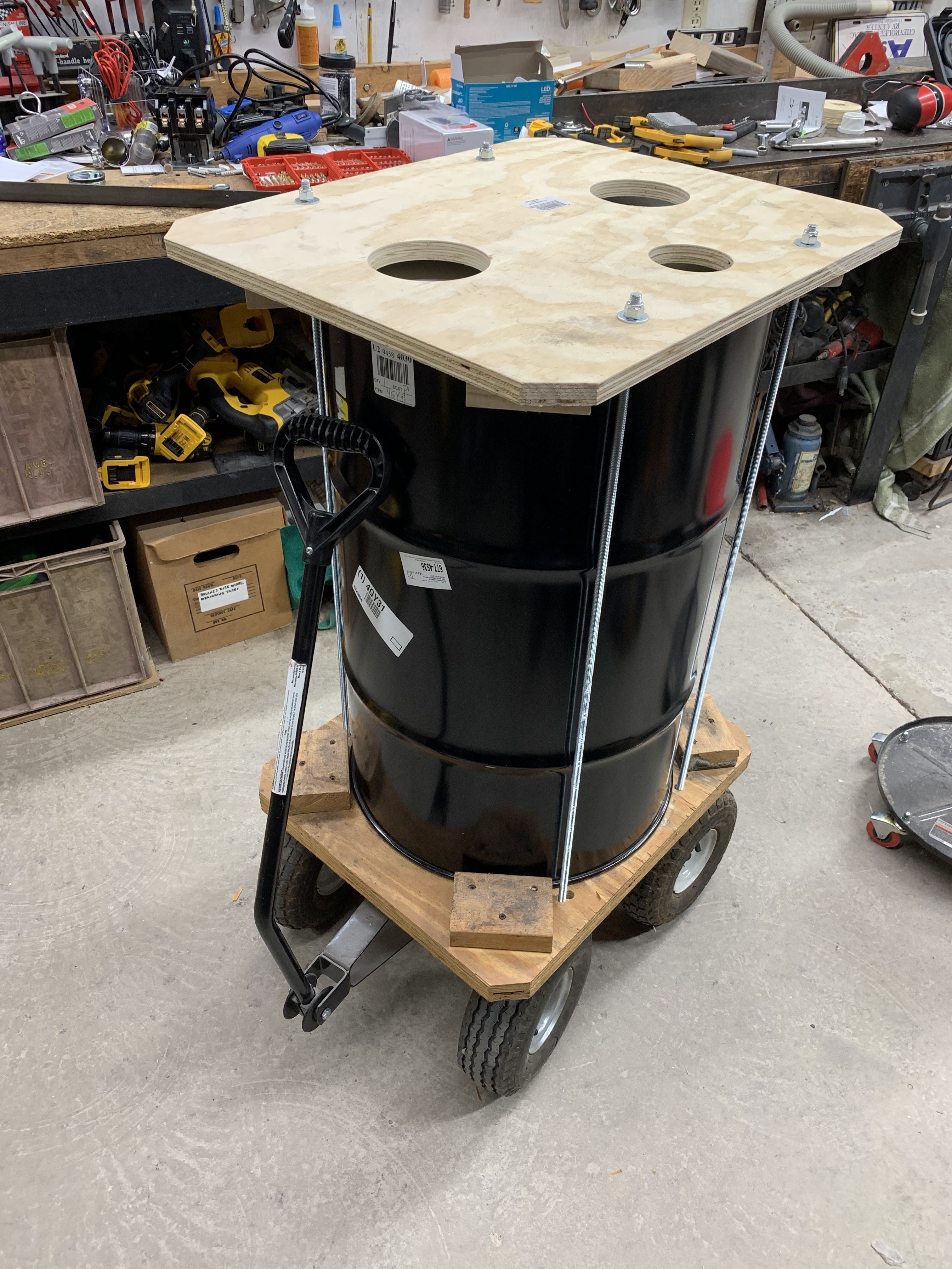

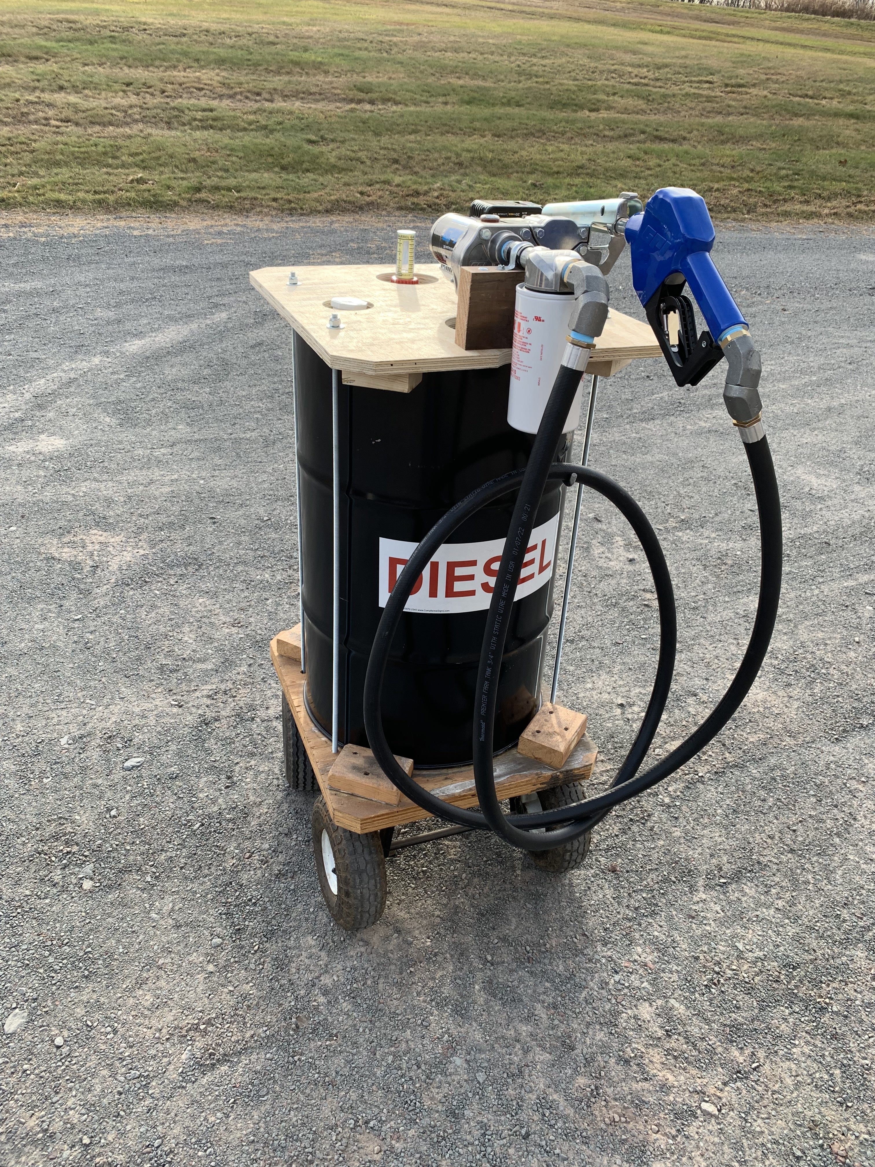

I came up with a way to fuel my standby diesel generator, which is installed in the back of the barn. Presently, I fuel my tractors from a pump on the 1000 gal. fuel oil tank at the house.
View attachment 1850864 View attachment 1850865
I can't use it for the generator, so I built this fuel caddy to transport fuel out to the barn:

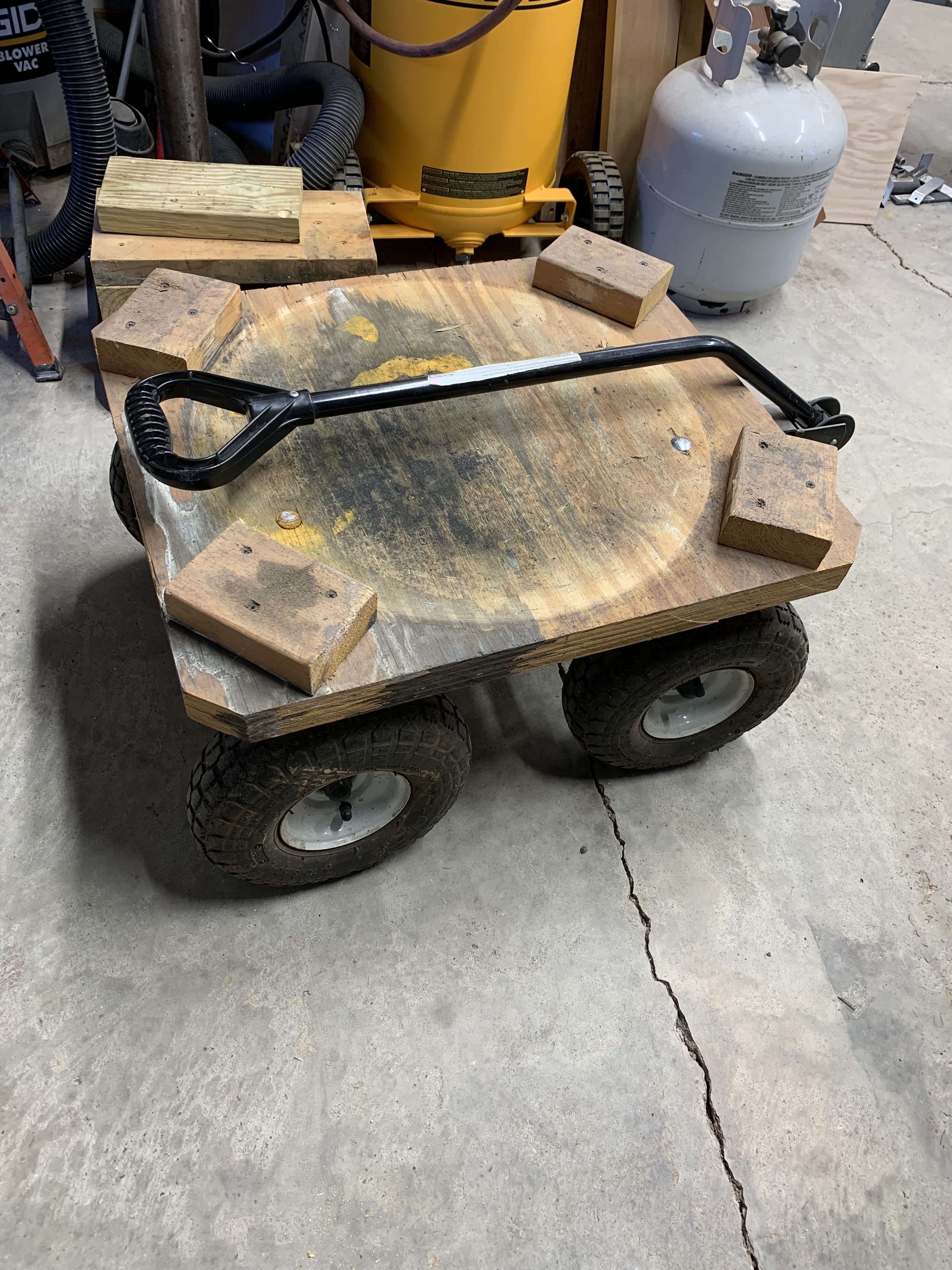

I try to repurpose items I have around the place for projects like this. I took an old unused cart I built to haul barrels of coal to the stove, and mounted a 30 gal drum.
View attachment 1850870 View attachment 1850869

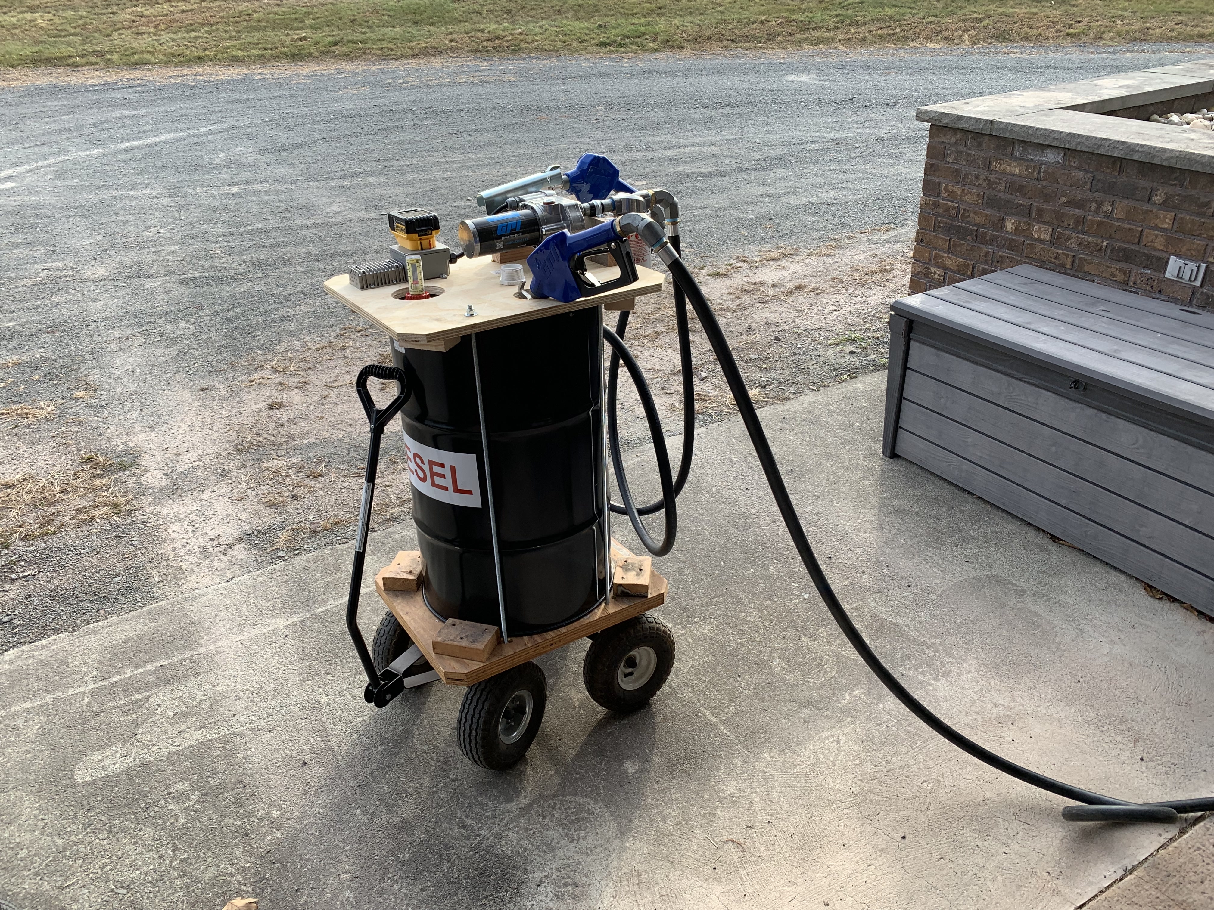

I took a 12V transfer pump off an old tank and installed it on the barrel. I powered the pump with cordless tool batteries so the whole rig is self contained and can be used during a power outage.
View attachment 1850871 View attachment 1850872
I fill it at the house and roll it out to the barn, or anywhere else I need fuel. The only thing I had to buy was the barrel and the 20V to 12VDC converter.
View attachment 1850873 View attachment 1850874
Yes, there are wheeled fuel caddies out there but they're pricey. Most have hand crank pumps, which I hate. I find it too difficult to watch the fuel level while cranking the darn thing.
There may well be a battery powered fuel caddy on wheels out there but I have yet to see one. If one does exist, it would surely cost more than the $100 I have invested in this home made rig.

Yes, DeWalt batteries, I have a dozen or so.

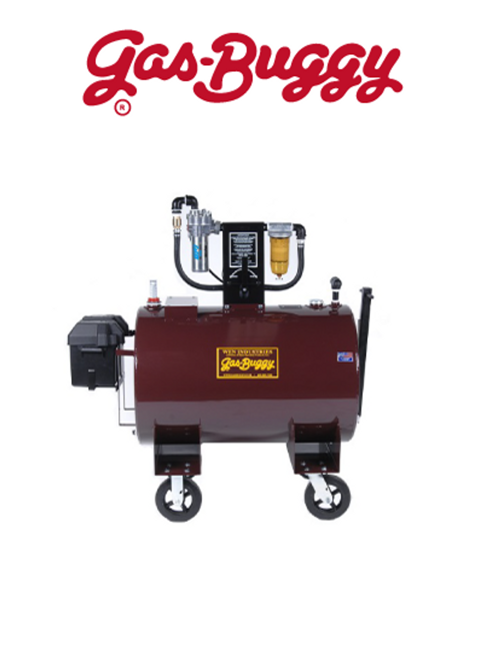

Wheeled fuel caddies have been around forever, but most I've seen have just two. They're moved like a hand truck and have a balance point. I saw one full of used motor oil get away from a guy at a gas station once. It fell backward on it's side and it took two men to get it upright again.
There are some out there with caster wheels on the front instead of skids, but they won't roll over rough ground. I did come across this one with 4 smallish wheels and a wagon handle:
The $4K price tag was a bit rich for my taste though.
Years ago, I had an old diesel poly tank with a hand crank pump that lived in the barn. I never had an issue with gelling and it was far colder around here back then. We'll see this winter if a steel drum is any different.

$4k !!!! IF those things are selling..... I'm in the wrong business !!!!
Pails...... can be big problems..... I was in an Auto-Parts shop,when one of the guys from a nearby industrial shop came tearing in, looking for oil. One of their guys was backing a payloader in, and managed to run over 1 or more 5 gallon pails. If you've ever spilled even half a quart of oil..... you can imagine how much fun that was to clean up.....
Not having something tip-over, for the cost of 2 extra wheels....... money well spent.
