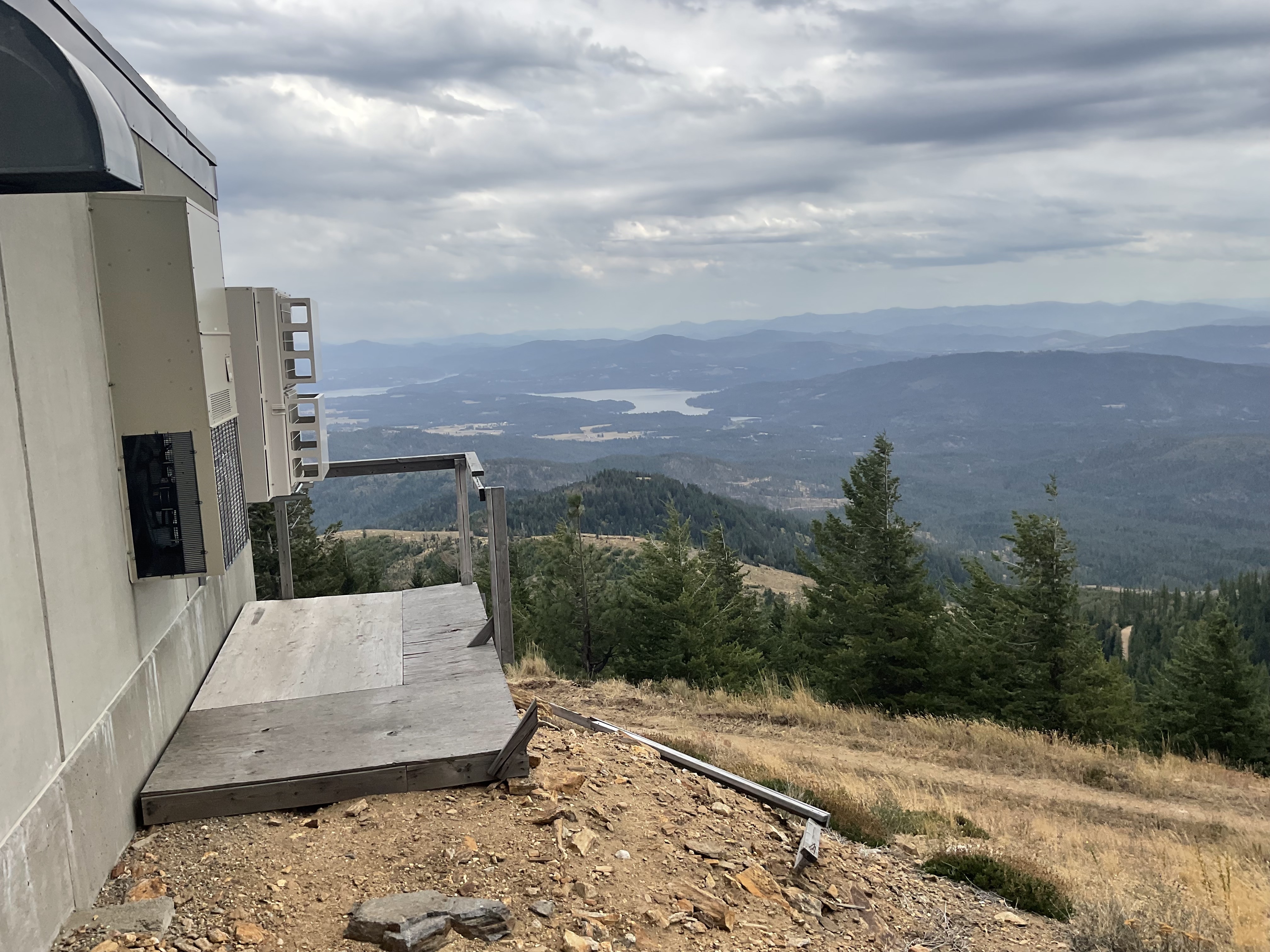

But seriously….i had to 4x4 up this goat trail to get to the top of this mountain. Most of it in low range. And what do i see at the top…..a ground mount transformer. This must have cost a bloody fortune.
What's the alternative? Running low voltage that far would cost a fortune in cable, not to mention the challenge of getting the larger spool wagons up there.
Are pole transformers more common in these cases? Setting poles up there is probably no easy task, either.
