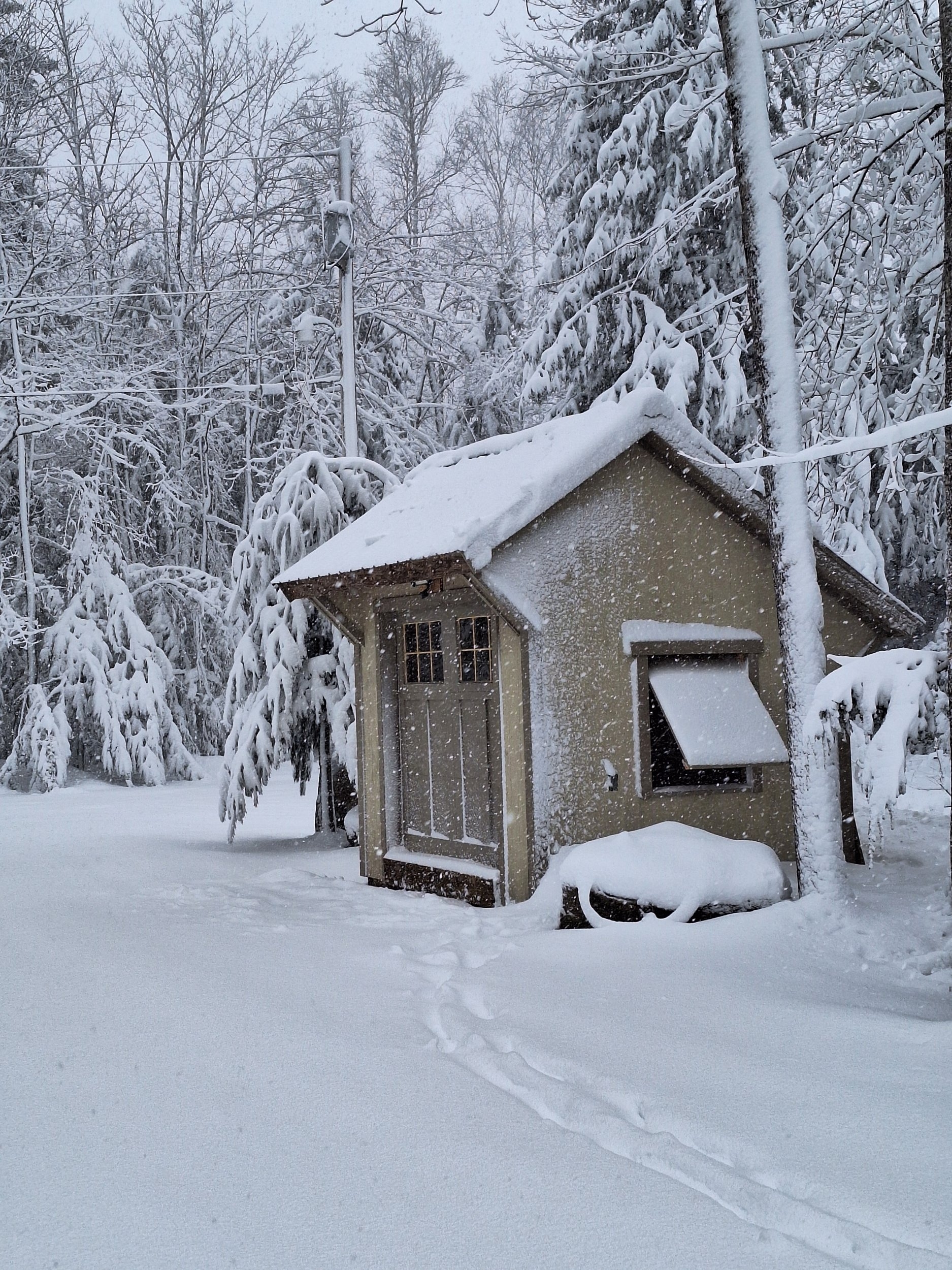

I'm going on day 3 with my diesel genny. I'm so glad that I didn't settle for a LP unit for the convenience. Lots of folks are getting close to running out of propane for their generators.
As I knew, many times that you have a power outage (at least here in rural Maine) many of the "things" that you can normally count on like open roads and businesses (the propane dealer) have electricity and the manpower to operate even normally in a widespread weather event, not to mention the increased load of hundreds of customers all needing filling at roughly the same time.
My generator sits on a 190 gallon tank that was almost full going into winter. I just checked it and after 55 +/- hours, I still have over a hundred gallons. About 5/8 of the tank left.
Something to think about especially for the "rural" folks considering a backup generator.
I have a couple of relatives that are "in town" in relation to my situation with the common generac/lp units and they're power was restored yesterday, well within their fuel supply.
I'll try to remember to follow up when we're back on the grid with fairly accurate fuel consumption. Last I checked it was around .56g/hr.
We had a very wet/heavy 18" snowfall beginning Wednesday evening into Thursday evening and tapering off Friday.
I started the generator 5am Thursday morning. 👍
   / Your last generator Maintenance Run
#6,639
You did a great job on that build Rusty, both technically and esthetically on the bldg.
Not the first time you've had a good run with it, but probably one of the longer ones.....
