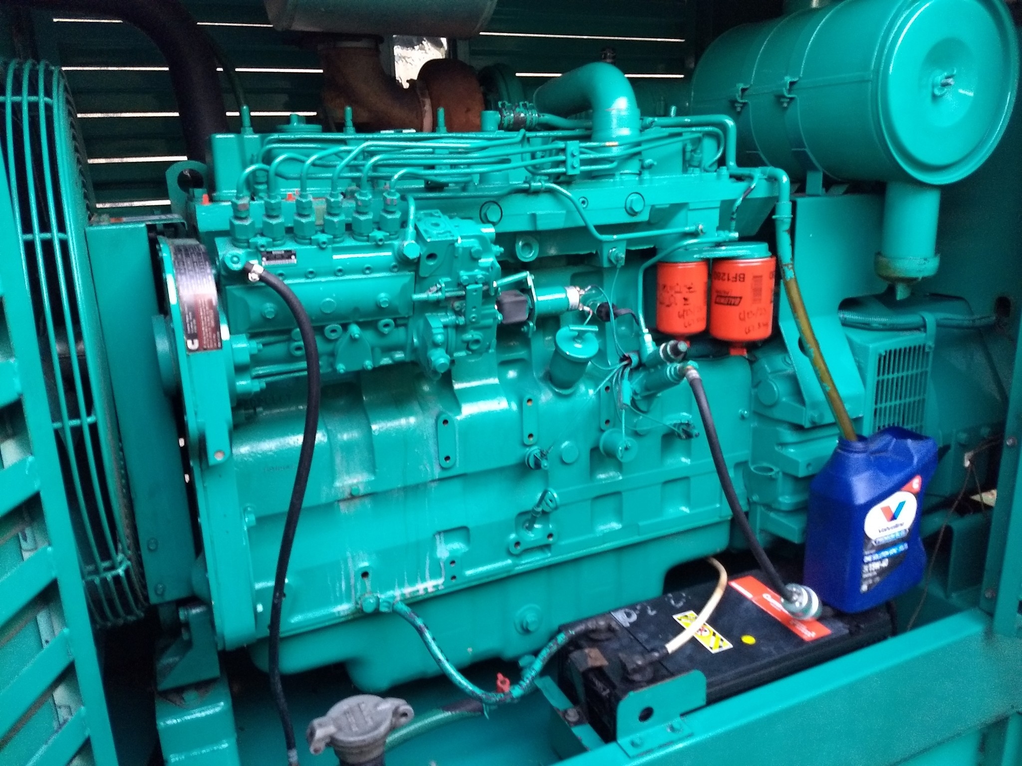

Just did the annual on the generator I bought new for the clinic in 1995…
It will out live us all if it was not targeted for removal by the air district…
Maybe I can take it home when it has to be replaced but a little overkill with a 150kW standby rating, 480 volts, 3 phase?
For decades I ran it weekly 30 minutes plus cool down at 40% or better load but now only once a month because non compliant units are limited to 30 hours yearly for maintenance, reliability and 4-hour load bank.

I give up, what kind of engine is that?
