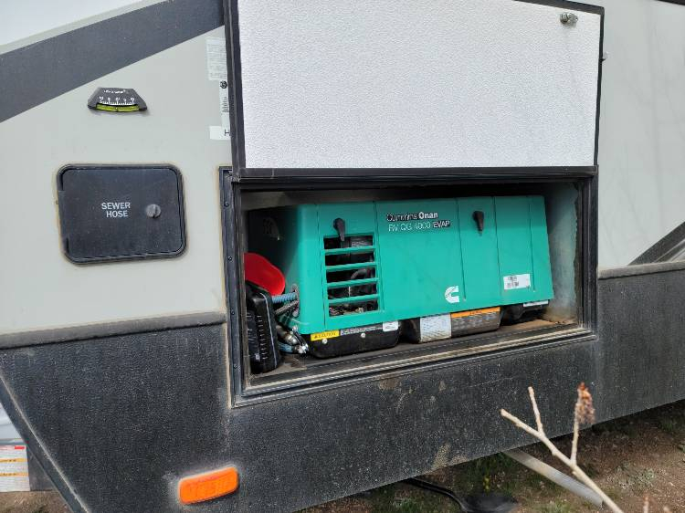

Fired up the Onan/Cummins 4000 in the RV getting ready for camping this weekend. Started fine, ran fine. Stut it down & then got around to checking the oil. Opened the dipstick fill port & out came flowing our WAY over full. Didn't smell like gas as much as I'd have expected, but thats the only fluid it could be. Or the last guys that serviced it managed to fill it higher than the fill port.
Carb had a couple drips on it so I'm assuming it's leaking inside & out. Gambled on a $35 Chinese carb off Amazon. The OEM carbs are not rebuildable & cost $100 or so. Will see if I made a good call or not tomorow.
Keep us posted..... many people have had good luck with those ChinaCarb deals.....
