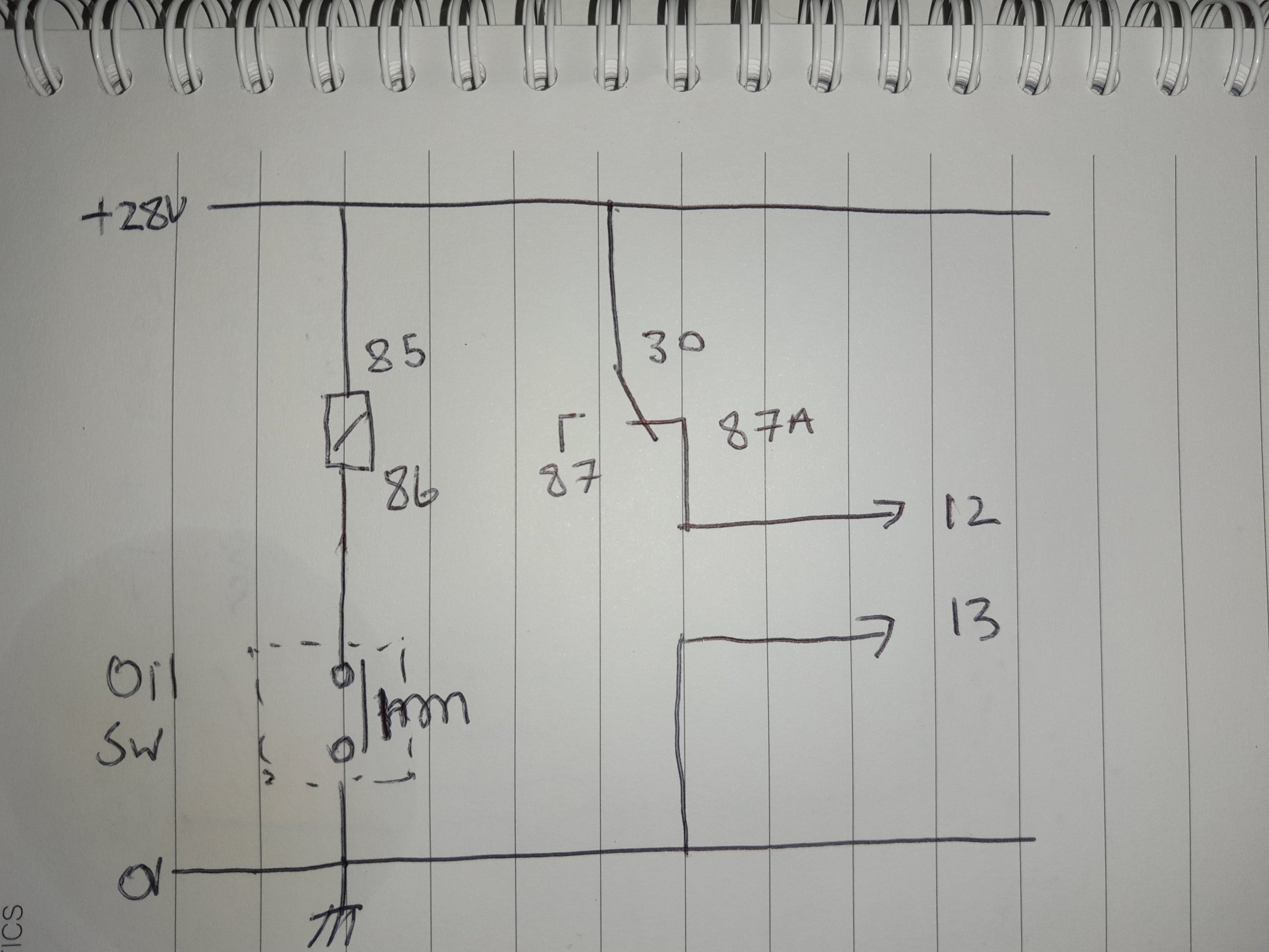

I’m needing some help here. I’m back in the powerhouse to configure the low oil pressure switch for the Yanmar.
The switch is normally closed with no pressure and opens at 30+ psi. I have a time delay relay I think will do the job but I can’t wrap my head around it.
2 photos are attached one of the relay configuration and the other shows the connections to the AGS.
The yellow wire from the relay going to terminal 12 is the run signal and must have 12 or 24 volts applied for the unit to run. The other small yellow wire goes to an led light for status. So obviously the power to #12 must be removed if low oil pressure is detected to shut the engine down.
The relay timing can be adjusted from zero to 60 seconds.
Thank you
90cummins
Speaking from experience: I would suggest you try and avoid "glue" logic in the form of separate timers where possible. When things don't quite behave then headaches can occur.
I would connect things as follows: Only needs one of the ordinary relays you posted a photo of a week or so ago, I've added the pin numbers to my schematic.

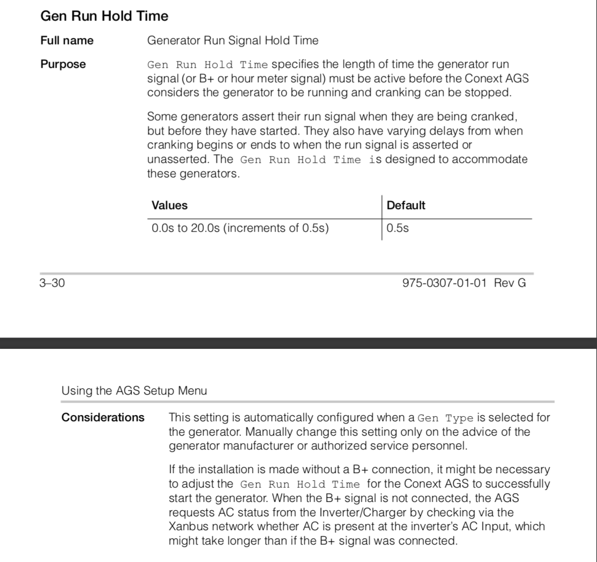

In its resting state there will be no "RUNNING" signal sent to pin 12 of the AGS until there is sufficient oil pressure to open the switch. I believe the AGS can deal with this by adjusting the Run Signal Hold Time appropriately:
I'd do a cold start, noting the amount of time it takes from when you start cranking until the oil pressure switch opens: Then set the Run Hold Time perhaps a second or two longer than that to allow for a cold block and thick oil.
If this doesn't work, I'll have a ponder about adding some more smarts to control your RUNNING signal.
