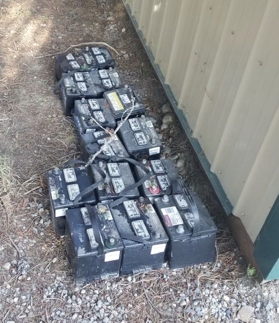

This battery was 5 year old. Positive post already showing crud build up. To me its preventative maint, and besides, i get in about 10 batteries a month from exide.
   / Your last generator Maintenance Run #5,192
This is last months old batteries awaiting exides pickup and delivery of new units.
i feel like a battery hoarder.

An excellent reminder g !
My 7kw portable has a very well designed pull-start mechanism, but that isn't an option (that I know of) for most standby gens.
You've posted horror stories about beyond-dead batteries on systems, but 5 Years Then Out is a pretty good idea on a standby for many customers.

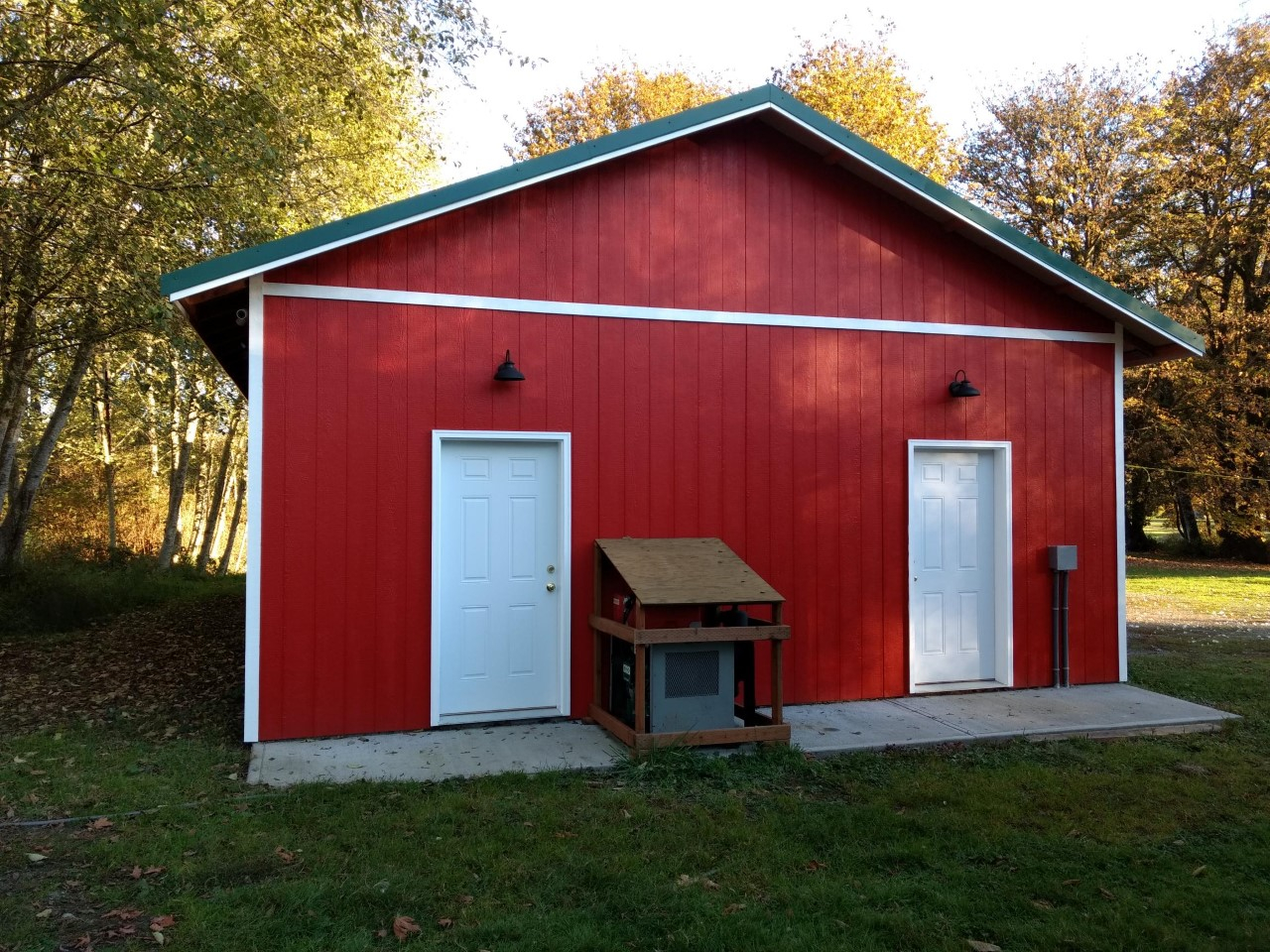

It was on my todo list until yesterday when I came home to find my power out (here, in summer, really?)! So, not only did I get to run my generator (Onan/Cummins 7.5DKDFL) but I also got to USE it (ran about 4 hours)(y) Since I went through the electrical connections (something I hadn't done before) it's been flawless and fully trustworthy.
I don't get that many outages here, but some of the longest were in Summer+good weather.
Electrical...... many people (general public) don't realize how critical the mechanical aspect of it is...... I've been up close to tear-downs/overhauls/PM on switch-gear in sub-stations - mostly just precision mechanical going on (y)
Nice setup you have.... great when a plan works out !
Rgds, D.

Yeah, there can be big loads in summer (my outage was post heatwave- I could have better understood it happening during that period). Also, big temperature swings can wreck havoc on things. Winter, however, is when the trees start to take out power lines...
It took me several years before I got my generator all plumbed in. First had to have my garage built. Needed a nice concrete pad to locate it on as well as neededing a place to support electrical conduit (power feeds in to wall via receptacle box mounted on the outside and then conduit down inside the wall and over to my main service panel). It's ALL manual (manual switching on service panel via lock-out), but simple and reliable.
Main service panel is about 15' away (out of picture, to the right): electrical on right side of building is not associated with the generator. It's been on my TODO list for a while to put on a larger "hat" (top cover) and to utilize screens for the sides (removable) to better protect (from weather and from critters). I like this generator so much (a lot of faith in it) that I am planning on building a new house around it: new house will need to conform to the generator's capacity; at only 7.5kW it's a bit tricky when one doesn't want to rely on propane for heating (I use wood, but new homes cannot use wood as primary source for heating). If only my house looked this nice! 😆

that sure does look nice (y)
