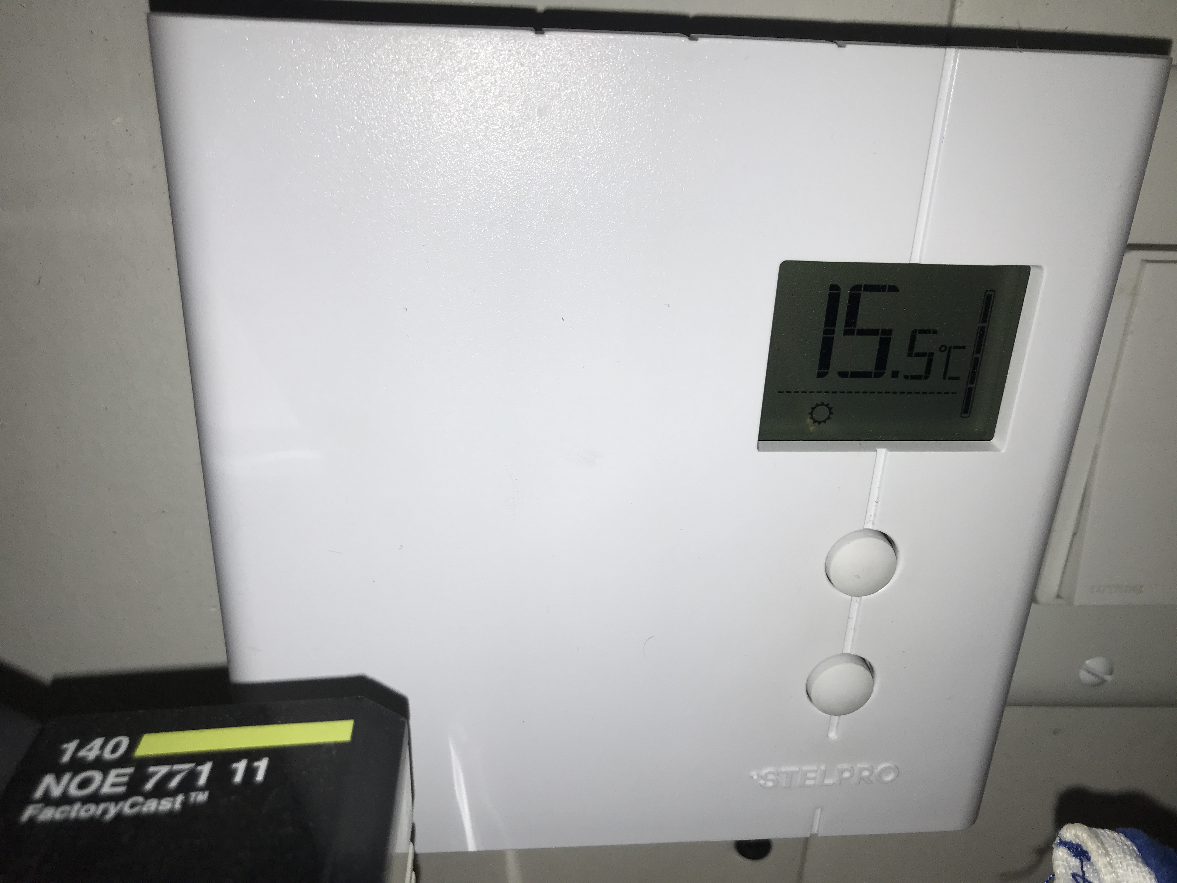

Back on the generator topic... We had a couple multi day outages here this winter and I was starting to think the old old Emerald was finally wearing out, I just couldn’t get it to stay stable for any length of time.
Eventually I determined this electric heat thermostat was the cause. It’s “energy efficient” because it pulses when it’s nearing the set point. So 10 amps at 240V on for 5 seconds and off for 20 seconds. Wreaks havoc on a mechanical governor.

   / Your last generator Maintenance Run #5,099
Timing was just right to make me think it was a fridge or freezer not able to start. Pulled the plugs for all the fridges, freezers and dehumidifiers and it was still there.
Unplugged all the UPS’s and still there.
Wasn’t until I turned the heat up in my shop office that it went away as the thermostat went into full heat mode and stopped pulsing.
