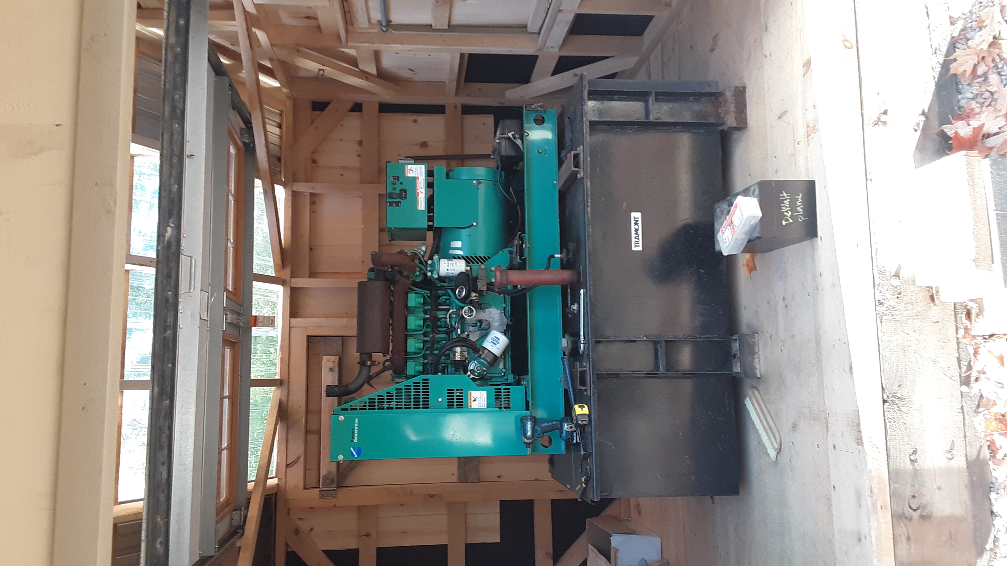

Got a question, even with my new overkill generator (20kw) I hear a difference in the sound of the microwave and the tiny little blower motor on the oil fired hwh while on the generator. Currently we are running the mini splits heat pumps (no electric resistance heat) but they don't even seem to ding the electric bill and as mentioned oil dhw along with lp gas range and dryer so basically lights and 2 refrigerators and a chest freezer and whenever the well pump cycles. They both operate properly and don't smell funny and don't trip anything and not throwing sparks:laughing:
Any clue?
