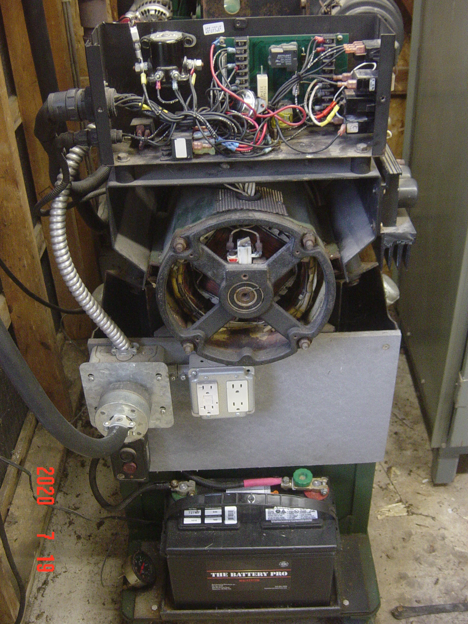

I guess the brushes on my Onan/Kubota 7.5 conventional, couldn't be easier to get at. Been meaning to put the screen back on for years.
