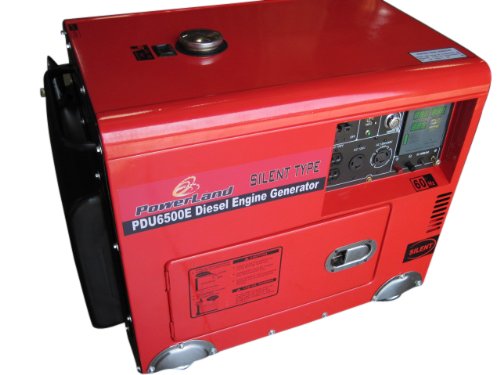

I have a generator like the one here and would like to take the enclosure off. It's just a pain in the butt to work on with it on. Any thoughts ???? iu.jpg

Some Diesels have been designed to be quiet. Others are just the way they are, put inside a padded cabinet. You may not like the noise. Otherwise, go for it. It's all about marketing/appearance and nothing about being practical.
