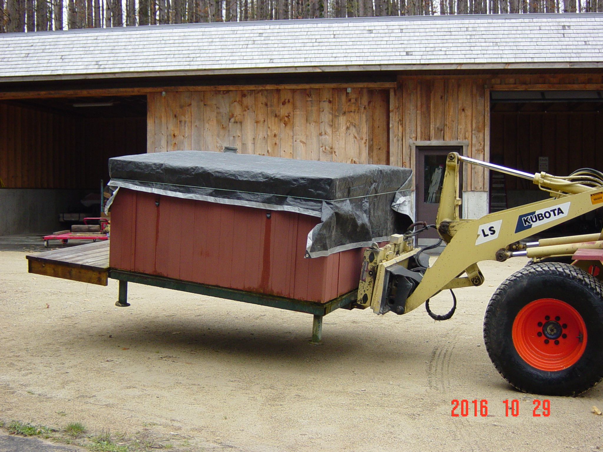

I haven't checked the tub yet. Thought the temps would have gone up by now. I tried to check it last night, but everything was (flash) frozen solid on the exterior. I was afraid that if the tub got up to temperature, it would shut the pump and element off and the pump might freeze. Thought about finding a contactor and cycling the thing on and off but I had my hands full draining other stuff. The hot tub is on a steel frame with fork pockets and is usually put inside by now.
My Portable Generator Load Bank:
Still have some outside painting to do!
   / Your last generator Maintenance Run #1,245
Tom, you truly get an Olympic award for most unusual generator loader !
