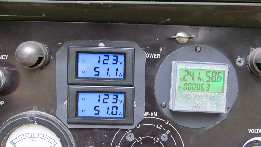

I replaced the old analog gauges on my Military genset with some digital stuff I bought off that auction site. I had to test for accuracy with my Fluke meters. The generator gauge reads a few volts low but the volt/amp meters are pretty dead on so I add the volt readings from those. I mainly wanted the generator gauge for hertz and that reading matches my Fluke meter. Took a while for the meters to get here from China but they were inexpensive and work pretty well.

I like it! I know us old guys are supposed to love analog but that works for me!

Me too, I love digital, has to be more accurate or at least readable, and I sure wish better instrumentation was made optional on a lot of
equipment we own. Including my tractors, garden tractors, mowers, lots of machinery. Perhaps it means I'm OCD but I'm really curious how hot my aircooled engines are.
