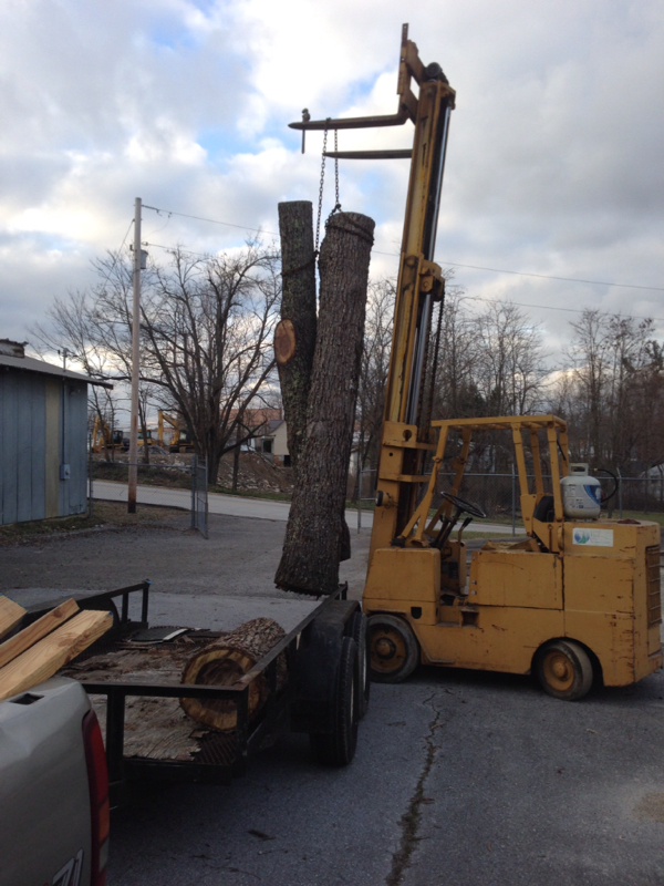

Anyone care to calculate the load on this front axle? Don't forget to account for the mast being tilted behind the axel. The forklift weighs 11,800 pounds. Let's assume the load weighs 1500 pounds and is held 30 inches from the back of the fork. View attachment 459686
Not enuf info to solve.
unloaded axel weight. Front 7300, rear 4500
   / You need balast or you will trash your front axle!!!! really? #428
we dont know the wheelbase
Or the angle of the mast to determine how far forward the load actually is. And how far forward the mast is mounted from the front axle when verticle. So the 30" out on the forks is a meaningless number as well
   / You need balast or you will trash your front axle!!!! really? #429
That is why I suggested using a plumb bob and measure to the center of the axle. Knowing the angle without the length(height) or the distance from the front of the mast I figured it was easy to use the plumb blob and an tape measure. Of course none of this is supplied or given. But this would be an easy way to do it in the field.
