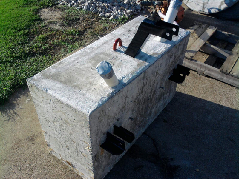

The hurliman sits on a 64 inch wheel base. The 3ph Cat 1 lift arms are 32 inches long and sit a bit behind the rear axle center. Anything hung off the arms will have a CoG beyond that.
32" is 1/2 of 64, so weight centered right at the lift arm eyes takes weight off the front axle at a 1:2 rate.
to take 5% off a 2200# max load would require a 220# weight.
Real world, I hang a 500# back blade which carries it's weight well behind the lift eye centers.. Also have a 5 cubic foot concrete counter weight with the Cat 1 tool bar cast in "near CoG".
Concrete is heavy ;-) (150#/ft^3)
So taking a SUBSTANTIAL load off the front axle is not difficult for this little tractor ;-)
   / You need balast or you will trash your front axle!!!! really? #316
.... Also have a 5 cubic foot concrete counter weight with the Cat 1 tool bar cast in "near CoG".
Concrete is heavy ;-) (150#/ft^3) So taking a SUBSTANTIAL load off the front axle is not difficult for this little tractor ;-)
Do you have a photo of your 5-cu.ft. concrete counter weight you could share with us? :)

Not on file, and the counter weight is off with the neighbor. He uses it to off set his front end snow blower. I use the back blade in winter.
But "visualize" an 18" X 18" X 24 + tall block of concrete with Cat 1 tool bar pin ends sticking out the sides about 6 inches up from the base, and a pair of straps with top link holes out the top. It does a great job of settling the tractor when on hilly lands, (the only kind I have ;-)

I am visualizing that but only visioning 4.5 cu ft of concrete;) maybe my eyes are going bad

How about one that is 8.89 cu ft ? I've had it for a little over five years now and works good.
