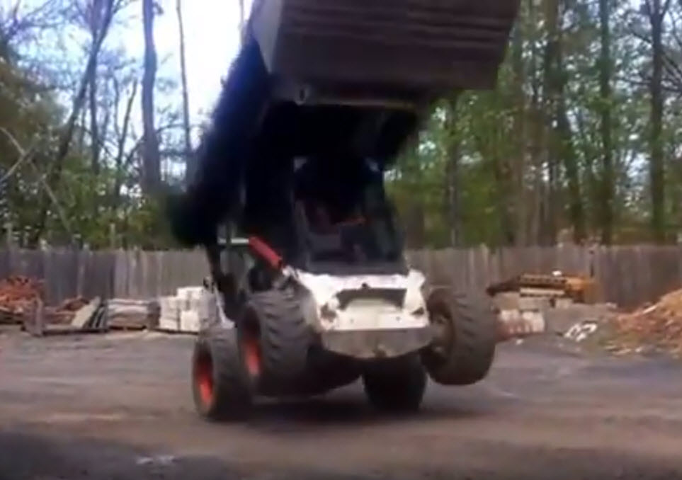

I think Old Pilgrim's point is that moving the loaded loader CG from in front of the front axle closer to the actual front axle by lifting it up higher will indeed help put some of the weight back on the rear axle. It would simply be the weight that was lifted off the rear during the initial loading when load CG was extended out past the front of the front axle. In doing this, (raising the loader), he was able to move his loader's CG backwards and get enough traction on the rear wheels again to back up the hill. It was not loader force transfering the weight to the back as much as it was the loader putting some of the weight back that it had originally taken off. Even if that was not his point, it is a point that we have all pointed out now a few dozen times. I acknowledge that I muddied the water as I was not clear about differentiating between the net CG effects and the physical path of the forces getting from the "load" through the loader arms and back through the frame to the front axle. It reads very poorly when I go back and look at my post again. In reality that is only important when understanding the potential failure mechanisms in our machines. My apologies for that. These discussions should probably just stick to free body diagrams like were presented in an earlier thread link and scale model tests which are really useful. The simple ones don't perfectly account for the vertical effects and impacts on moments when shifting load up and down, but they're still really useful.
So quick question: Who has even had sufficient counter balance weighting to do this when in a fully raised position when backing up? The video can be found at this link here: https://www.youtube.com/watch?v=6WHrXlgGnSs
Also - these guys have some CG balancing skills! https://www.youtube.com/watch?v=6bg...Qzx917eUkVk-aGdnCNgWs8vGB0MgJTwUsa4gheD_1KS9A
Stay safe all!
