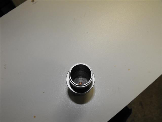

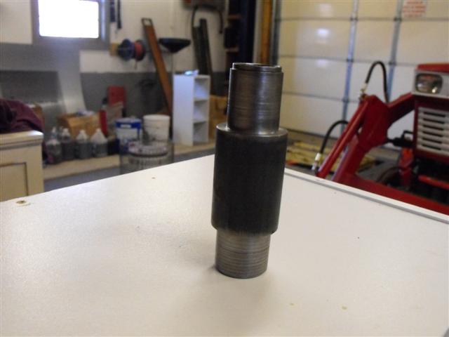

I made this little tool to replace the top spindle bushings. It really makes the job easy. I used a press but it could be done with a hammer too. Had to replace the right spindle because the top bushing area had worn to much.
Also, check the wear on the center pin support for the axle. This will cause front to back movement on the axle when they start wearing out. Pretty easy to replace the bushings.
