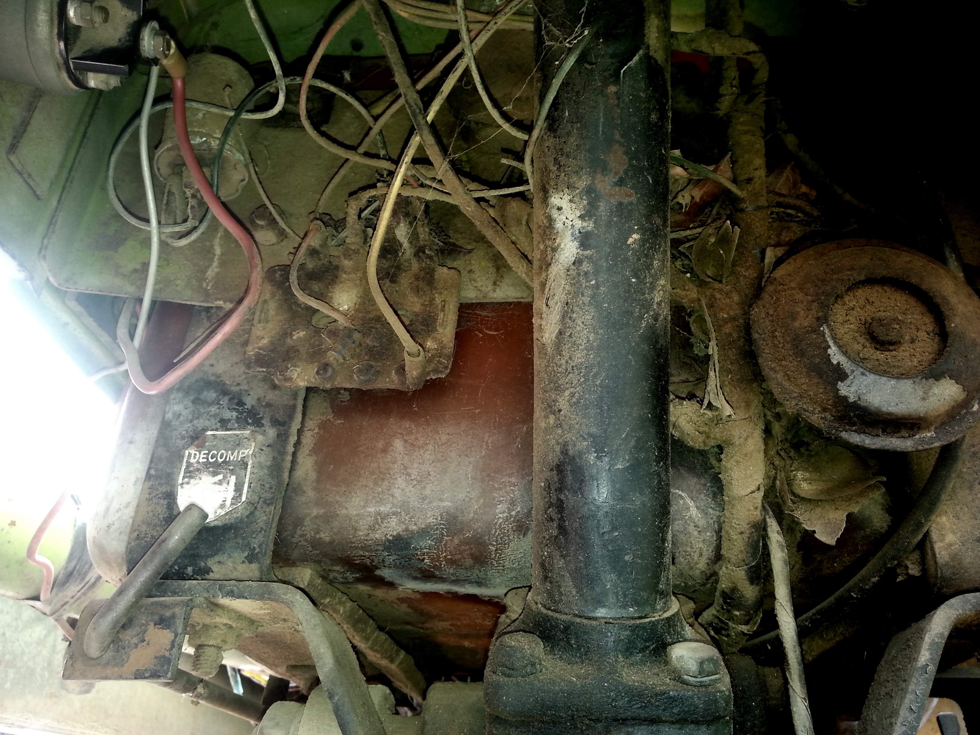

I've been having fun with my YM240, that a got a few weeks ago, learning how to drive it and use the FEL for various tasks. Trial and error, plus tips from this forum guide me.
I solved the starting issue with a new battery and I use a visor sized solar charger from Harbor Freight to keep it topped up.
My original battery was reading 12.x volts but did not have enough ooomph to get the engine spinning with the Decompression venting, so just because its reading
12 volts does not mean its a good battery.
I dont know if my alternator is charging as I can see someone cut some wires that go from the alternator to the starter and presumably the battery.
I need to redo all the electrical as none of the stuff going to the dash works and the wire junction/fuse area is a mess. underpanel.jpg

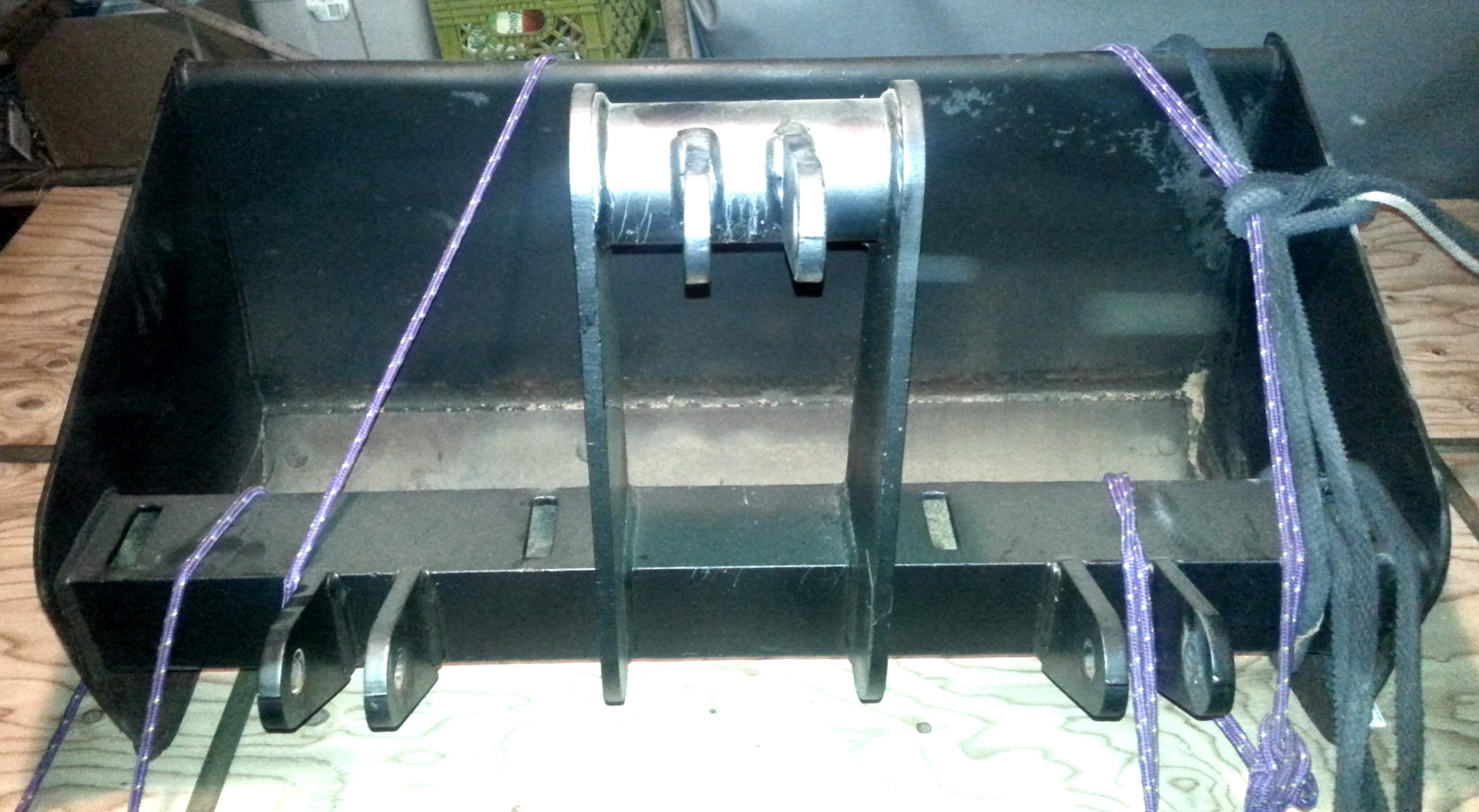

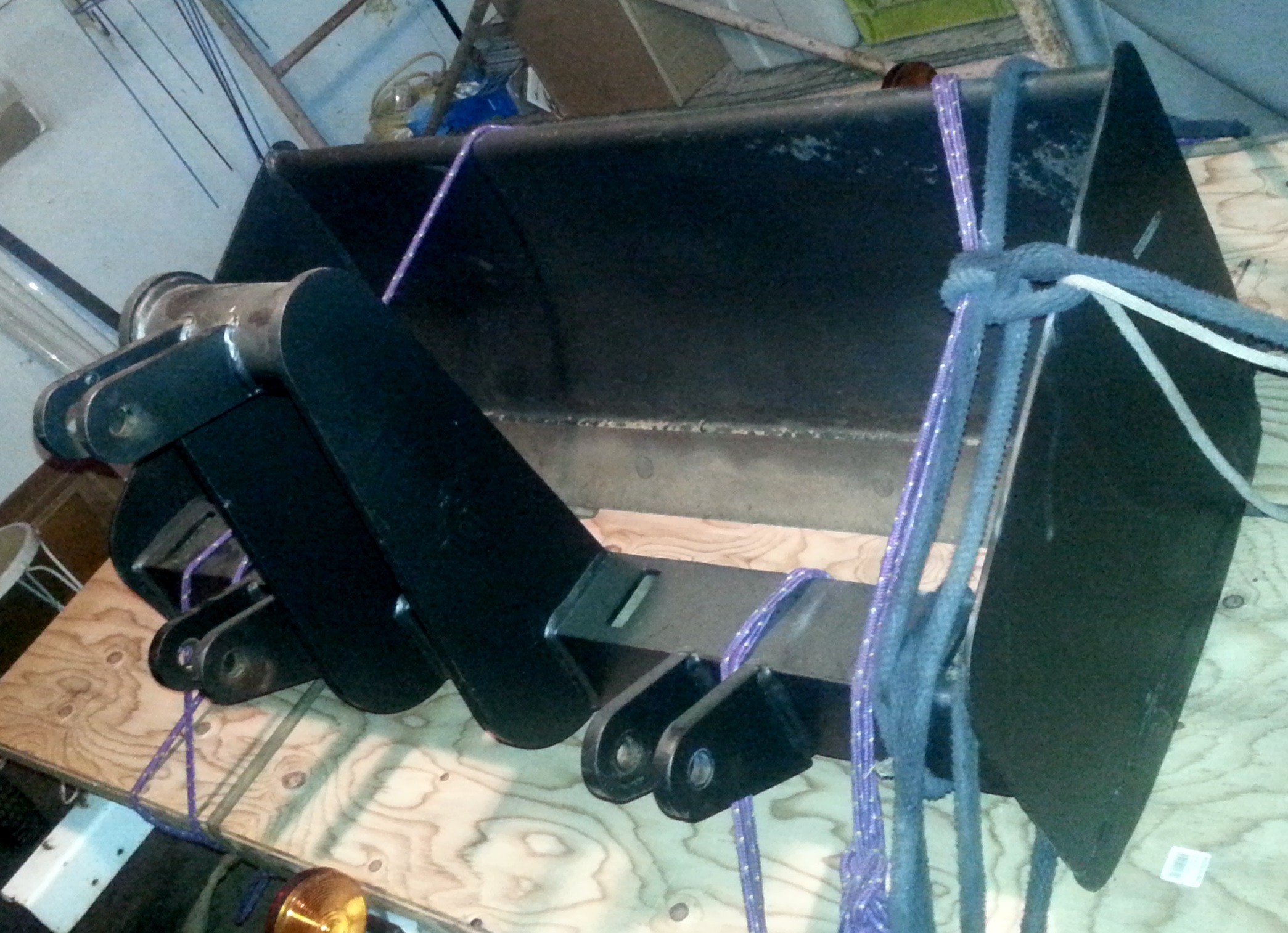

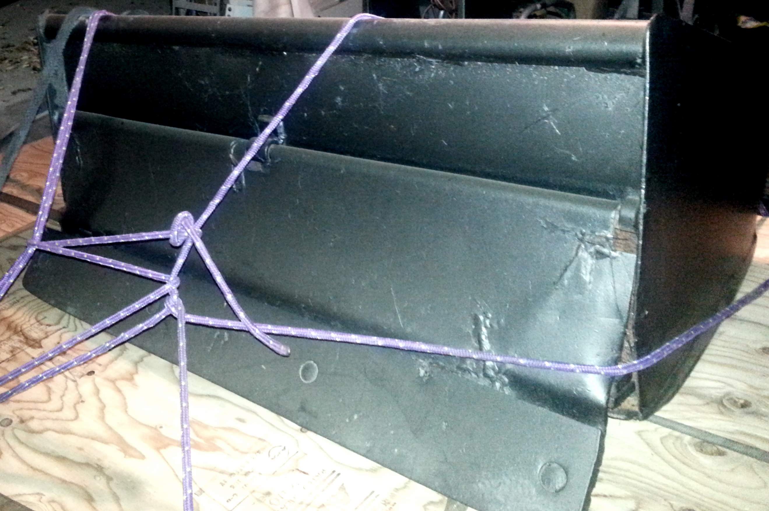

Here are some pics of the 4' Box Scraper. The guy called it a Gannon but I don't know the difference, perhaps its the brand?
   / YM240 New Owner #8

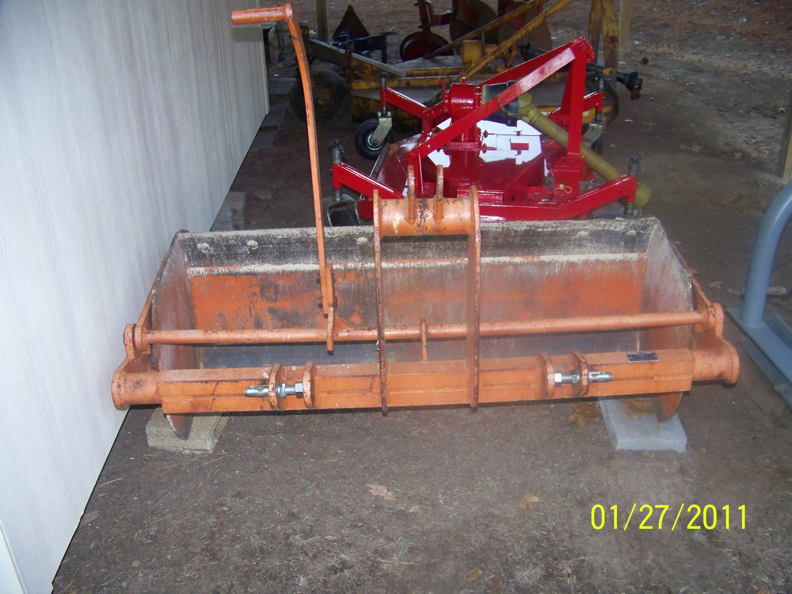

I think Gannon is manufactured by Woods. I have a 54" Gannon rotating box blade. Rotates 3 different positions, forward, backwards and scarfiers.
   / YM240 New Owner #9
ouch the teeth and pins will cost you another $80-100 i guess!!! Why do people take those out? You can pin them in upside down if you dont want to use them??? That way you dont loose them!
   / YM240 New Owner #10
The YM240 won't pull it with scarrifier teeth in the ground, unless soil is already tilled.
