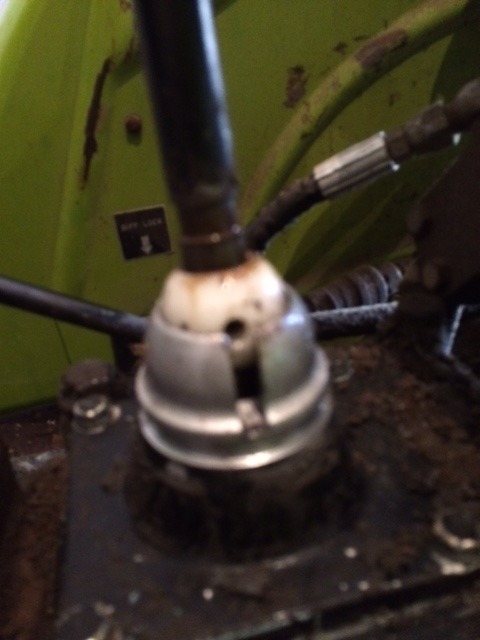

That circlip looks like it holds the ball down in the cup
So it can't pull out.

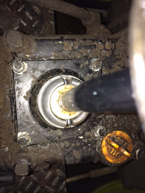

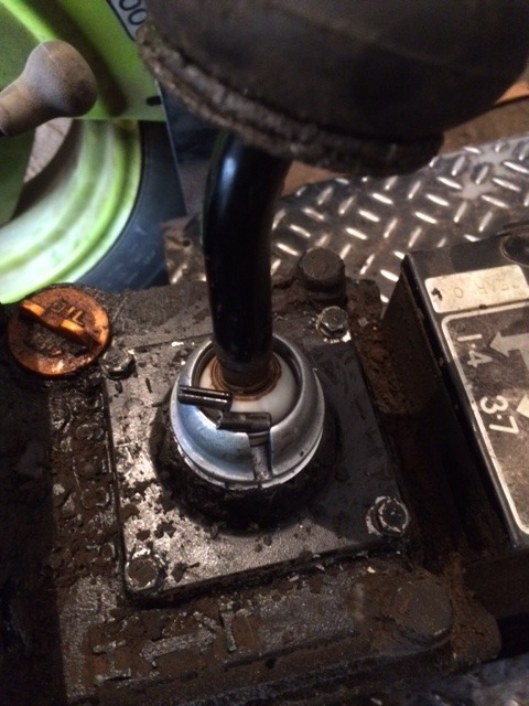

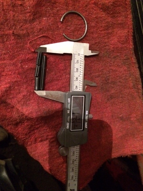

I'm not sure if the clip held it too far down or not, I think it could have been done w/ the clip in but it was pretty easy w/ it out as I could pull it up higher. Clip was kind of a pain to remove but not horrible. Anyway, here's a few pictures in case anyone else has this problem - it's about the easiest fix I've made and I'm far from being especially handy. The pin I found is a 3/16" x 1 1/2", $0.35 at the hardware store. As you can see the original may have been a touch longer but it's hard to tell exactly, it was the same diameter anyway. It could probably be 1/8 - 1/4" longer and not hurt anything though.
So when I popped the boot off it was quite obvious it was the pin, had to maneuver the ball to drive the 3rd piece out. Replacing it was about 30sec. Just make sure the ends are in the notches so it can't turn - that's why it could be a touch longer, as you can see there's still room in the slot on each side.

Very easy, and even better, CHEAP! Putting the pin back in and everything back together was less than 5min - taking it apart was probably 20min but most of that was trying to get the clip maneuvered around to get it out...which again may or may not have been necessary but I will say the ball didn't want to turn as easy to expose the hole w/ the clip in there since my pin was in 3 pieces and had rotated around but it could probably be done. Thanks again for the help everyone!
