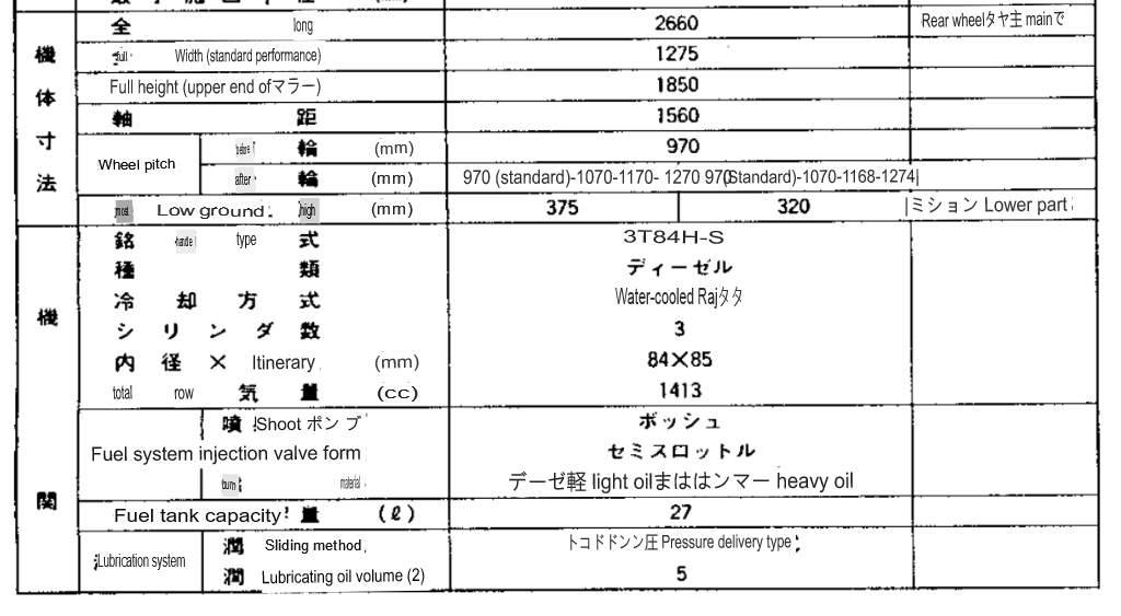

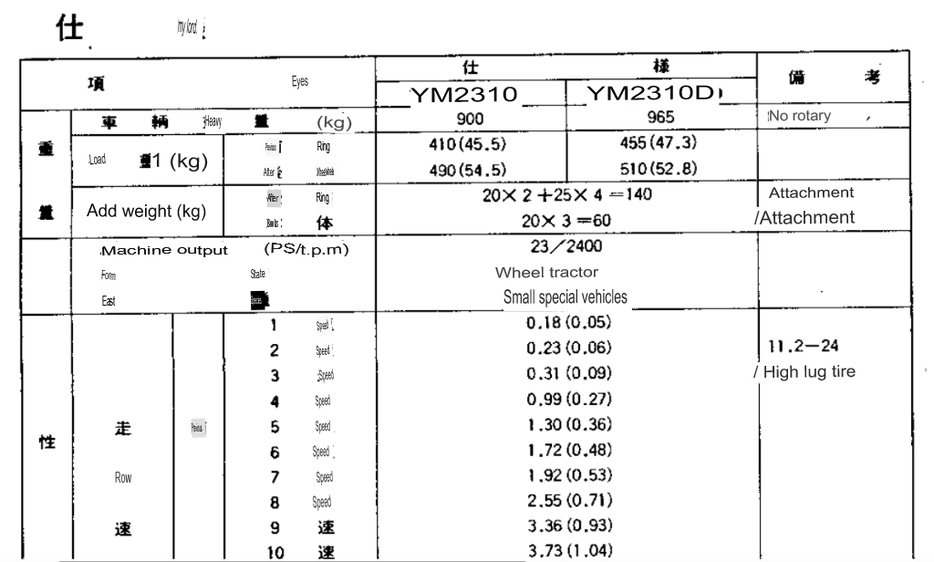

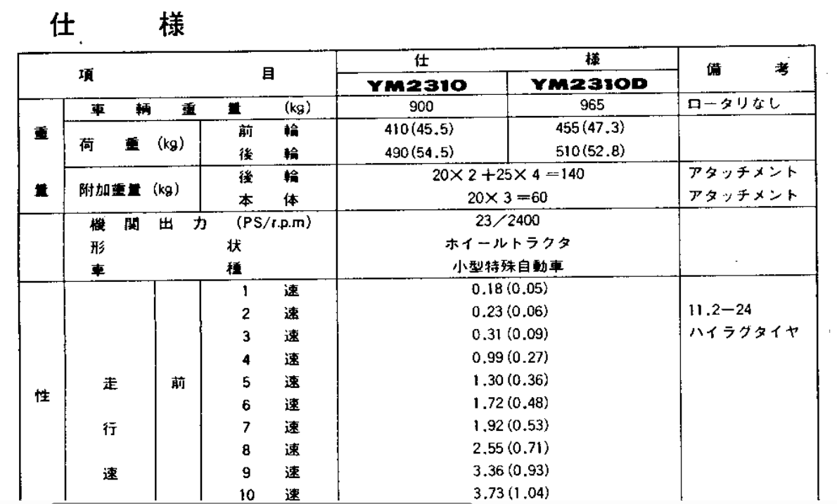

IF you zoom in even more and try the translator, the results are better.

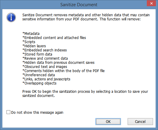

The manuals are all at the Yanmar Tractor Owners Group.
Even PDF files can hold malware or scripts. Each and every PDF on the YTOG site is purged clean via,
As for the other link, I can not vouch for it at all.
