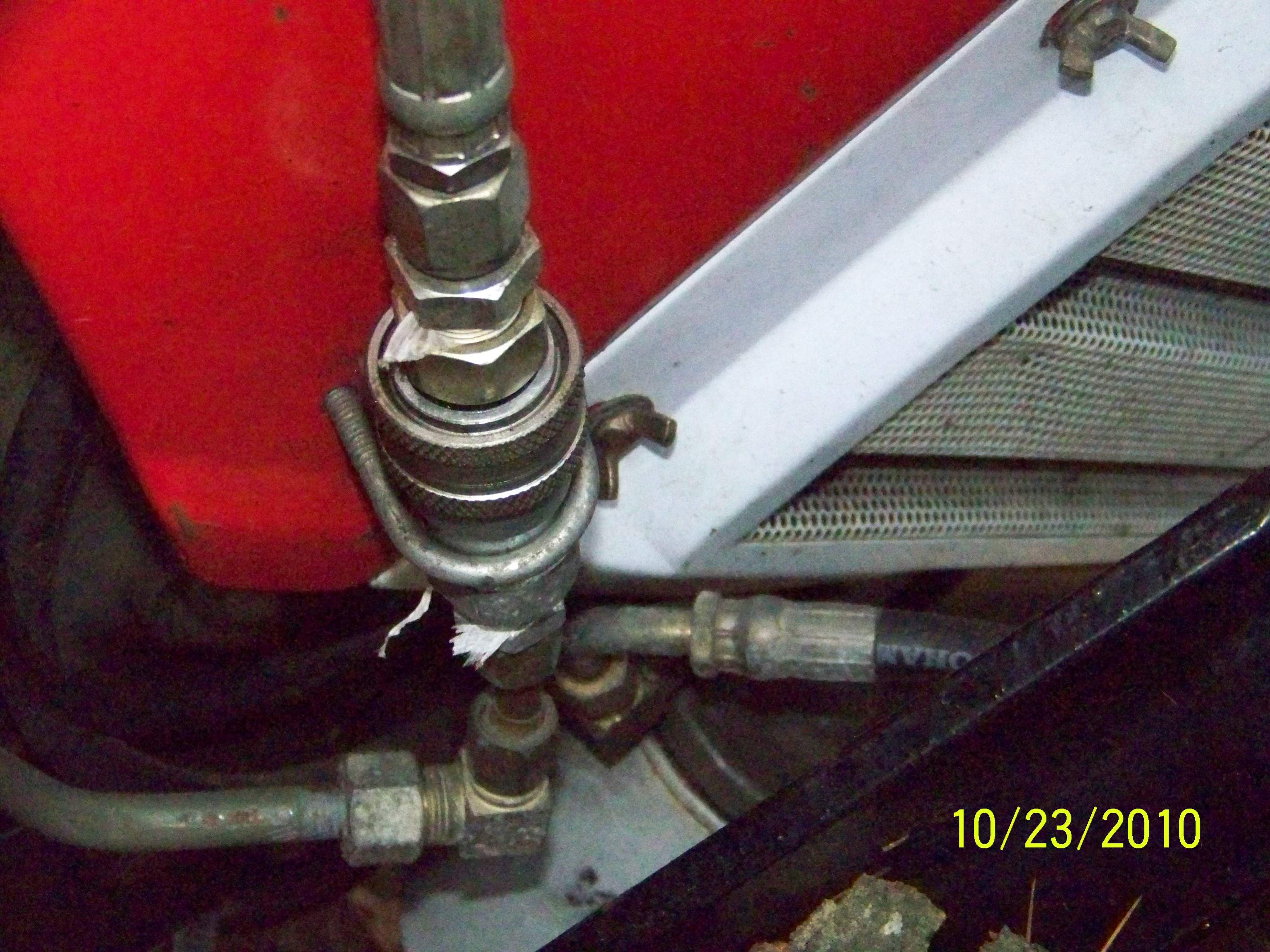

Spare time has been short for getting the mounts completed. The front and center are done and all that remains is the rear.
I have seen the plumbing diagrams for tying into the hydraulics by splitting the pressure line to the 3-point. I was wondering if anyone has plumbed theirs this way and also runs their tractor without the FEL sometimes. Do you just plug your quick connects together when the FEL is not mounted?
Thanks,
Steve
   / YM2210D FEL Mount #5
That is exactly what I do. I have quick disconnects there.

I didn't plumb mine that way. I came that way from LCI. Many many many vn tractors are plumbed that way. All I did was add the quick disconnects and hoses for easy loader removal. I am pretty sure the gurus of hydraulics will say you need a power beyond port and go from it to the 3 point. All I know for sure is mine works fine. :thumbsup:
   / YM2210D FEL Mount #9
I stated that some (maybe I should have said many) will work this way. Mine must be the only one that wouldn't . I can now have the 3 pt in the all the way up position & the curl, & float function of the bucket works as it should. Which ever way works . Go for it:thumbsup:

The mounts are all complete and the FEL installed. I cut into the 3 point line for the hydraulics since my control valve has power beyond. Both the FEL and 3 point work fine this way. I have .jpg pictures but I need some help getting them under the max file size. How do you compress the files to fit? I used MS picture Manager but the files are still too big.
