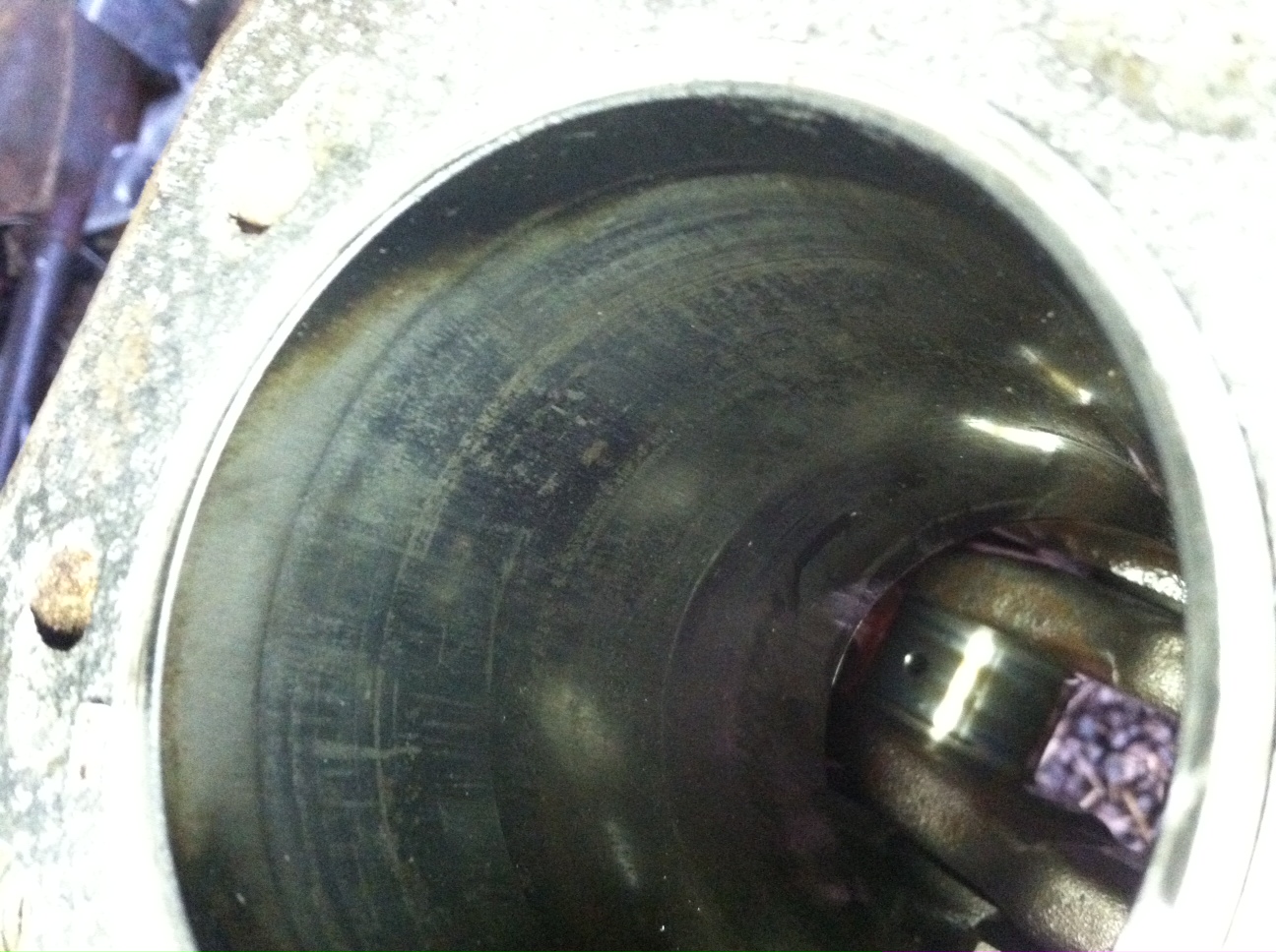

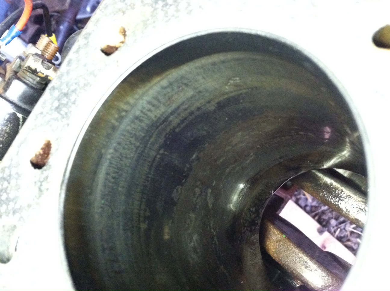

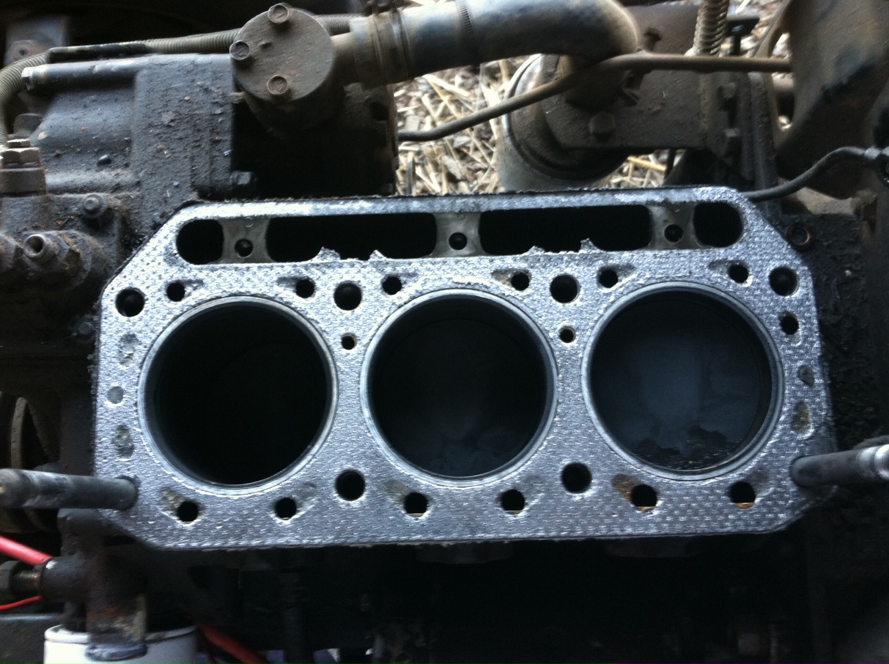

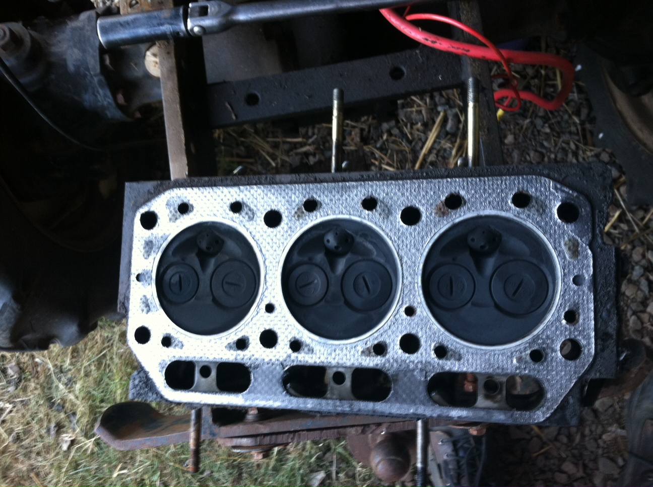

My wife and I just a baby so I've been unable to work on the tractor. I started the dis-assembly and so far it looks better then I would have thought. Or at least the gasket was in good shape. Should I do anything to the head or just clean it and continue? I was considering Lapping the valves and putting new seals on and also maybe taking it to a cylinder head shop to be checked over.
I'm expecting then that my problems came from the bottom half, I think my pistons will have broken ring journals when I get them out tonight.
One question though, Can Hone first and then take my measurements in the cylinders? or do I need to measure first?
   / Ym220 with low compression #5
You can measure before or after. You are not wanting to hone enough to remove metal. Just enough to put cross hatching on the liners. Can't tell much from your picture. Do you have a ridge at the top of the liner that you can hang a finger nail on?
If it were mine I would give the valves and seats a good inspection keeping them in order, use a straight edge on the head to make sure it is not warped, and install new valve stem seals. If all looks good I wouldn't take it to the shop. I am a cheapskate and sort of trust my judgement on head condition. So you will have to determine what would be good for you.

The cylinders do have a very slight ridge at the tops, I can't tell yet if its the metal or just carbon build up, thus the honing question. I will try a gentle cleaning and check for the ridge with better light this evening.

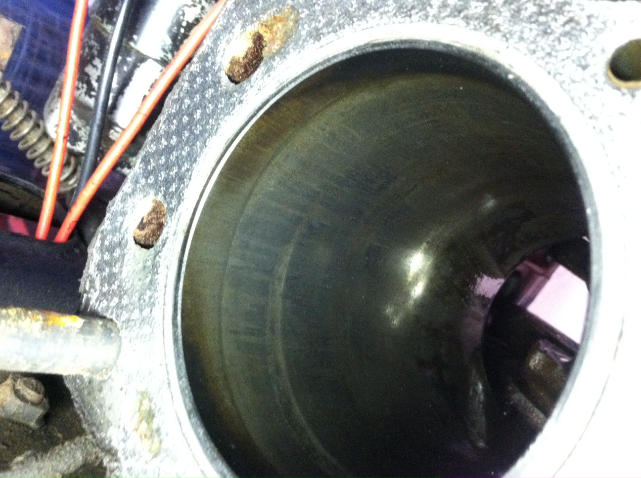

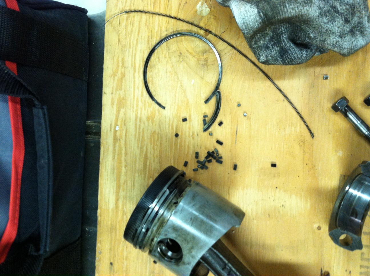

Okay so this morning before work I got the pistons out. #2 was in pieces and the cylinder wall is equally as bad
Pistons 1 and 3 looked fine with the slightest of burnished edges on the rings and bearings (will replace anyways)
But the cylinder walls look rough, Should I even bother measuring them? or just spend the extra $$ to replace?
They all have a slight ware ridge at the top, very slight though, its hard to feel but I can see it with a light from underneath.

Replacement of the liners would be great, but at nearly $90 ea you may have to look for a new wife. :D
No doubt, even going as conservative as possible you are going to end up with a pretty good total. If you fix it right now it should last your lifetime if taken care of. Makes me wonder if someone has used ether in starting with the broken piston lands.
I don't know if you have a manual or not. I can help you with tolerances and so on if you need.
