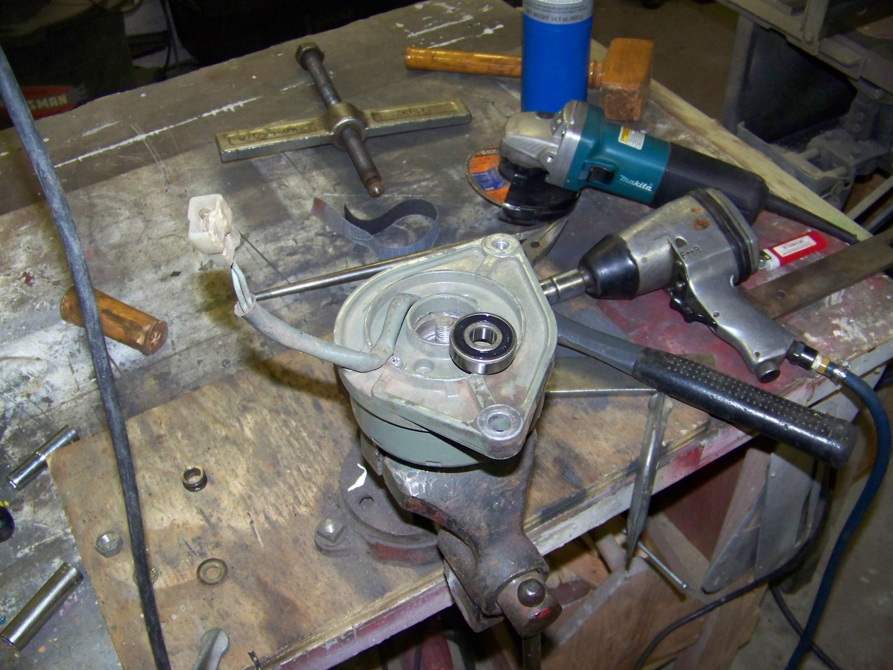

One of the bearings on my little dynamo locked up today. It uses two 6201 2RS double seal bearings. Had to cut the inner one with a dremel tool. I didn't have a puller small enough to get under it. After cleanup everything went back together smoothly. Both bearings were $7.74 including tax. Pretty cheap repair. The kind I like. I guess not bad after 30 years. I doubt they have been changed before.

Are you working in my shed? You appear to have my Rattle Gun and Angle Grinder....:laughing:
   / YM2002D dynamo bearings
They have been good ones. Cheap little impact is about worn out. Never heard the term "rattle gun" before.
   / YM2002D dynamo bearings #4
It's good to know these are so easily rebuildable! Great writeup!
   / YM2002D dynamo bearings #5
Yeah 15-16 bucks in repairs after 30 years is a lot of bang for the buck she looks good! :thumbsup:
   / YM2002D dynamo bearings #6
Impact Wrench or Gun would be it, we Aussies call them Rattle Guns also, you "Rattle" the bolts loose. nice work on the Dynamo also :D
