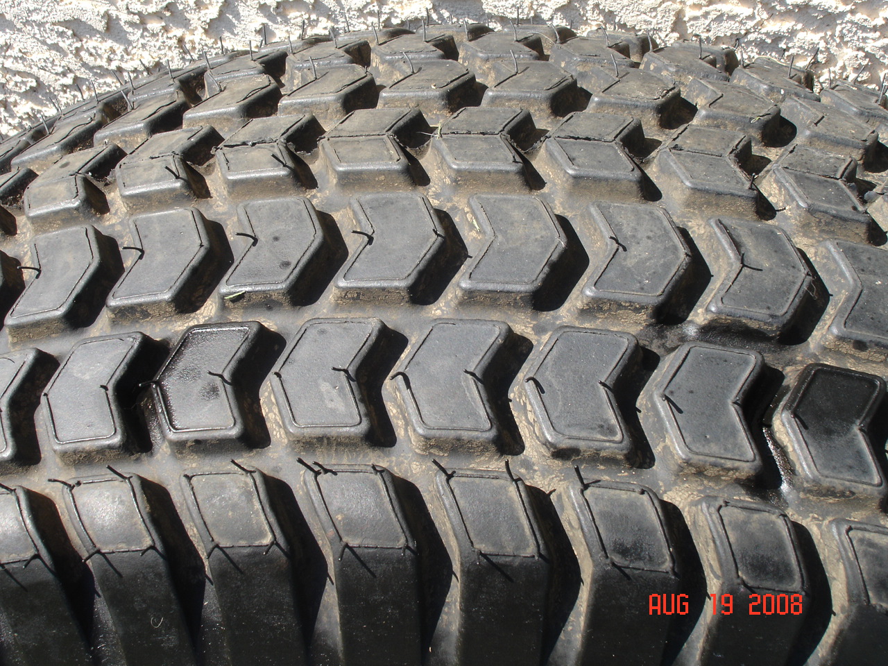

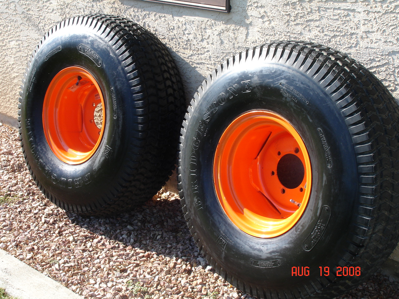

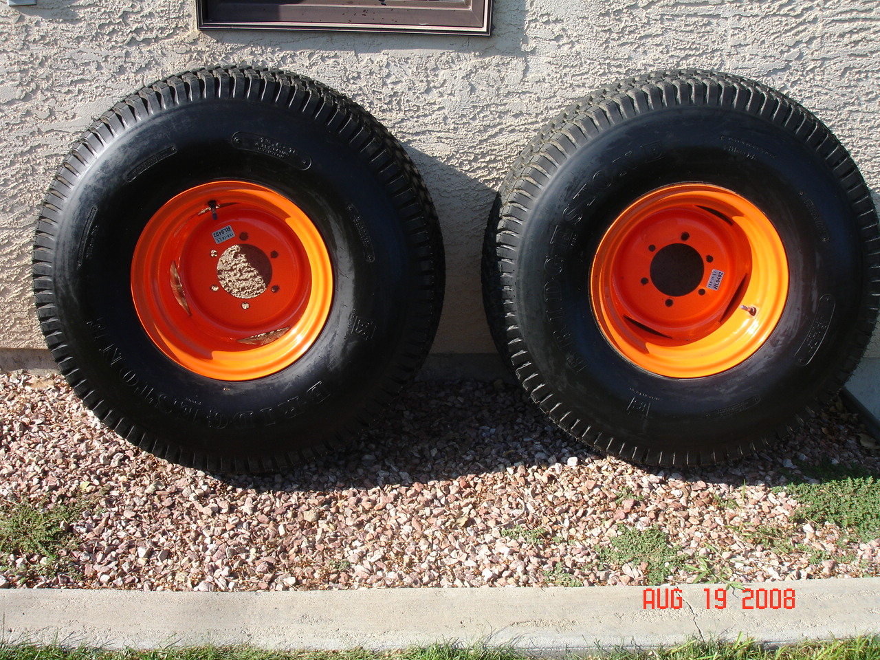

Are you looking for tires and 6-lug wheels like these? If you were in CO I would consider selling them to you. Really don't want to mess with shipping tho, right now I don't even have a pickup to take them into town :( Otherwise.........

Funny you should post those exact tires and wheels! I just picked up a set of used kubota tires (same exact ones actually) from a local dealer that were used - but last night I tested - bolt pattern is off. The Yanmar YM2002 takes a 6 bolt at 5 1/2 " spacing, and the kubota 6 bolt was 5 7/8" with a larger center hole also.
I Checked with my truck, and the Chevy 6 bolt rims are 5 1/2" spacing - off to the local tire dealer to find some off road tires for me.
Thanks for the input everyone.
/ ym2002 - need turf or diamond tires #6
Yah, you may have to re-drill the holes offset from the original, make an adapter plate from one to the other, cut out and reweld centers from the Chevy wheels to the Kubota, or I guess you could just open up the existing holes. Sounds like you have a handle on it though. I guess if someone can adapt Kubota wheels to a farmall Cub (see attached, not mine, wish it were) then they could be adapted to anything. Glad you found your wheels.
