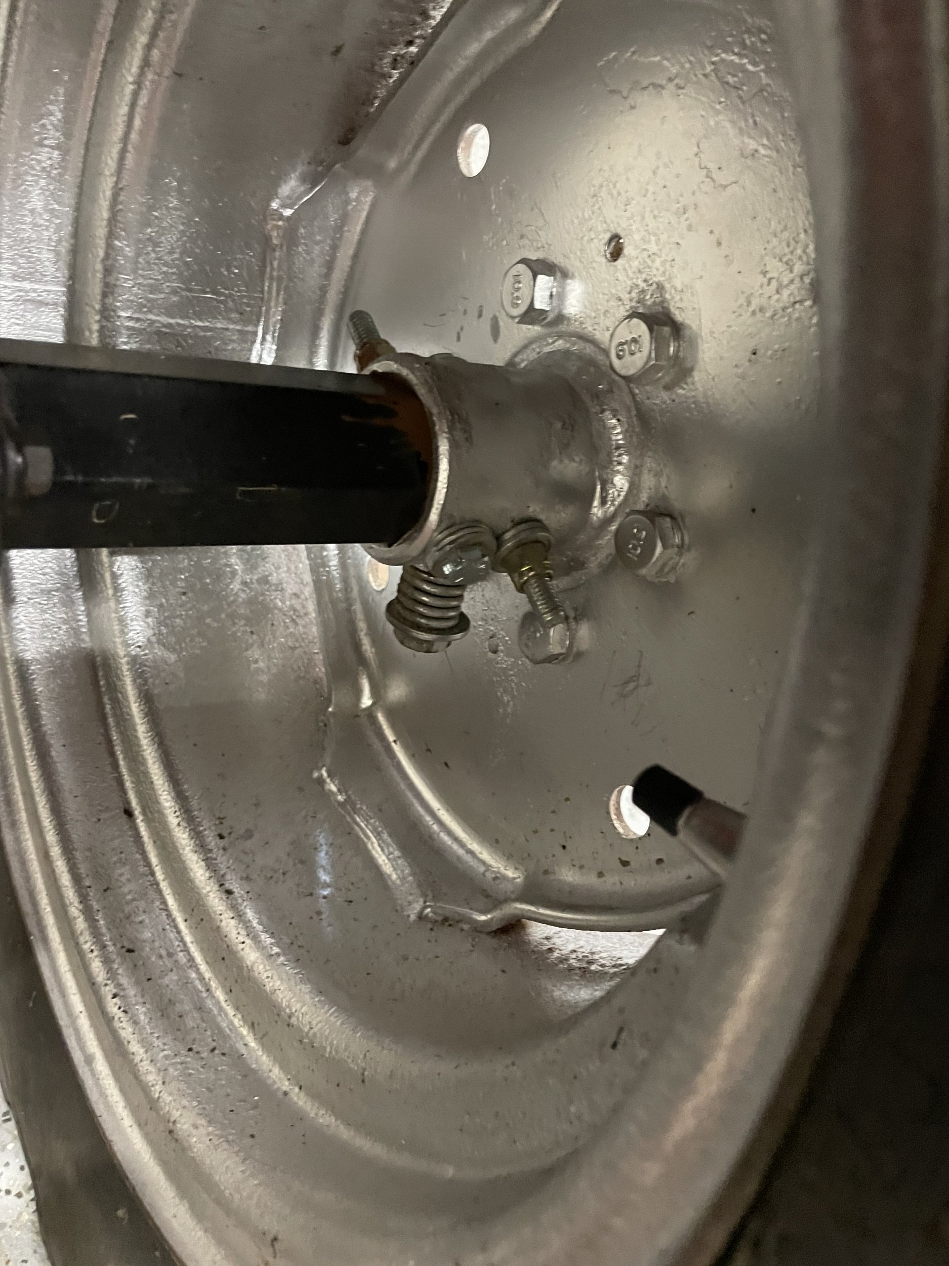

"Bolts" removed from hub. The rims are installed on the INSIDE face of the hub. Once I get the hubs off the rims, I plan to mount them more traditionally on the outside.

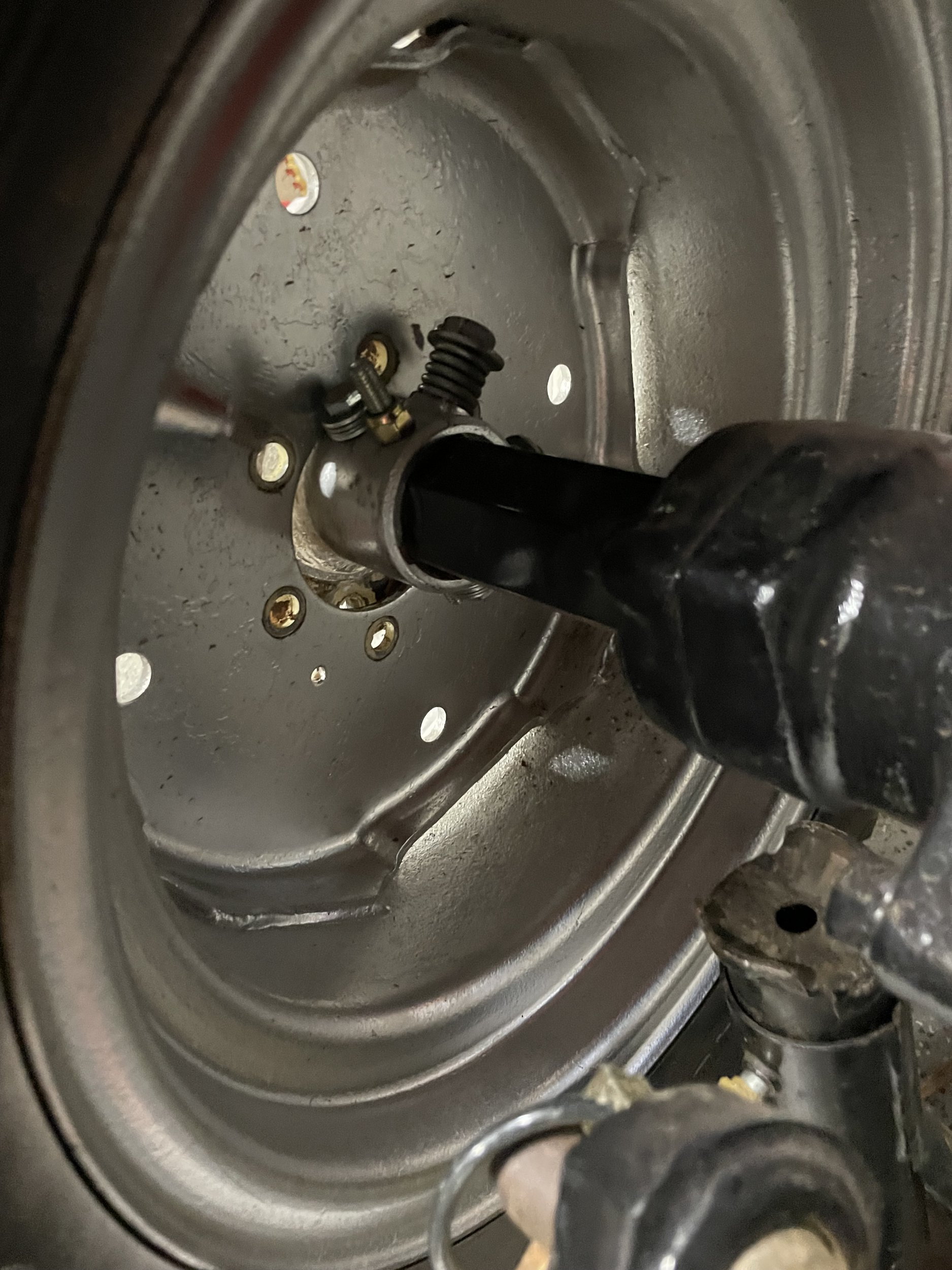

Inside view....I will probably have to remove all the hardware to get the hub off the rim. Plan to paint these white as this color will be on the outside once flipped.
Inside view of the other hub before removing any bolts.

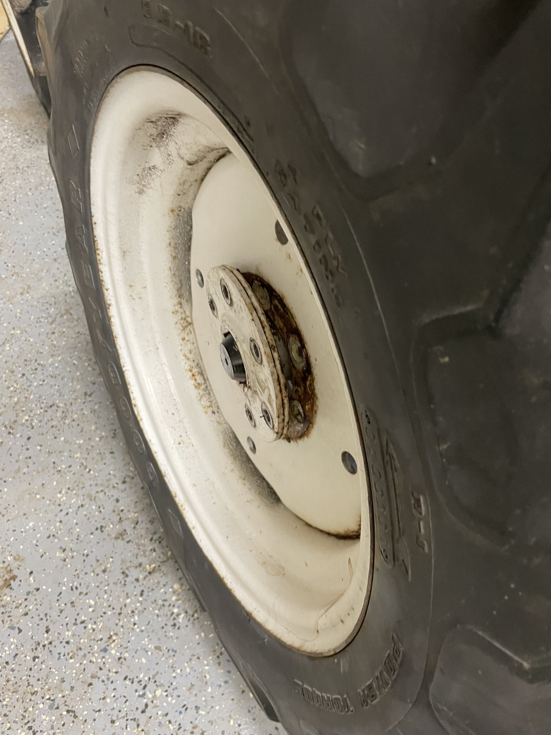

Outside view of the other hub before removing any bolts.

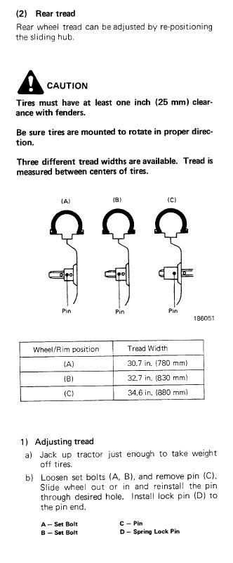

I don't see why that would not work but it is interesting that the YM186 manual does not mention flipping the hubs around or flipping the wheels around. It just says there are 3 different possible widths. Seems to me like there are a lot more options than that.
/ YM186D Wheel flip and hub adjustment #3
That manual is strange. CPY's and my YM186D wheels have the valve stem on the dished side of the wheel. All three of the manual's suggested positions put the valve stem inconveniently on the inner side of the wheel.
But those diagrams all put the center of the tread inboard from the tip of the axle.
I'm running maximum width, with the rims beyond the end of the hubs (like the diagrams) but dished side out which puts the center of the tread well beyond the axle tips.
In my sloping orchard with no ROPS I want maximum rollover resistance, perhaps at the expense of shorter life for the axle bearings and seals. It's strange that the manual doesn't show or discuss this, when dish-out is the only way to have the valve stems accessible.

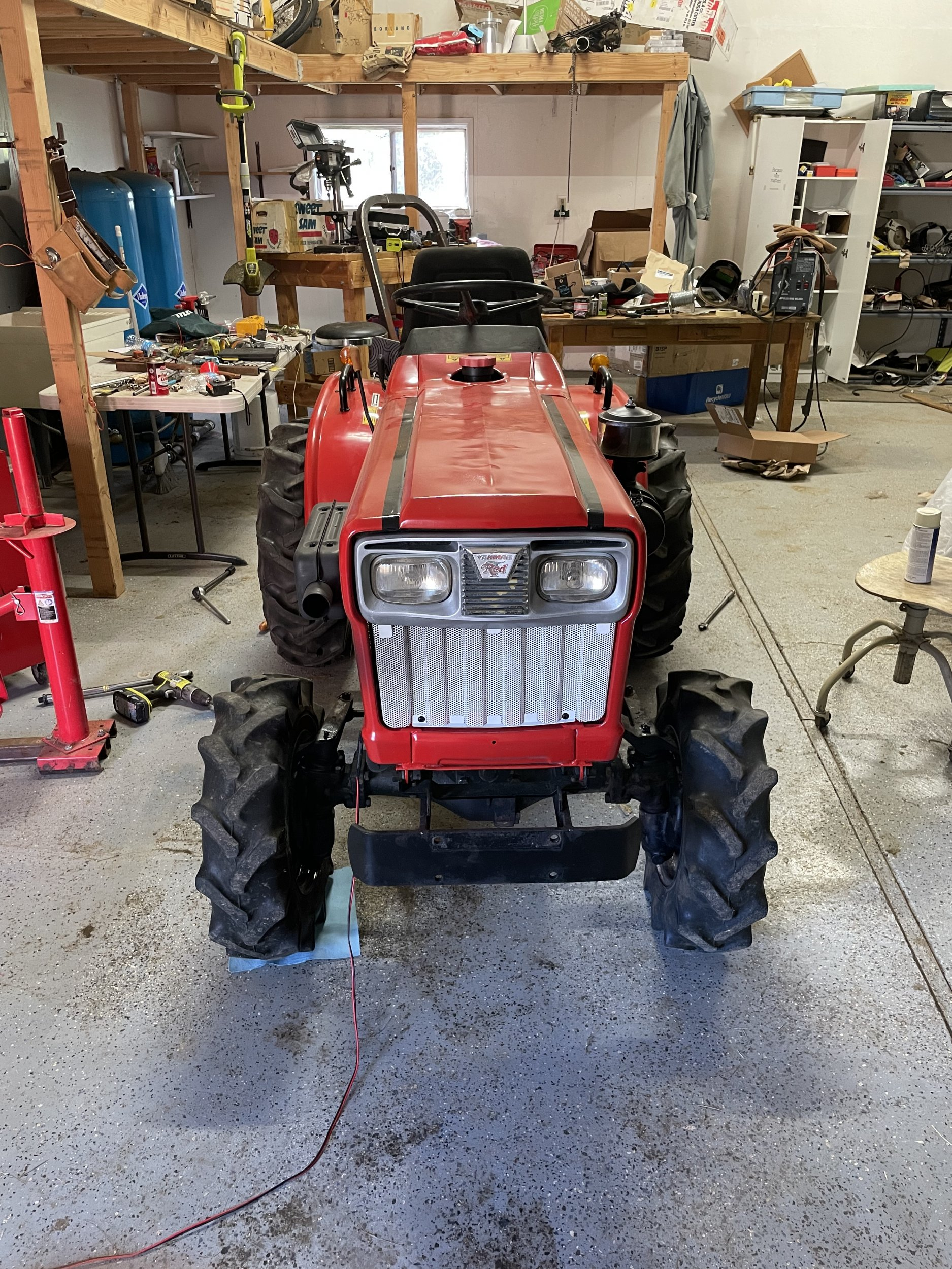

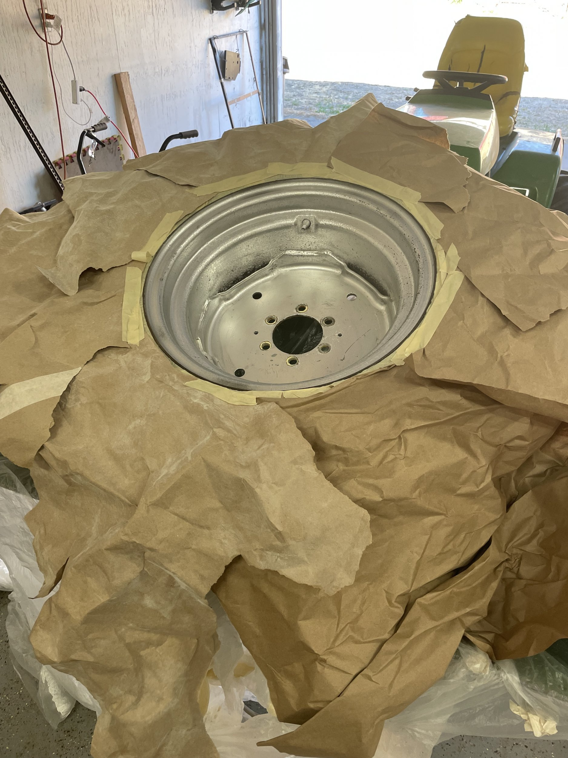

I got around to flipping the hubs and wheels. The inside of the dishes were just primed grey, so I painted them Yanmar Off-white color. Now the rim mounts to the outside of the hubs with the dish side out. Still waiting for paint to dry and take for a test drive. Even though the manual does not indicate NOT to do this...I am not seeing any safety reasons why it would be a problem.
The rear tire overall width is now increased a lot, hopefully giving some stability on some of the slopes in our front pasture of about 10° to 13°.
